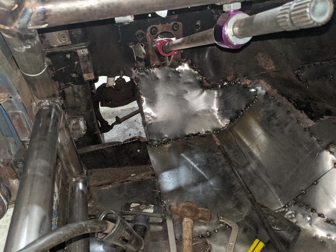

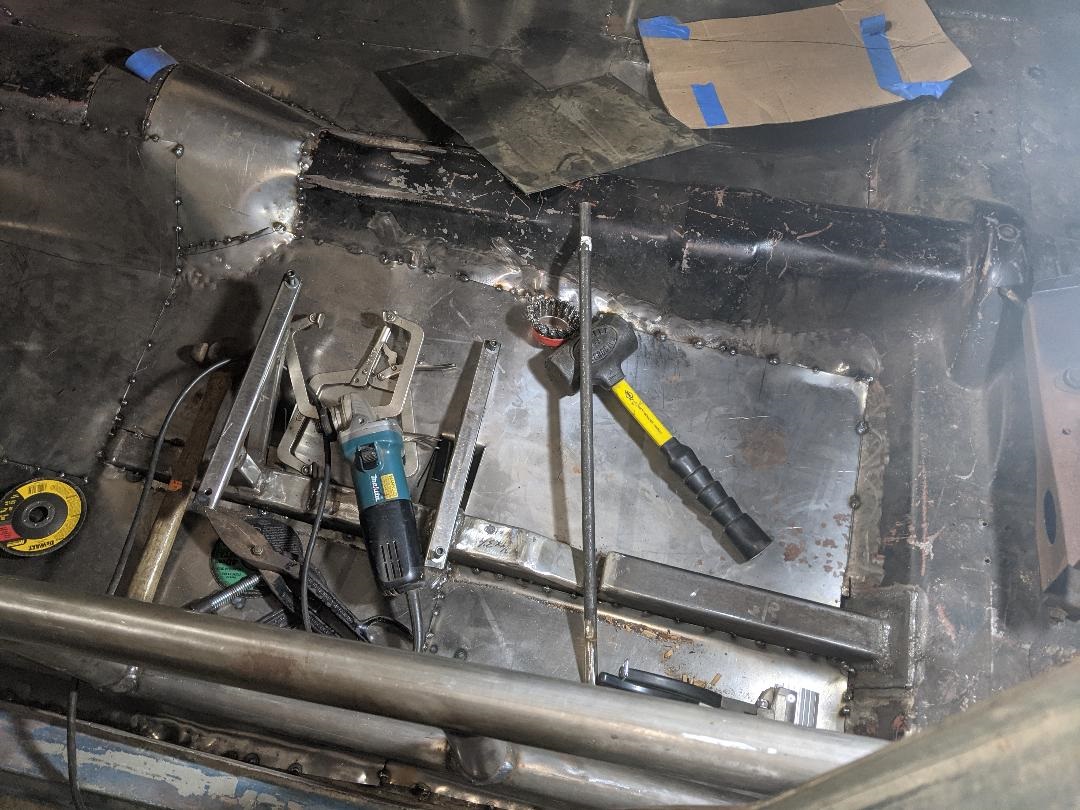

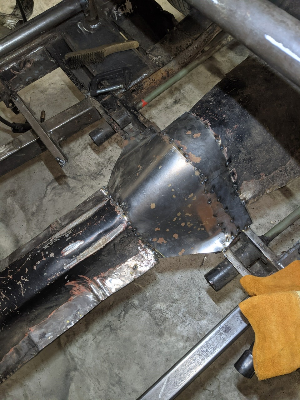

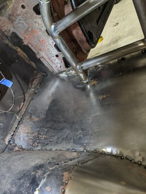

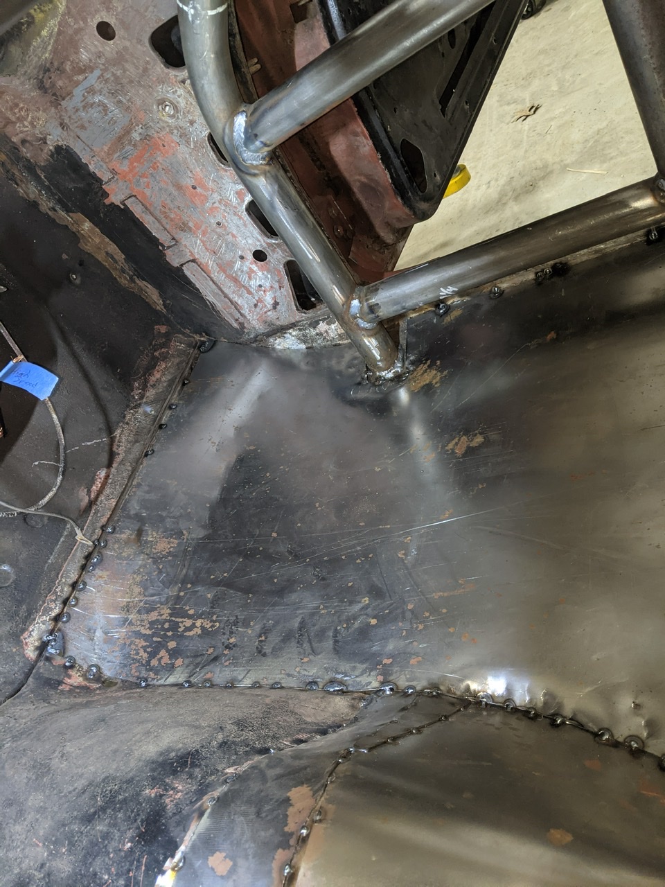

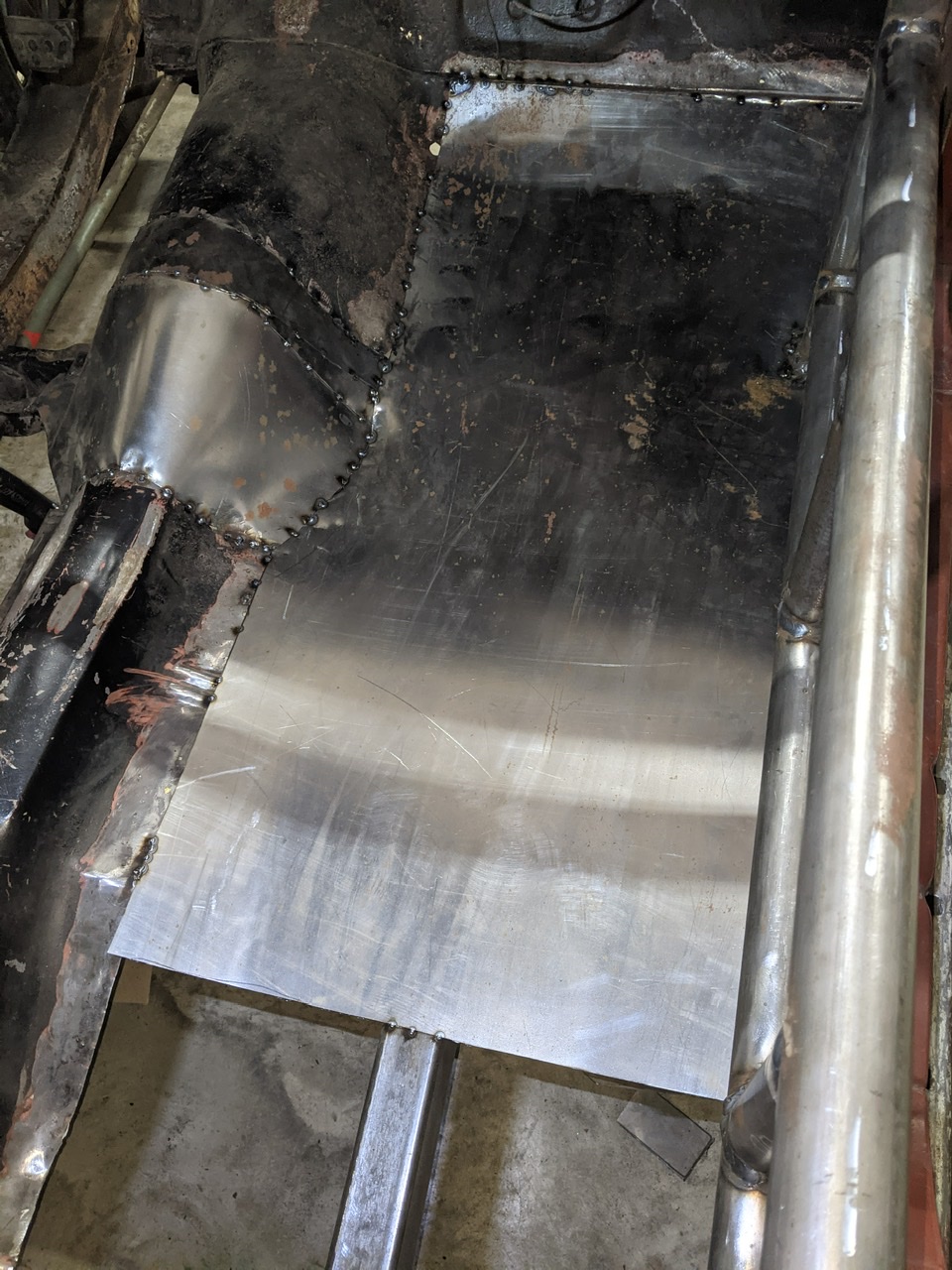

PostPosted: Thu Jan 21, 2021 6:18 am
Adam has made more progress on the driver floorboard.
I ordered the fuel cell, longer wheel studs and brake proportioning valve.
Joe and I are brewing up some engine ideas...

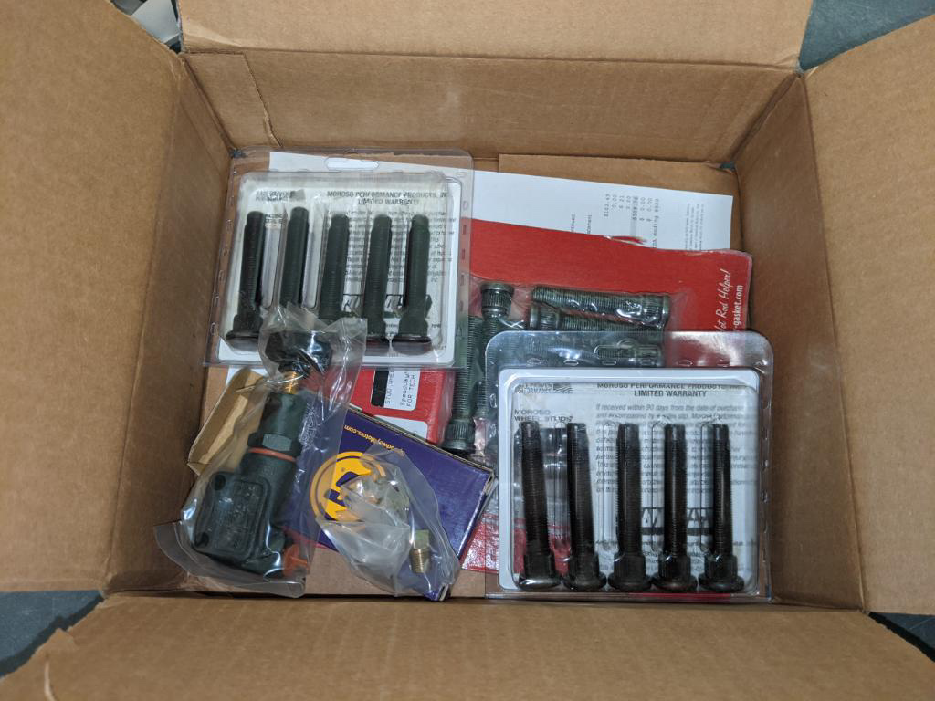

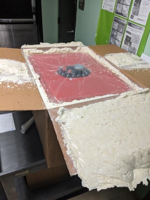

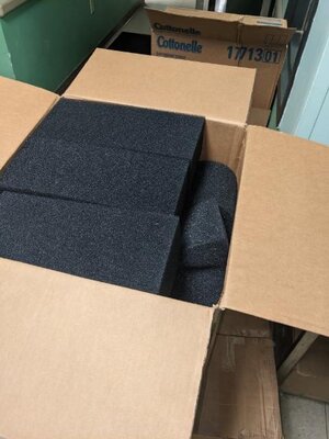

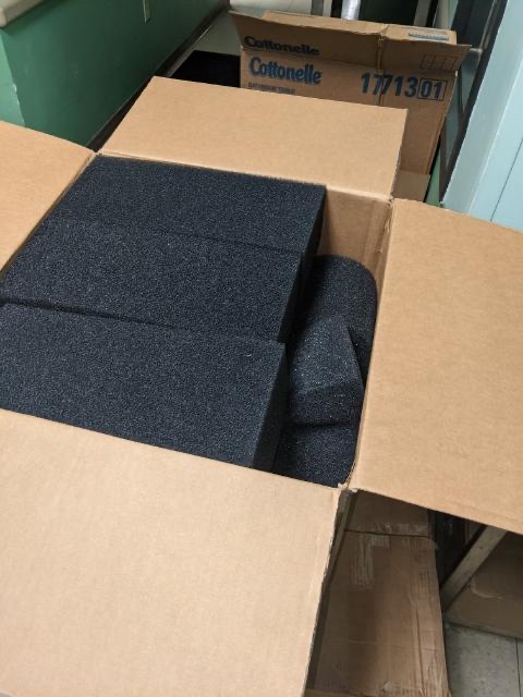

Pieces & parts...
PostPosted: Wed Jan 27, 2021 6:18 pm
What's the top picture?
PostPosted: Wed Jan 27, 2021 7:21 pm
Red fuel cell in a bag surrounded by shipping foam.
PostPosted: Thu Jan 28, 2021 4:56 am
Posts: 10443
Joshua Nailed it.
He is keen at identifying partially unboxed racing car parts.
:D
PostPosted: Thu Jan 28, 2021 5:20 am
What they said. :lol:
It's an RCI 22 gallon steel fuel cell with a Polyethylene Bladder
I also got a bunch of these Fuel Cell Anti-Slosh Safety Foam Tank Baffle Inserts 14x4x6, 6/pk
It's the $350 option compared to the $1,000 FIA certified option.
It will pass tech with just a bit more scrutiny. Lots of teams run similar fuel cells.
We will build a cage around it, etc, etc.
(The Cottonelle in the background isn't for the race car... I don't think... :? :lol: )

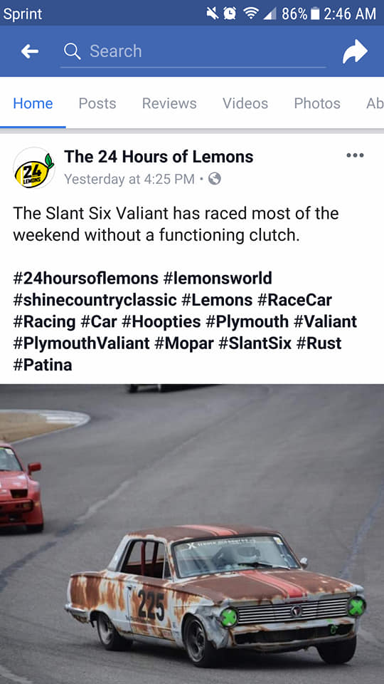

PostPosted: Thu Feb 04, 2021 8:22 am
The other cool benefit of winning IOE is you get a free team entry for another event! :D
I have to upload the photos I have to Image Shack to post.
Sooo,... It looks like I never did post those pics... :oops:

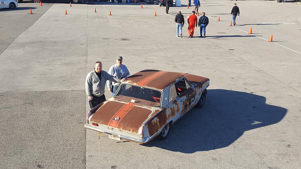

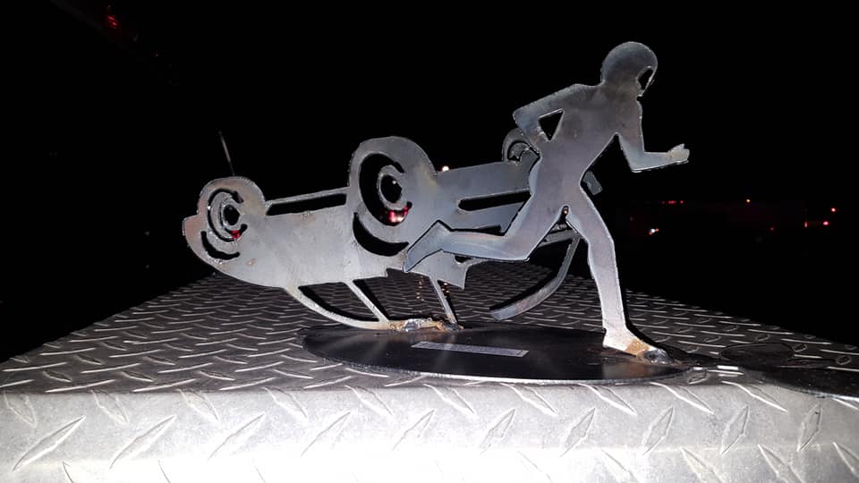

I found some while looking for other Slant 6 photos...

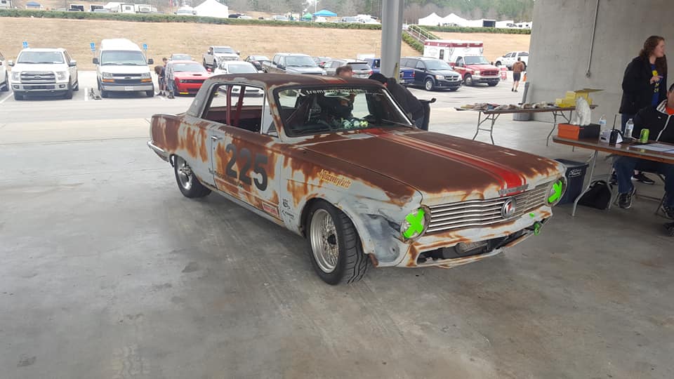

Here ya go. These are from the race at Barber a couple years ago when we won the Index of Effluency award because we drove the whole race with no clutch.
