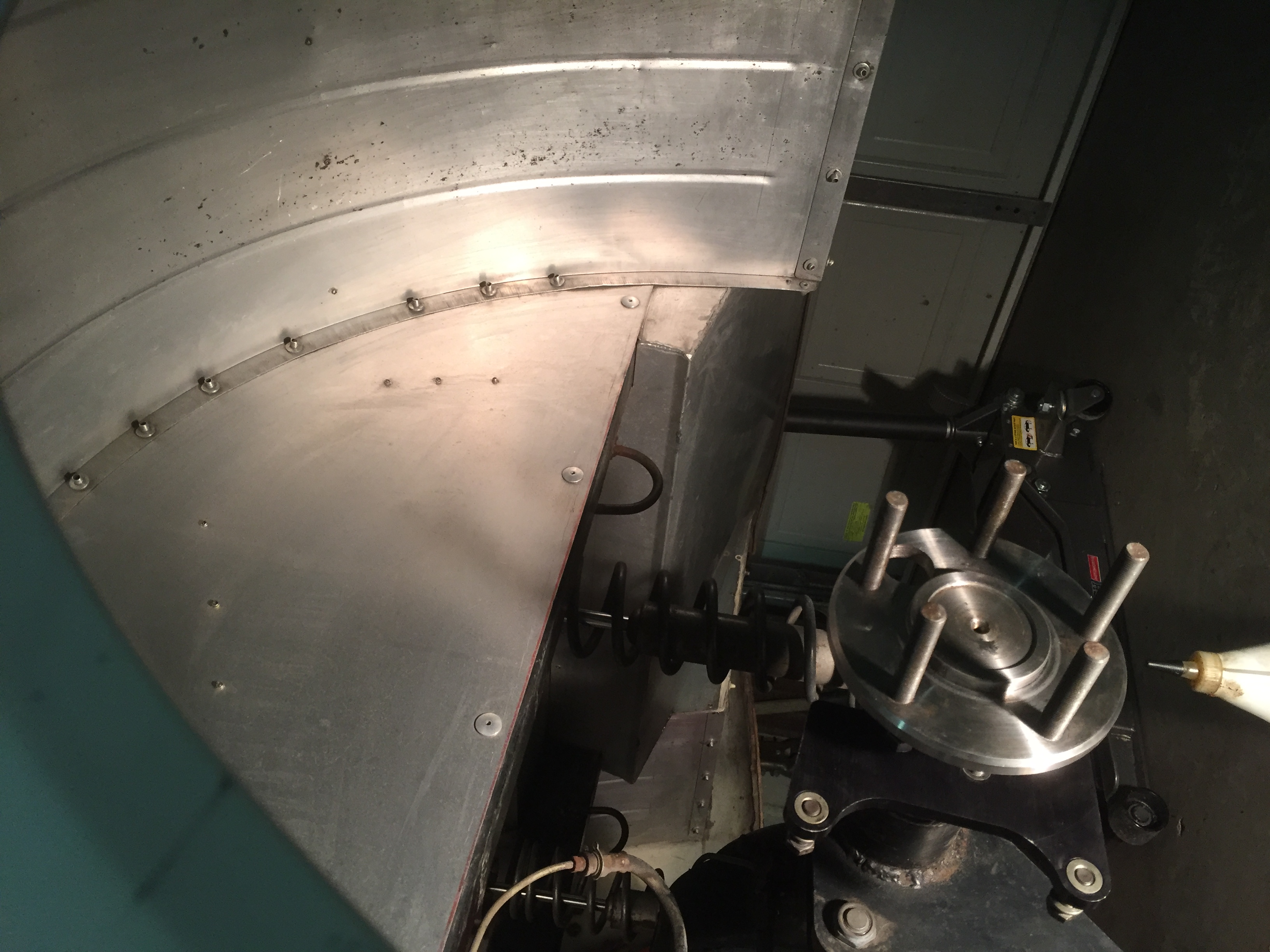

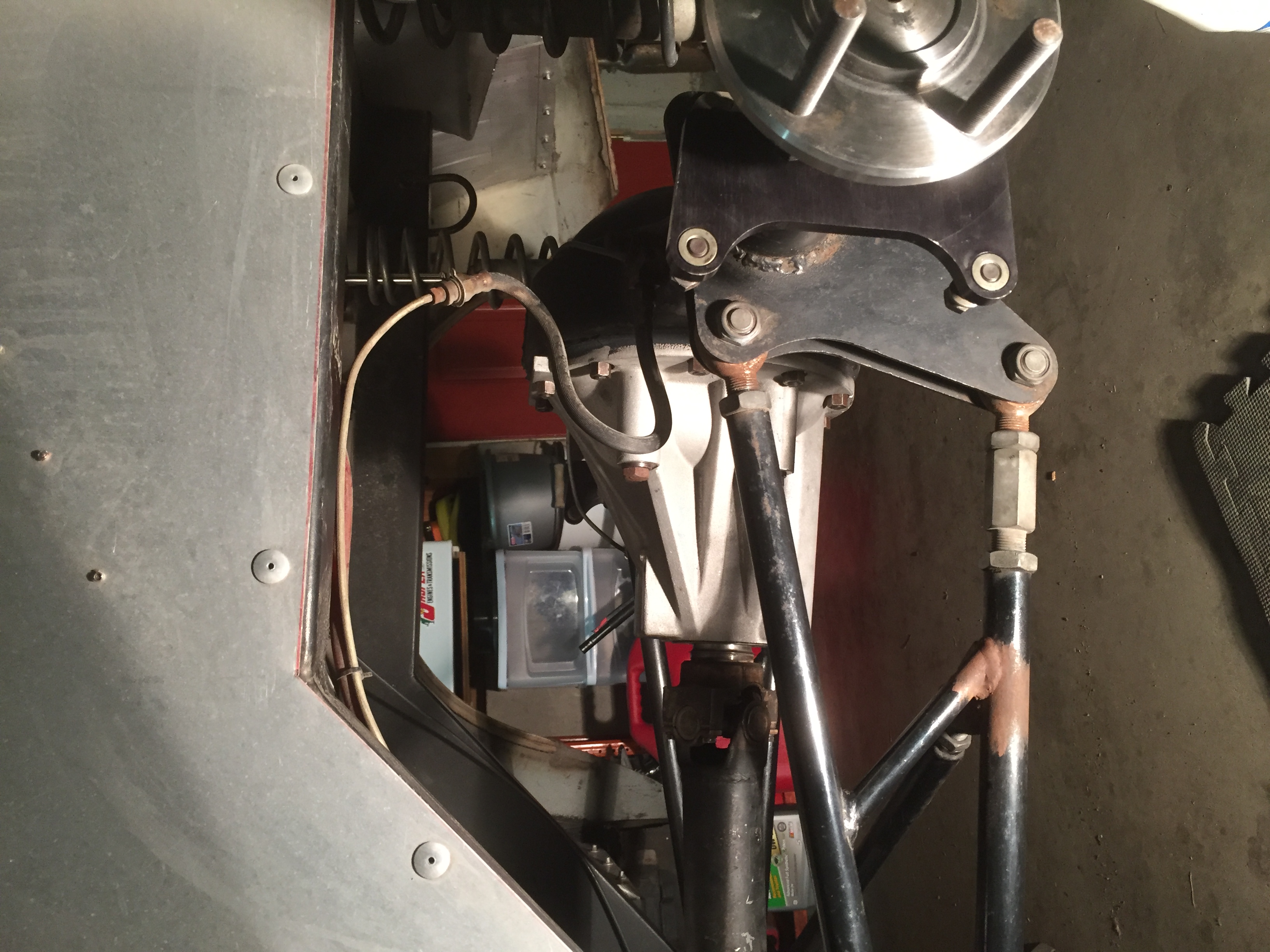

Well,... I did make some progress on the Challenger this weekend...
I got the rear end back together, but had to take the new axle back out. :(
Unfortunately, the rear wheels on the Challenger are 5X4.75” bolt pattern instead of my assumption that they were 5X4.5”. Who woulda thunk that this poor little “Identity Challenged” Dodge (Mitsubishi :roll: ) Challenger would be further hindered by having Chevy bolt pattern axles in it!? :shock: :?
I’ll look for a local machine shop that can hopefully just add the second bolt pattern. More to follow on that one. Here is the side that will stay in. New bearing and seal. The center section also has a new pinion seal. The “before” pic shows several years of accumulated rubber. I weighed it and estimate I got about 3 pounds out of there. :shock:
Every few minutes I make a little progress. Granted, it is only “Poser Progress”, but it keeps me entertained.

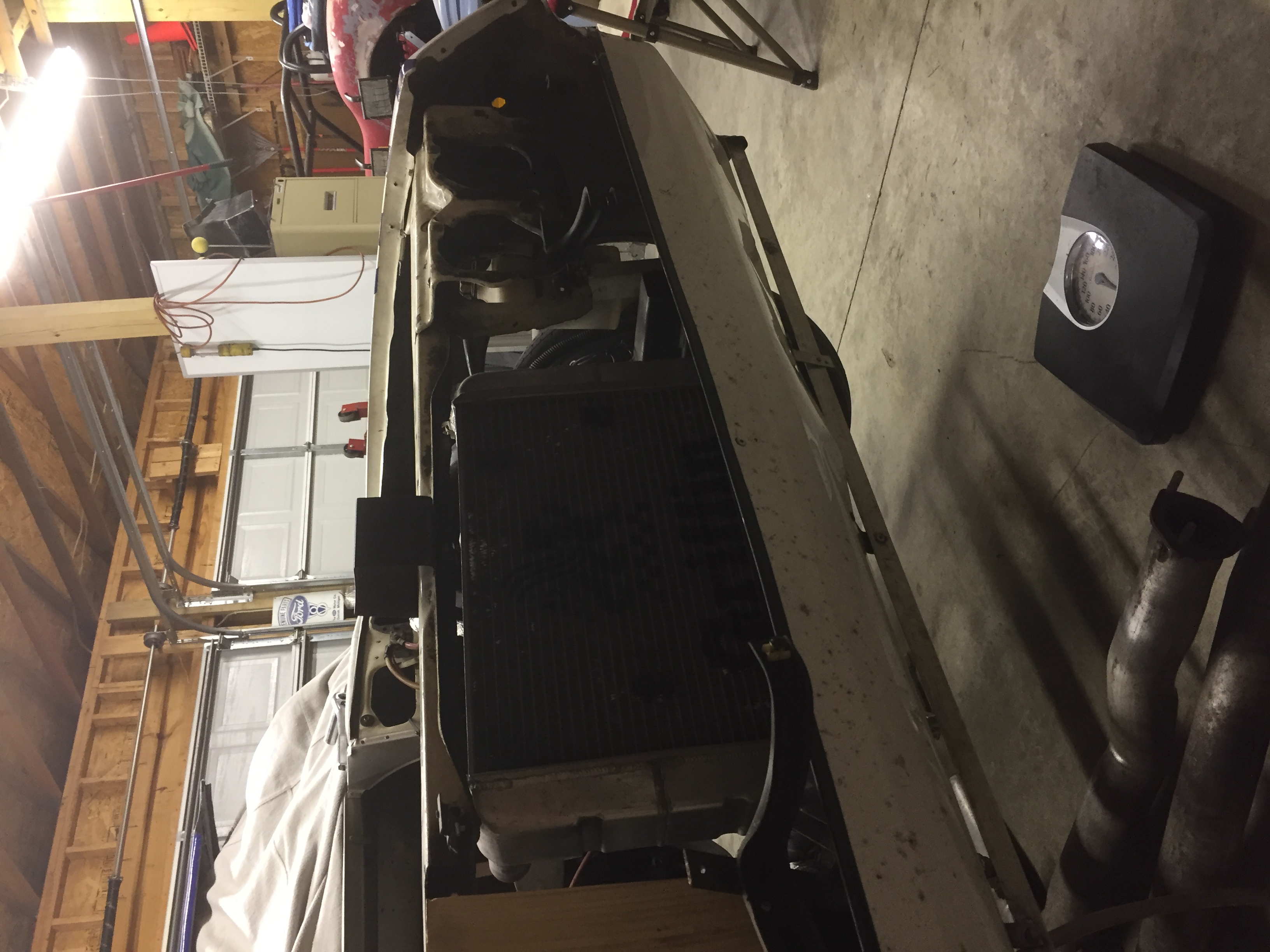

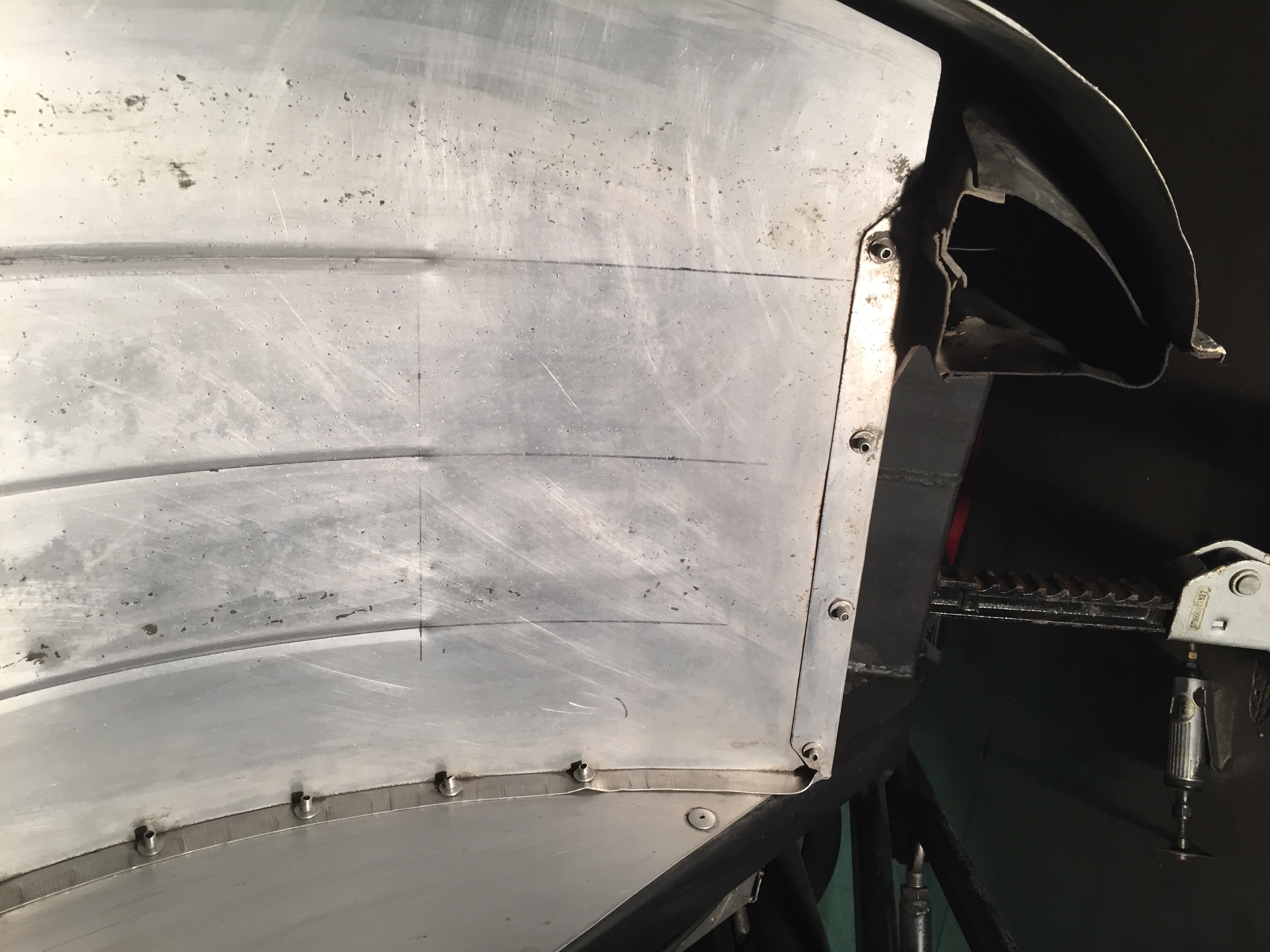

While I still had some time to fiddle I started looking at how I can re-mount the alcohol fuel cell and replace the grill with something better that will seal off the front of the car and offer better aerodynamics. There is also some decent weight savings to be had by removing the grill, brackets and what’s left of the radiator support. I can easily replace the support with lightweight aluminum tube. It only mounts the front of the fenders and grille at this point.

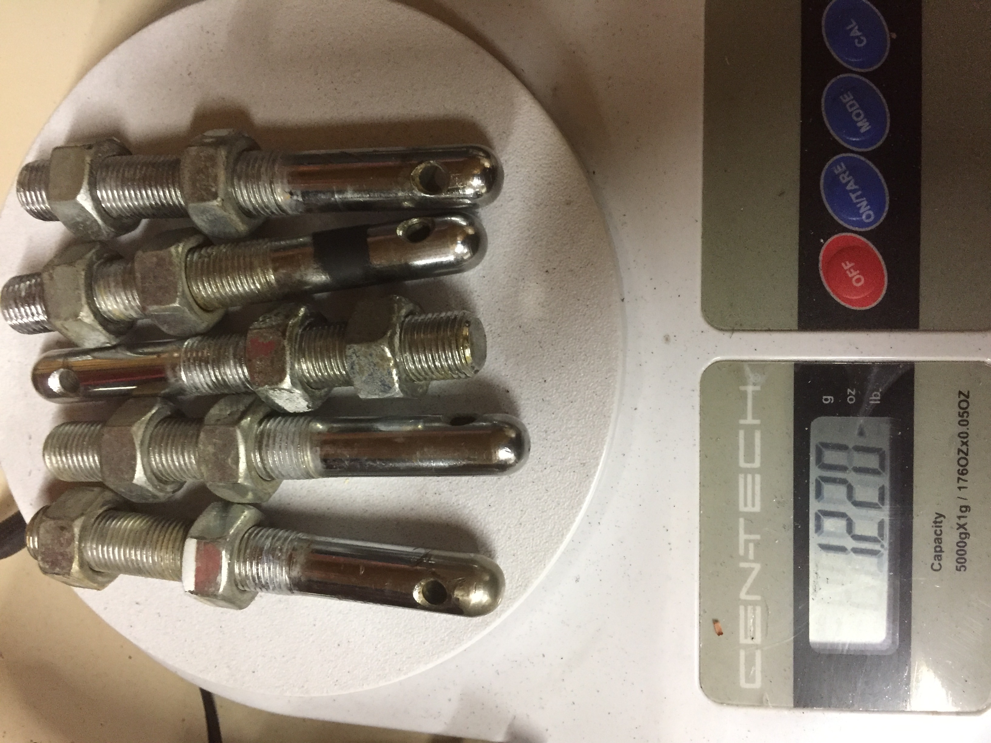

I use that same scale for stuff under 11lbs. I weigh EVERYTHING on my car. (You never know where reductions can come from).
As for the front, flat sheet of aluminum, an air brush, and you should be good to go.
-Matt
PostPosted: Mon Apr 23, 2018 9:47 am
Aluminum is another option. I've got a friend that is good with fiberglass. We will see. Thanks. I plan to have it look like a new Challenger in the front. I'll probably go down to a sign & graphics shop with a photo of a new Challenger grill and say, "Make me one of these to fit these measurements." :D
