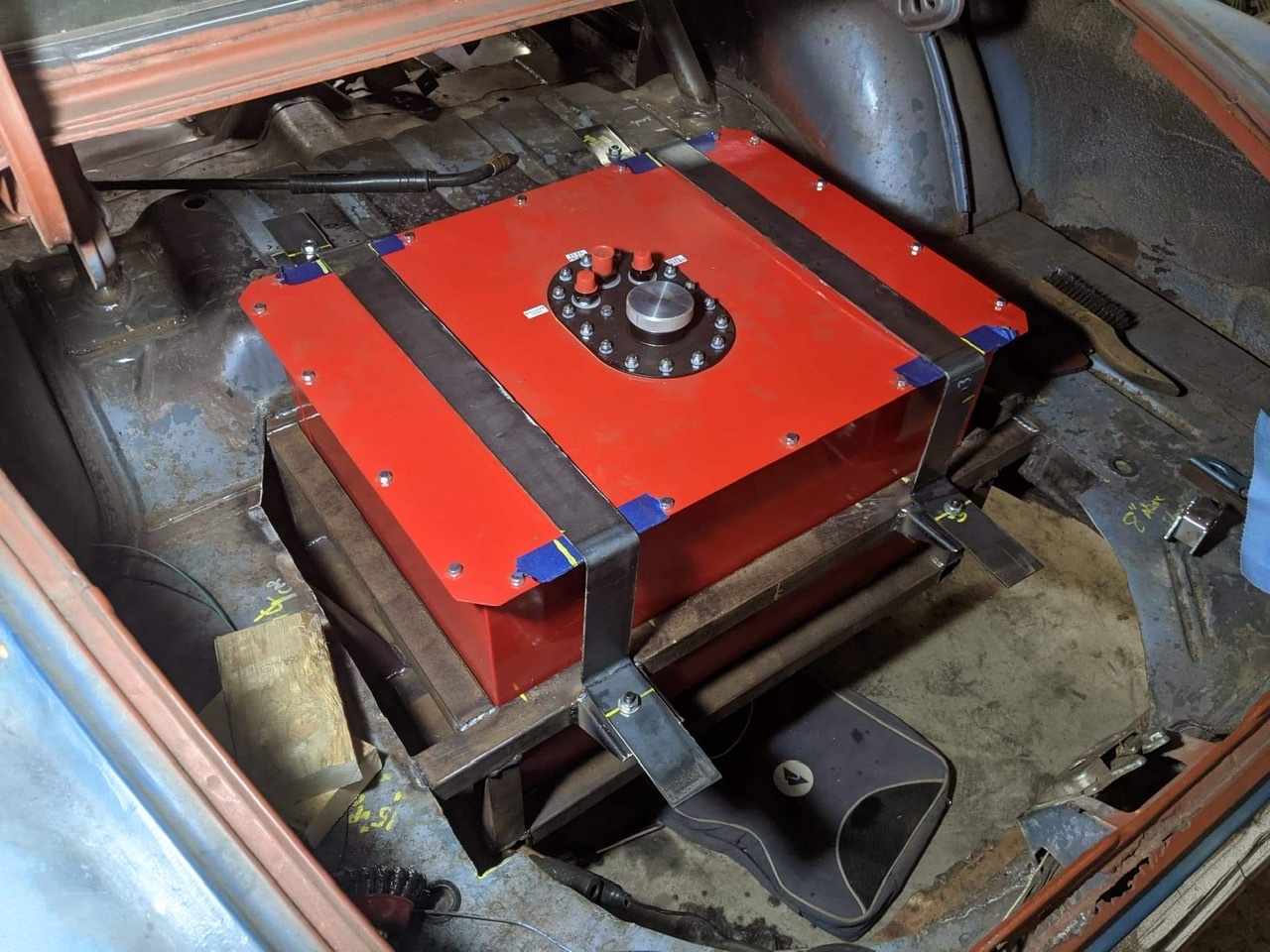

Adam has been hard at work finishing up the floors and installing the fuel cell in ToadRacer.
We will make a hard push at getting things buttoned up over the next month in an effort to be ready for the Lemons race in Sebring, FL 8-9 May.

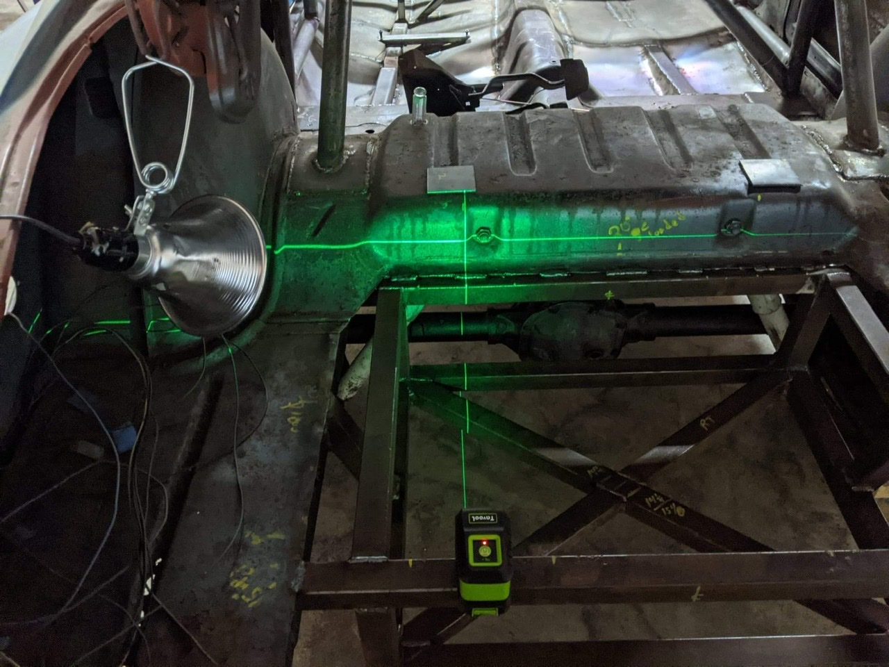

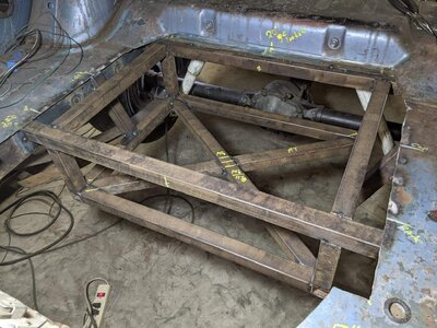

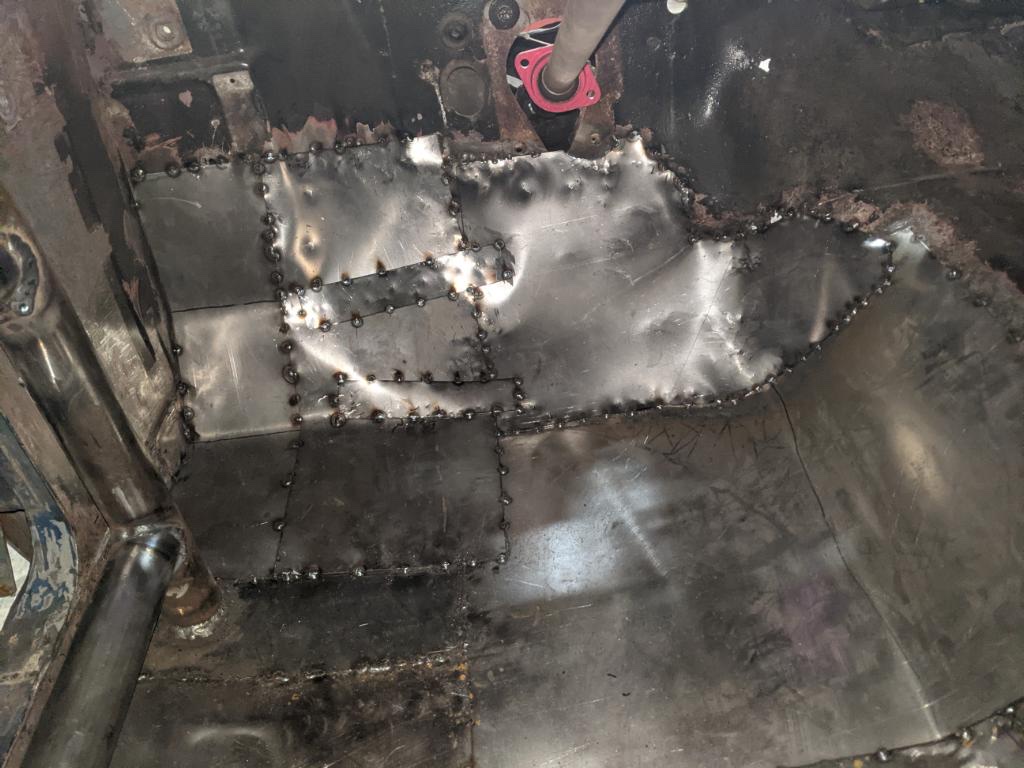

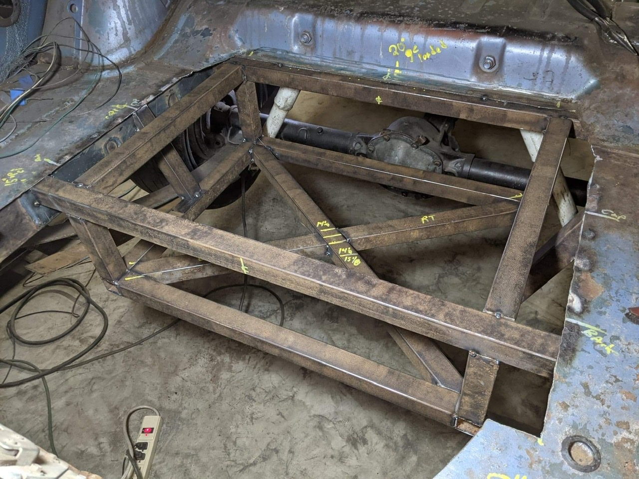

Very productive day on ToadRacer yesterday.
Shifter, master cylinder, brake proportioning valve all mounted.
Verified some things on the racing harness mounting.
K frame notch completed.
Holes covered in rear bulkhead.
Anti-slosh foam added to fuel cell.
Fuel cell cage mostly painted.
Several other little things I'm forgetting.
Lots and lots of bench racing and BSing.
Photos to follow...

So cool, Rob. I'm noticing all the sheetmetal welds to seal the firewall and replace the floors, really nice.
