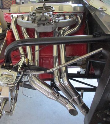

Here is the engine as of today.
Intake has to come off to drill the Holley pattern.
The intake has the early AFB pattern only.

Author:  Dart270 [ Sun Jul 25, 2021 3:34 am ]
Beautiful.
Author:  Rick Covalt [ Sun Jul 25, 2021 5:13 am ]
Looking Great Stan! Soon the sound of Slant 6 music will be heard!! :D :D
Author:  slantzilla [ Sun Jul 25, 2021 10:31 am ]
Is your intake missing the carb mounting plate?
Author:  Greg Ondayko [ Sun Jul 25, 2021 3:50 pm ]
Maybe..maybe not. Sure is hard to see on those low rez images :D

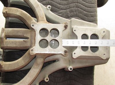

Author:  hyper_pak [ Sun Jul 25, 2021 5:46 pm ]
The manifold is a fabricated intake based on a 59 aluminum one barrel.
There is a large plenum welded to the outboard portion of the intake after cutting and welding.
The length is between a Weiand and a hyperpack.
Here are some more low res images.
It was professionally welded using parts I have no idea where they came from.
I think the idea was to retain carb heat but that was not functional.
The manifold was drilled today for the Holley pattern and the carb is now mounted.

Author:  Greg Ondayko [ Mon Jul 26, 2021 2:37 pm ]
Well that's why it's hard to see. 'cause it's not there.
Nice Custom parts.
