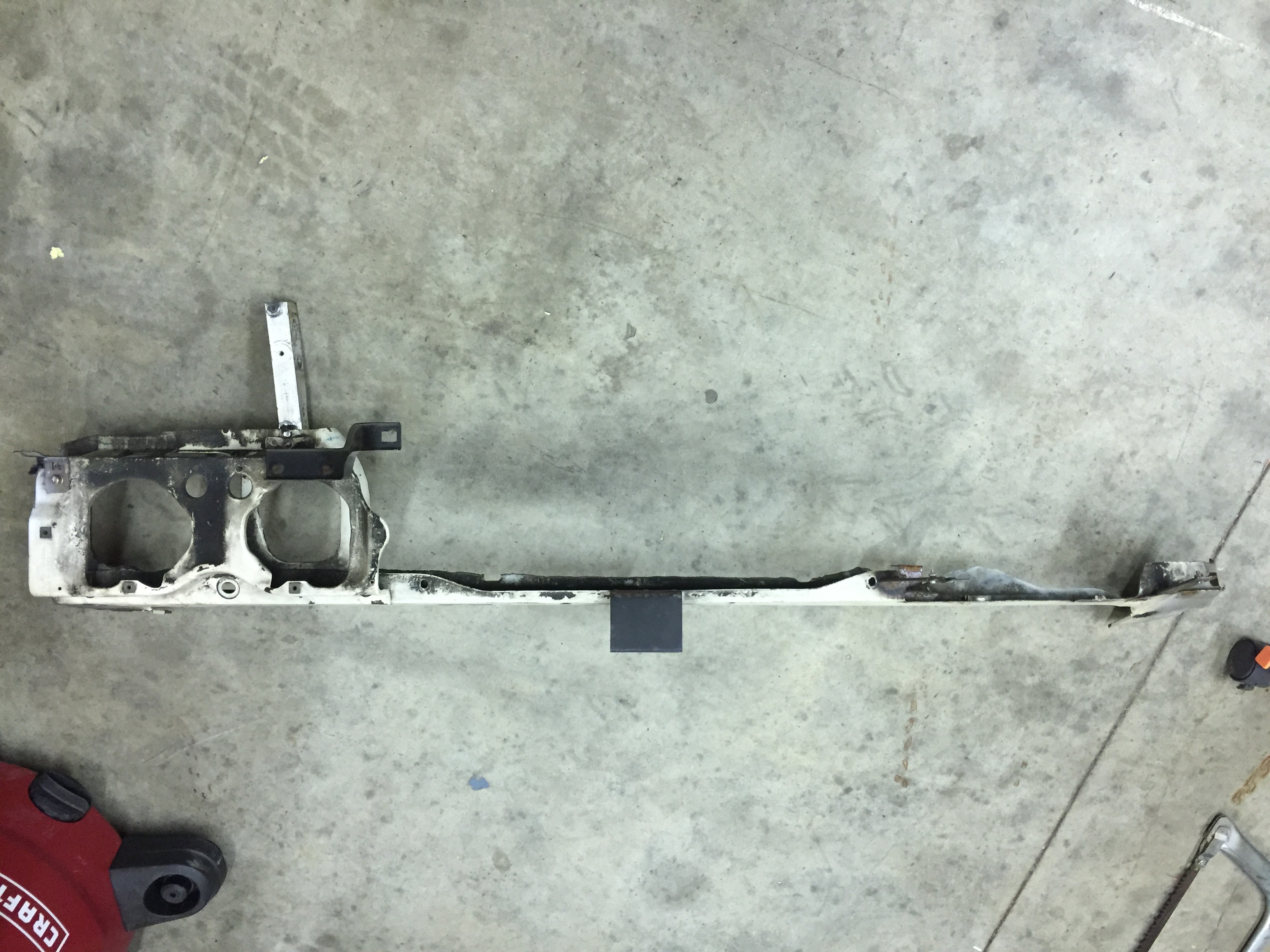

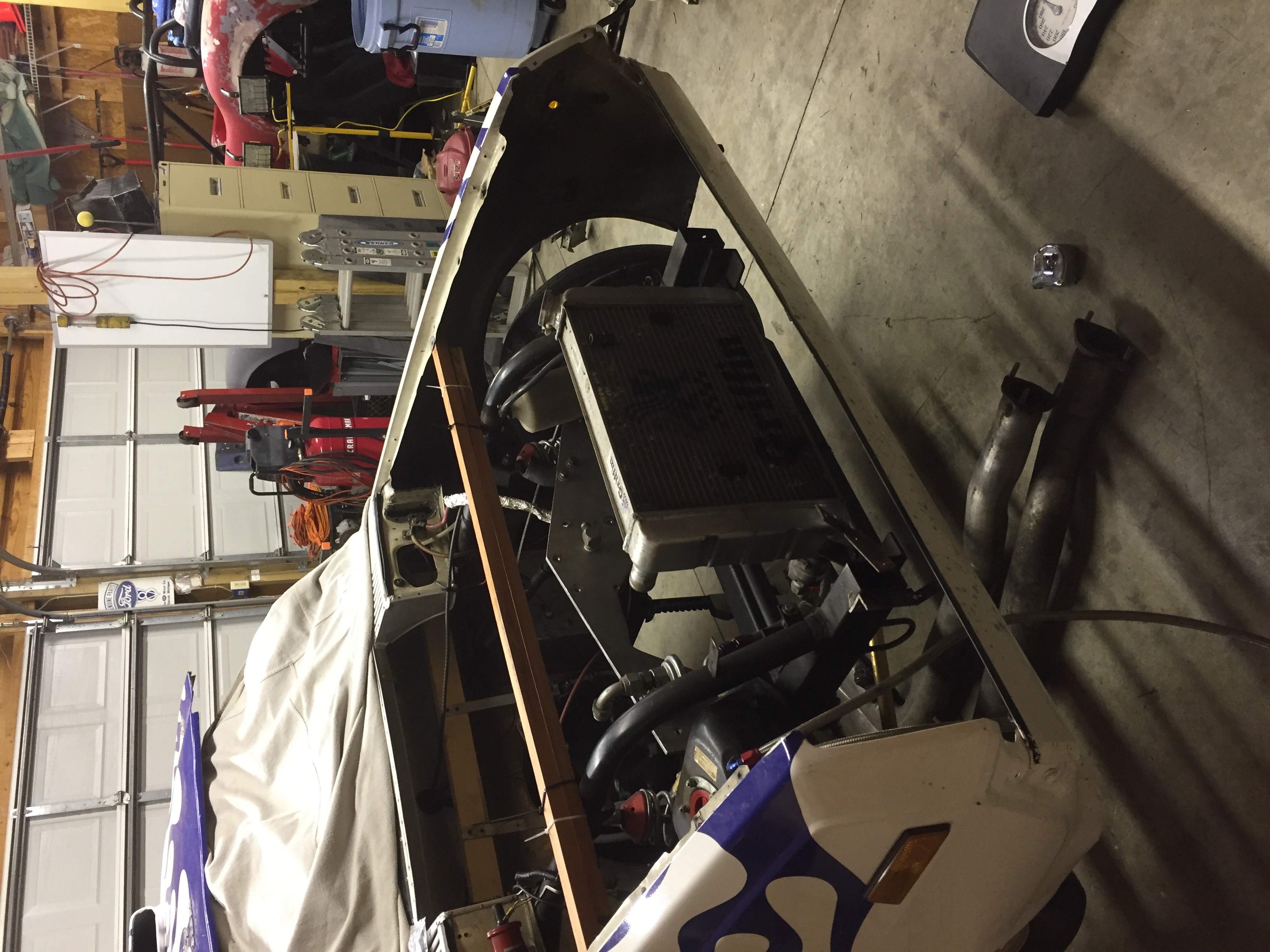

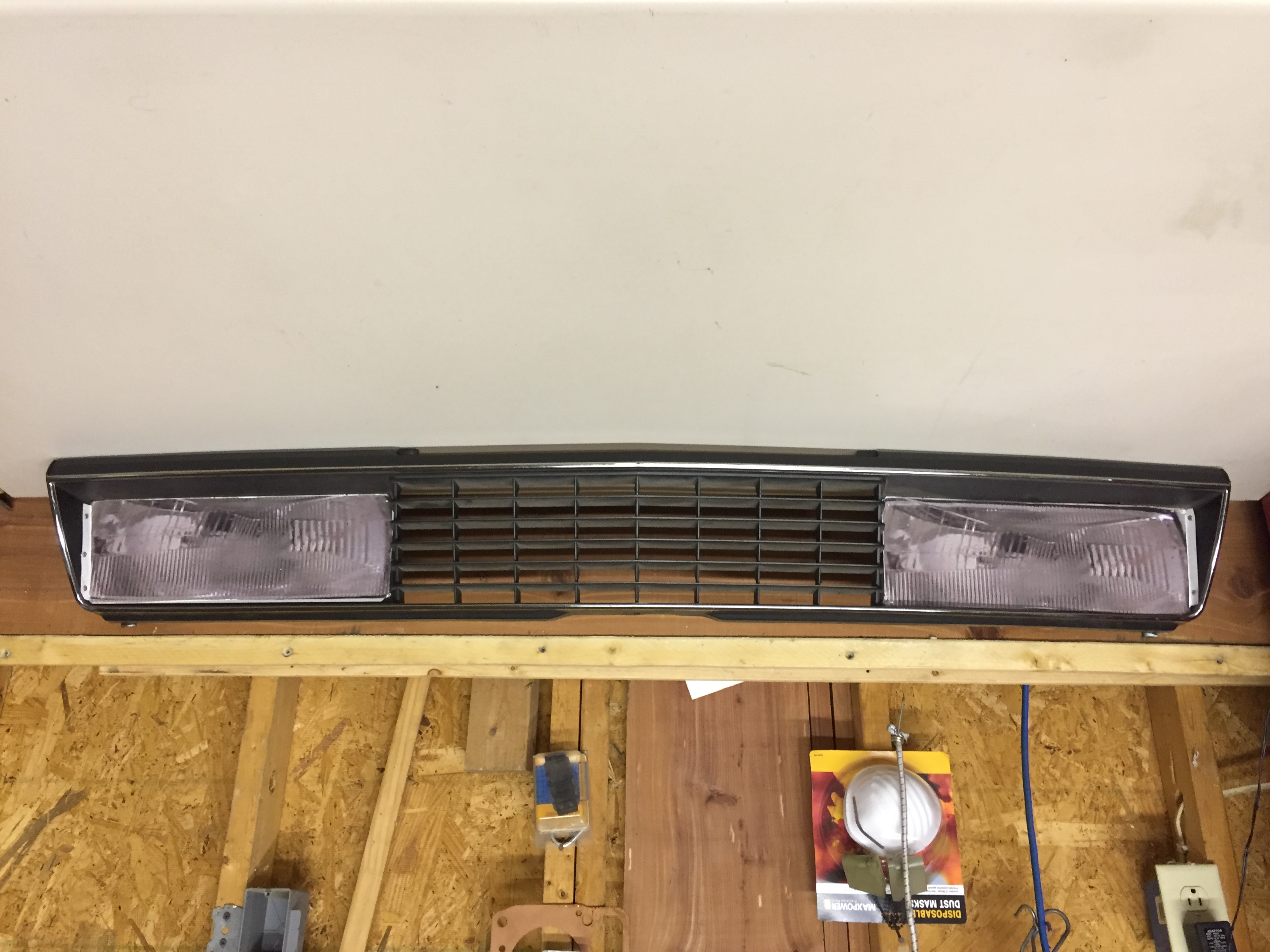

I took some more things apart last night... :roll:
What’s left of the radiator support weighs about 7 pounds.
I didn’t weigh the grill, but I will.
I need to figure out how I want to move the fuel cell so the new support and cell play nice together. More pics to follow.

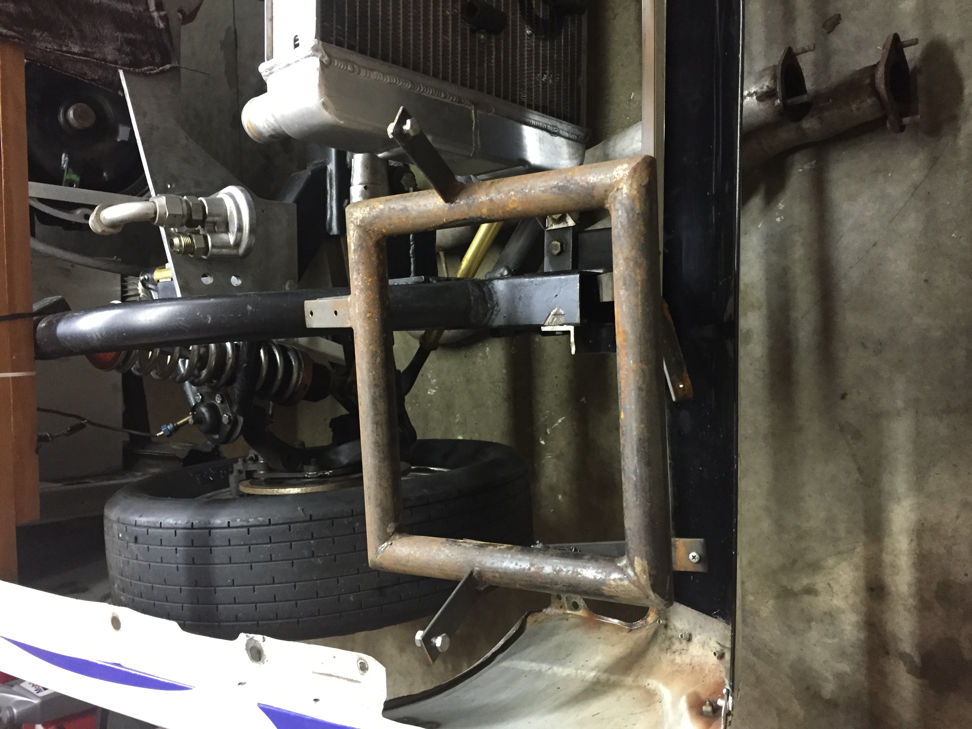

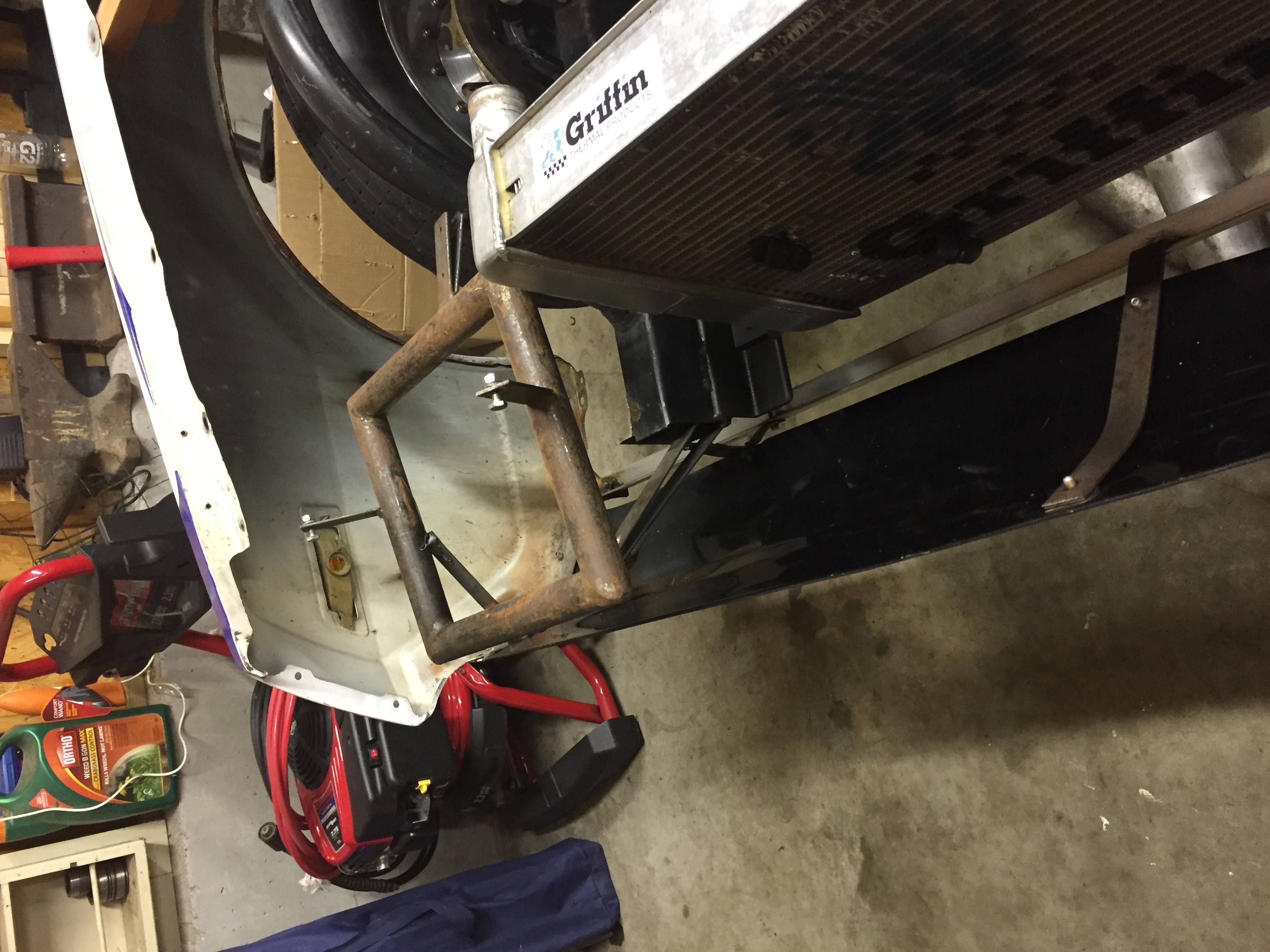

The fuel cell mount seems like overkill to me and weighs about 10 pounds! :shock:
I’m working on a lighter option using some aluminum I salvaged from a broken satellite dish. It should weigh less than a pound. Pics to follow.

If the cell is in the front I think it needs a crash bar around it.
PostPosted: Fri Apr 27, 2018 5:08 am
NHRA rules.
Tanks: When permitted by class regulations, fuel tanks located outside body and/or frame must be enclosed in a steel tube frame constructed of minimum 1 1/4-inch O.D. x .058 chromoly or .118 mild steel tubing.
I will look at how I can maybe move it a little, but keep the current frame. Thanks.

This is the little 1.5 gallon one used for alcohol. Everyone I've seen like this is mounted up front. Probably having to do with the fuel pump...(?)
It's actually fine where it is and it would certainly be easier to just leave it like it is. I was just being persnickety... :roll:
I'll rework the front fender support around it. I'll still be removing somewhere over 10 pounds off the front of the car by replacing the radiator support and grill w/brackets with aluminum stuff. :wink:
