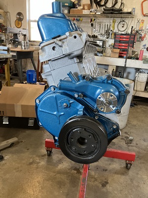

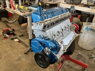

I have had an engine on a stand for over a year (Maybe 2!) and I decided to just get it ready before I pull the truck engine. Cam is a little big for the truck with an automatic but we shall see how it does. (Still a lawnmower cam though)
Here are a couple pictures before we do the swap.

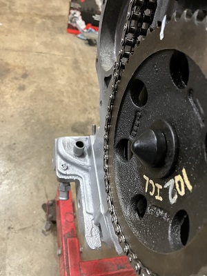

Also this picture shows the "plastic" cam button that Matt Deemer has made up. When I installed mine and checked it I had just a tiny bit of clearance without doing any mods to the button. No chance of an oil leak at the screw that I would usually put there. Thanks Matt!

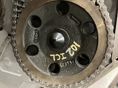

If you look at the first picture above. Look just above the #102 and through the timing gear hole you can just see where the plug should have been! :oops: :oops:
