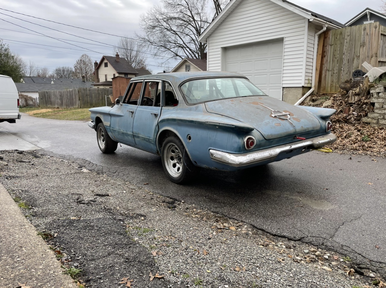

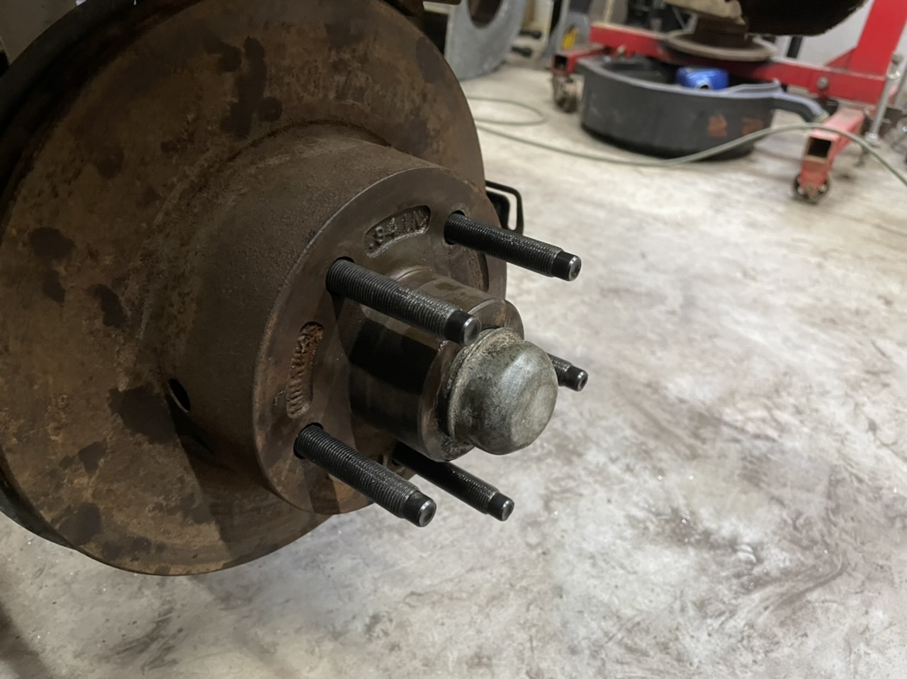

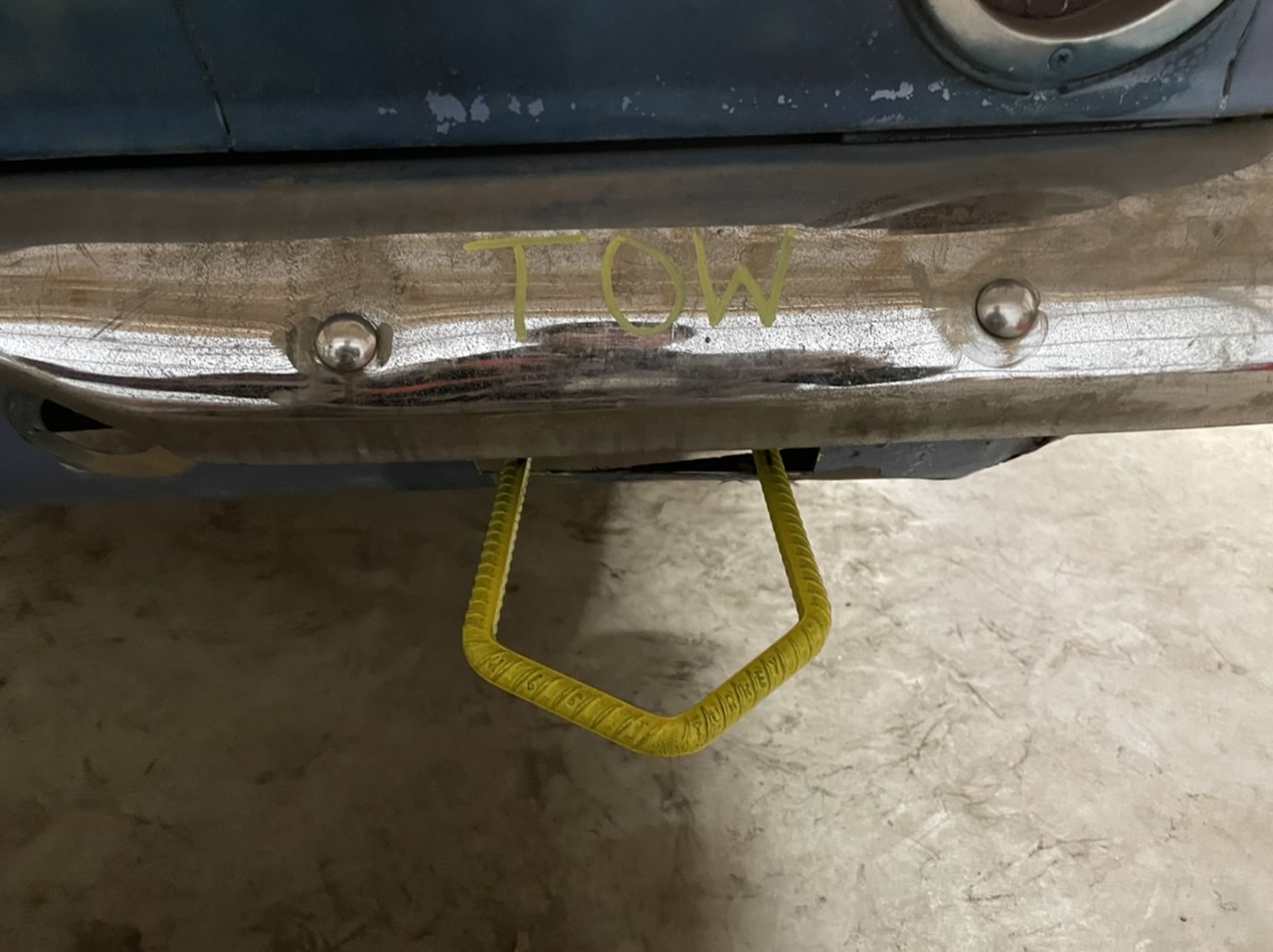

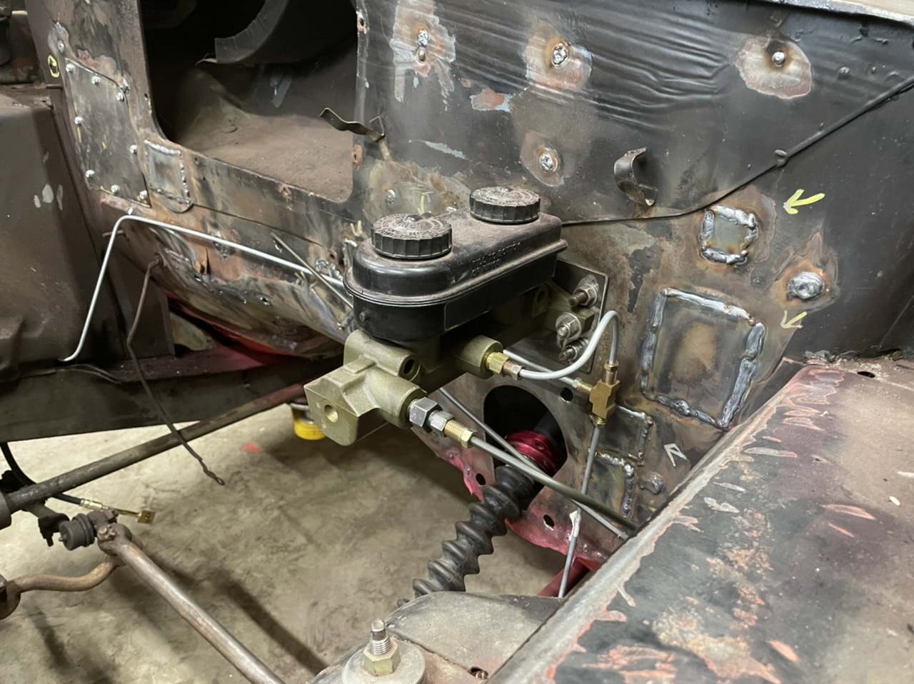

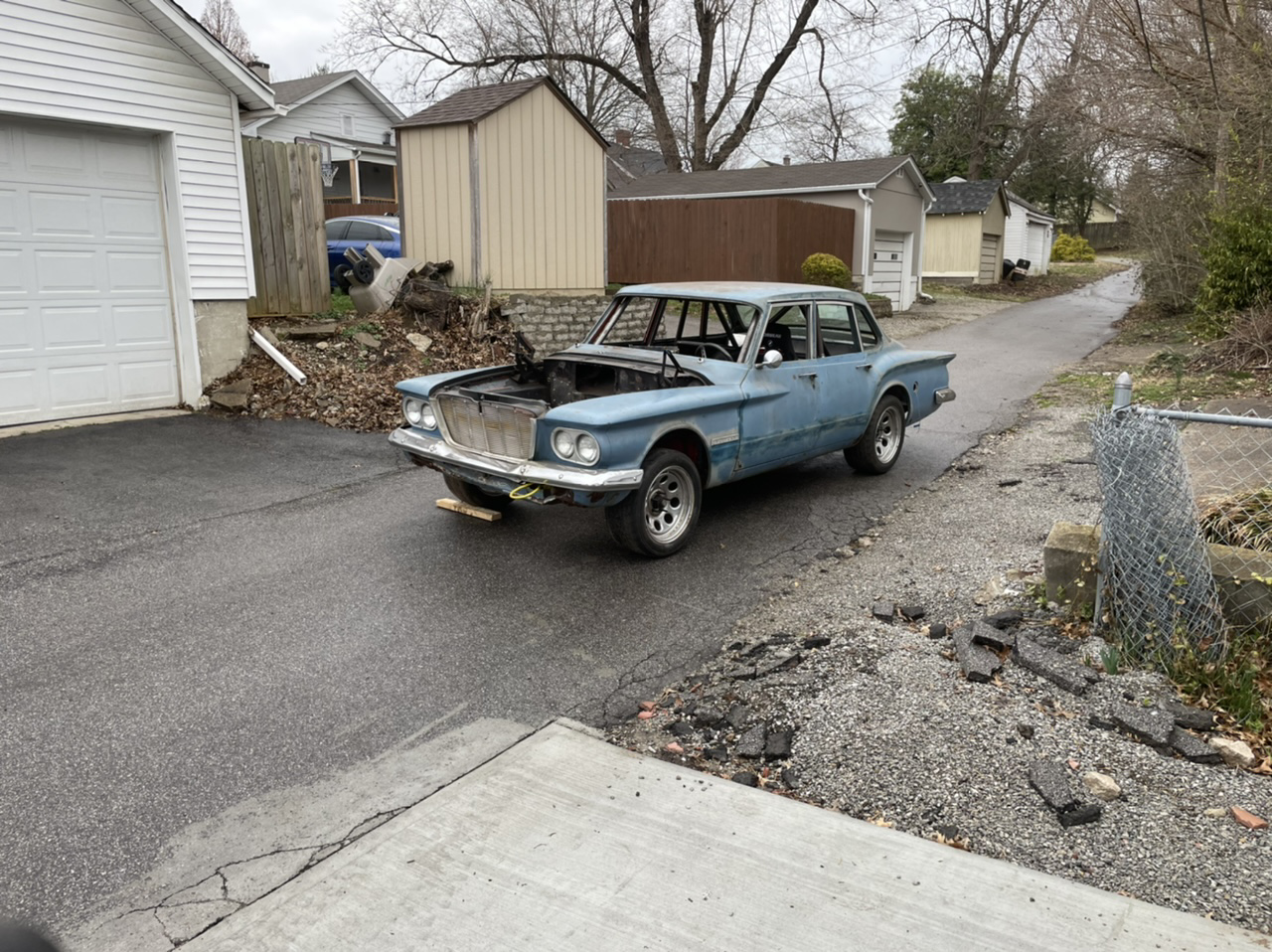

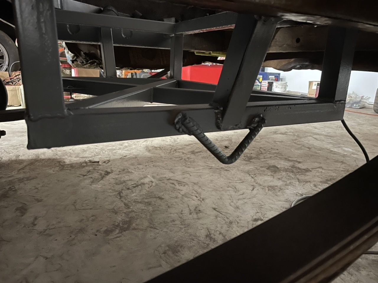

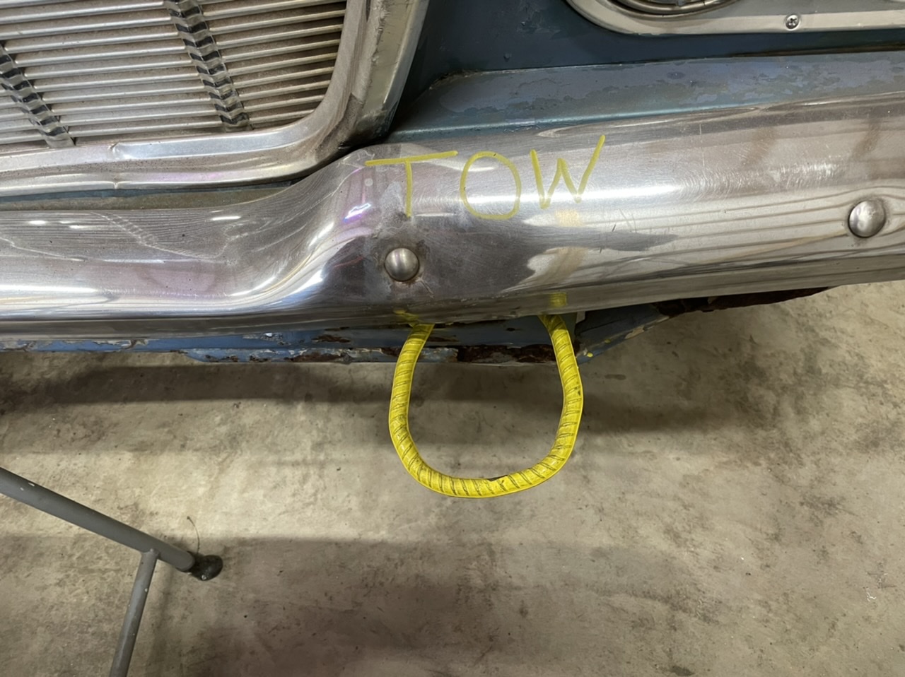

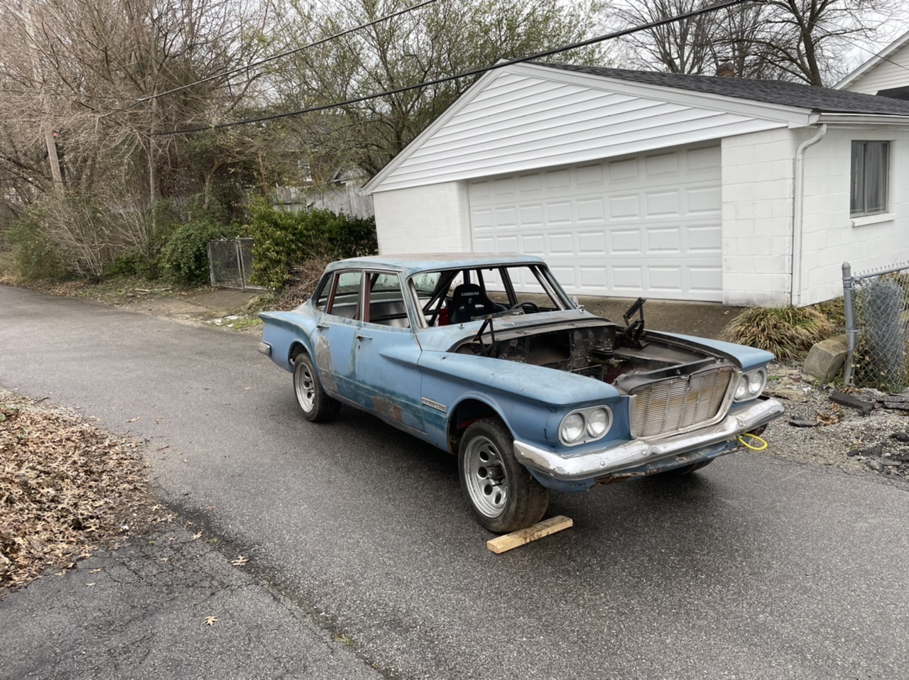

We had another productive workday on ToadRacer Sunday.
I didn’t get photos of everything. Adam mounted the fuel pump and filters, reworked the firewall bearing for the steering column, started planning wiring for gauges and switches.
We got an LED third brake light and adjustable seat back brace.

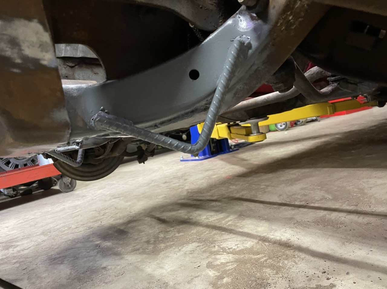

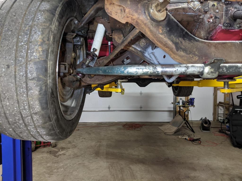

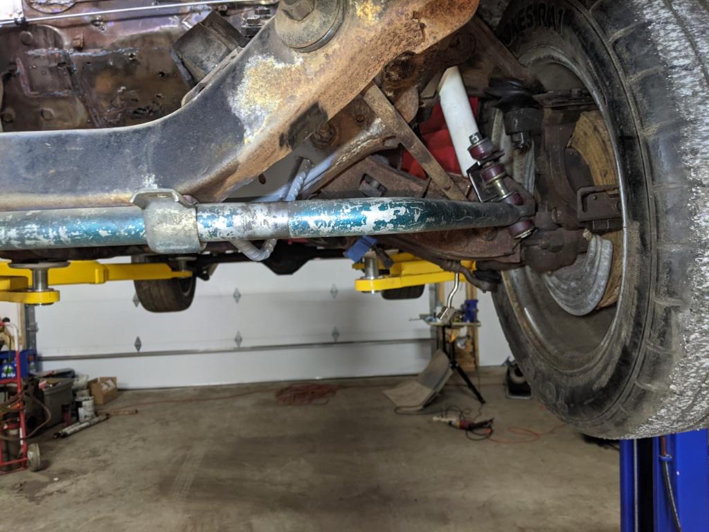

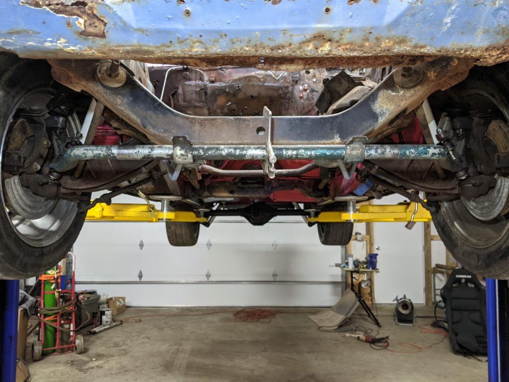

Adam made sway bar end link brackets. Better handling! :mrgreen:
PostPosted: Wed Mar 17, 2021 6:43 am
Posts: 10443
That geometry looks a bit off kilter.
PostPosted: Wed Mar 17, 2021 10:53 am
Posts: 17683
Yes, I am worried when it is sitting at ride ht that the angles will be very bad. Call (best) or email me if want to consult, no texts.
PostPosted: Wed Mar 17, 2021 11:15 am
Posts: 10443
I think that they will bend or break when subjected to lemons' shenanigans for hours on end.
Looks like that Sway bar needs to be torched up to bright red and possibly bent in towards the CenterLine of the chassis.
