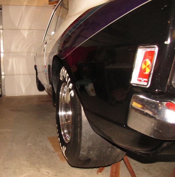

Working with Bogart has been a challenge.
Almost 6 months to get the rear wheels fixed.
But today they are back on.

What size tire is that Stan?

Author:  hyper_pak [ Thu Feb 17, 2022 9:08 am ]
Hello friend, I knew you would ask!
What was on the car was a Firestone 14.0/32.0-15
It measured 15 inches wide and 32 tall, 100 circumference.
The rims were wrong for the car, too much backspacing and the tire rubbed the ladder bars.
I wanted a 13.0 wide, 31 tall tire, but could not find one.
It doesn't fill the wheel-well like the Firestone but there was no way I could use that big a tire.
So I went with the Hoosier 29.0/12.0-15.
It measures 11.75 wide, 29.5 tall and 94 circumference.
So, if I can run 6K in high gear it should go 113 MPH in the quarter.
