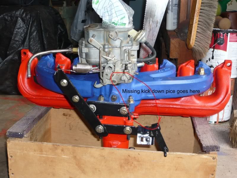

just a slight update, i am still missing one of the kick down pices, studs, and the gasket that goes between the manafolds and head.

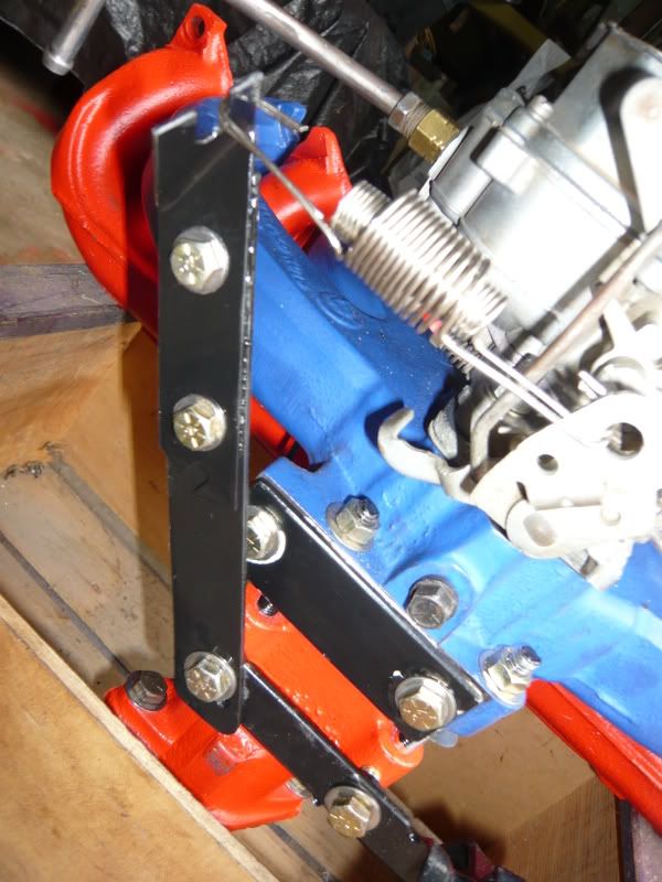

this is the throttle spring return bracket i made, it works really well and does not move one bit. yay! :D

interesting return spring brtacket, is that stock, i dont even member what mine is like. and when am i gonna make u some glass that says super six or mopar or somthin cool

nope not stock, i made it. seems to work ok.

nice! i made my own return bracket out of a piece of light angle iron, took off one side and rounded the others with an angle grinder. hung it from a wire and gave it a few coats of engine gloss black and clear coat from the rattle can, its not as beefy or nice looking as yours but it works! of course after that i saw a nice looking chrome one at the parts store for cheap...good work!

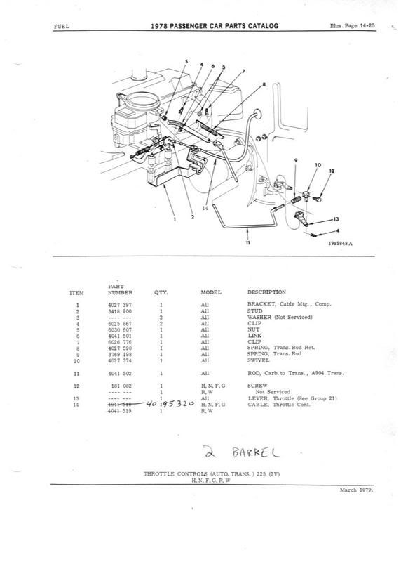

Here is a page scan from the dealer's orginal MOPAR replacement parts book for the super six. Printed in March 1979. It has all the part numbers and I figured it should be displayed to help someone else with there future or current super six project.
This was not easy to get, I also have the 1bbl replacement parts sheet scan. P/M me with an e-mail / addy if you would like the orginal scans or photocopys of these documents. never let a moparpunk with a laptop and a scanner loose around vintage parts books :D
