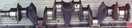

It means that there is a lot of extra weight on a SL6 crankshaft and some of that weight can be removed, in order to help the engine spin-up the RPMs faster.
As with most things in life, there are "trade-offs".
- It is a lot of work to remove weight off a big, forged steel crankshaft.
- The crank will have to be rebalanced after you do the weight reduction work.
- The engine will spin-up faster but has less internal inertia, in a stick shift car, that makes it harder to get moving and easy to stall.
- Small counter weight cranks have more harmonic stress, you need a good damper and even then, light cranks tend to crack more often.
