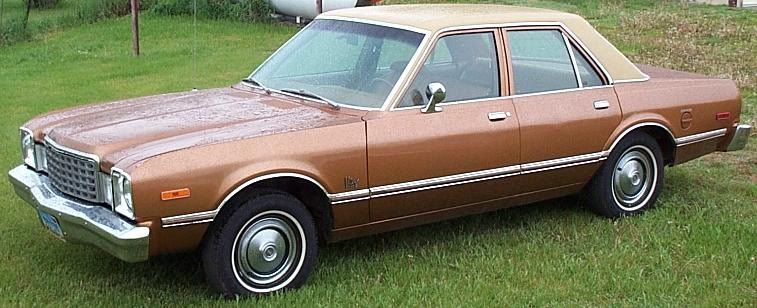

Beauty of a car! Would have been a shame to blow it up.

well thanks Reed. I am surprized this photo posted as I am new to tjis forum and had never done this before. Or maybe I have you to thank for posting it for me. Yes its typical 78 Volare, nothing fancy but really to nice to set fire to. I should have been concentrating on local estate auctions as a friend just purchsed a 1992 Lexus SC400 like new for $3200.00 A 250 hp v-8 sports car, but there is something special about the slant six, and this is why I put so much into keeping Grannies car road worthy. Again my thanks to all who helped me get through this puzzle! And thanks Reed for posting my photo how ever you did it.

I believe that is an original Octagenerian Edition.

Thanks for the photo, LogansRun, a very nice car indeed. I am sure that your granny would have been pleased to know your efforts to make it run good!
Take good care of it, if you can keep it free from rust you have a car for as long as you want to, and keep following the forum!
