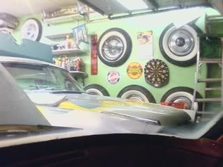

that's lola and her new desoto friend. she's worth every moment of grief (and they were manifold, no pun intended) to not drive a sh**aru. thanks for the boss car, wildcat!
