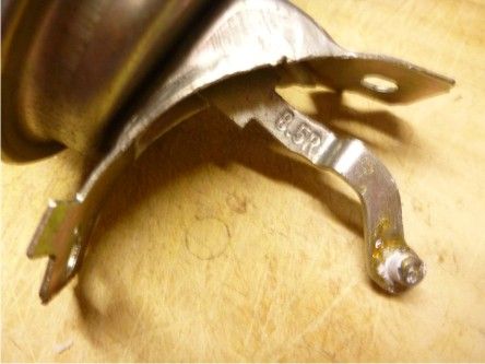

Get the long vacuum advance unit. Total should be 50 when done.
Sam
As this is my first time i have worked on a dizzy , what do you mean by long vacuum advance unit and what does it do ?
I will have a look what is stamped on my pod tonight.
Thanks ,
The slot in the arm that pushes the plate around should be long enough to allow 11 degrees rotation at the distributor, (22 at crank). Duster Idiot can give you the numbers for the stock parts that fit this description, but you can lengthen the slot you have with a dremel tool and a small cutoff disk until it does advance the correct amount. You can apply a vacuum to the pod while the car is running and watch the timing change. Some clever numbers guy here on the forum can likely tell you how long the slot must be to move the timing 22 degrees at the crank. Match that up with the mechanical advance slots you have and you will have a total of 50 if you set 10 initial. If you have an adjustable pot, you can set it so the v advance comes in at a range of vacuum readings that will match your car's specific needs.

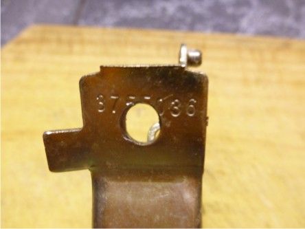

The numbers on my pod are 8.5 R and 3755036 where it bolts onto the dizzy body.
I am also running a 3.23 diff.

3755036 is going to be a long slot distributor so what ever spring combo you put in either has to work with it, or be short enough to limit the weights from acheiving the full 30 degrees of advance that distributor can generate....
I'd use a slightly lighter spring in the full coil position, leave the long slot spring, use a wrench to move the slotted spring post to start the tension earlier-move it to the away from the main/center post (and limit the total advance), and keep your current vacc. pod for now.
-D.Idiot
Do you mean long slot governor ?
Because it is a NOS 3874714 dizzy from Old Car Parts and it came with a short slot R11 governor.
DRIVE IT,DON'T HIDE IT
