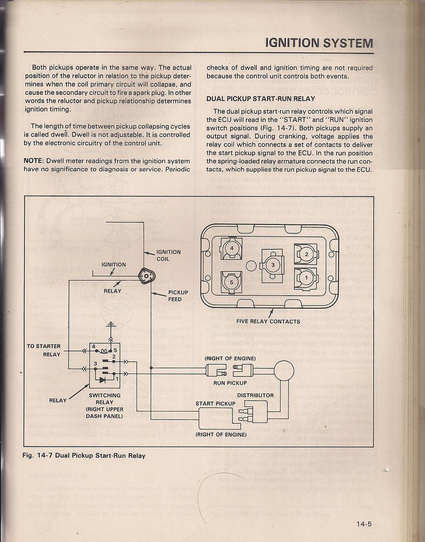

The 81 fsm does say not much.When looking close the pick-ups are off set slightly. The run pick-up is on the vacuum advance plate,normal position. The start pick-up is on a fixed plate,does not move. Sounds like there using the the start pick-up for timing retard at start and after start return to normal timing.Just a guess.

PostPosted: Wed Jul 08, 2015 7:26 pm
So start pickup is slightly retarded vs. run pickup...opposite of what I said. That makes sense, now I think about it, given the 12° to 16° BTDC base timing settings called for in the late '70s/early '80s cars...probably heading into kickback territory during cranking under certain conditions, so spark retard during cranking makes sense.
