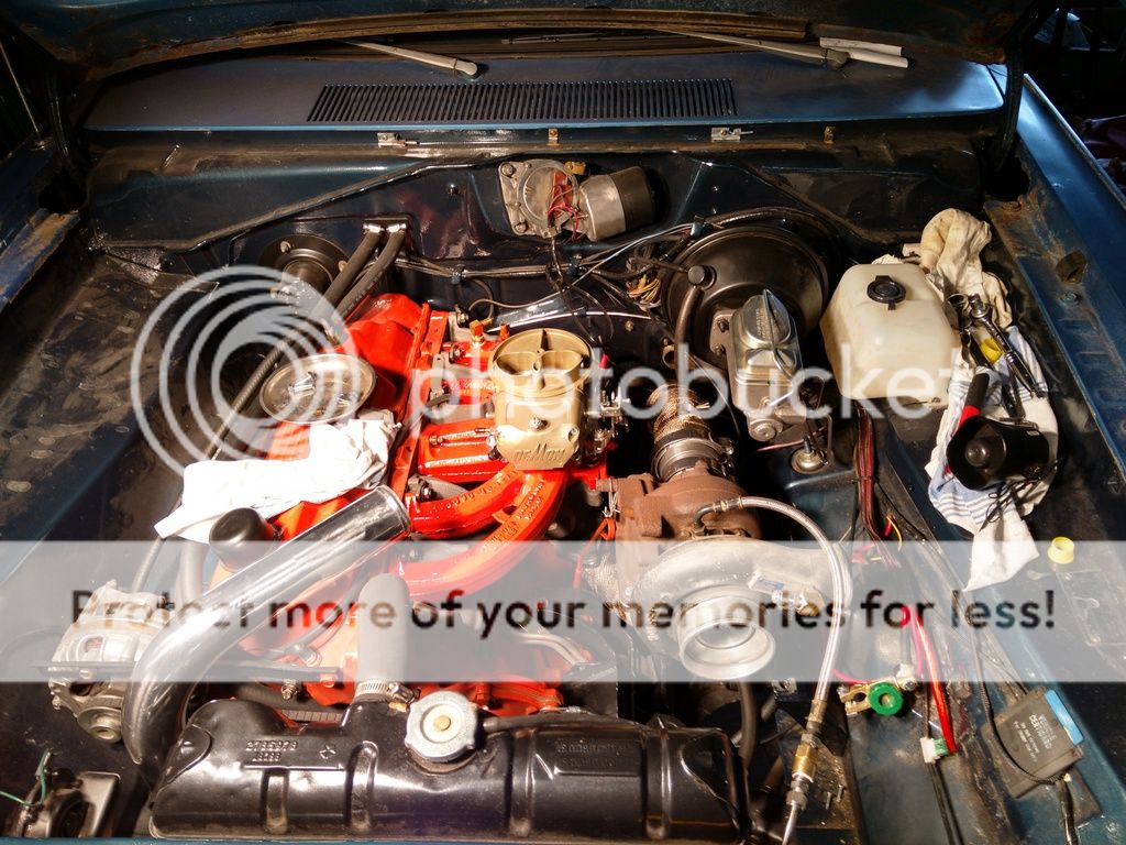

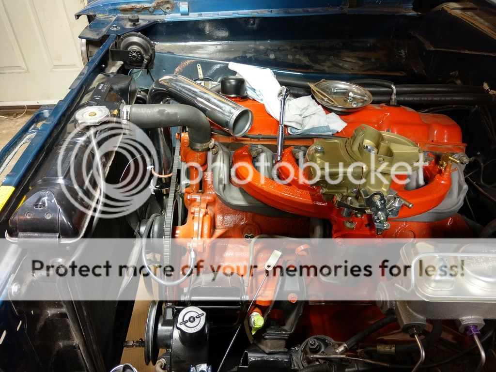

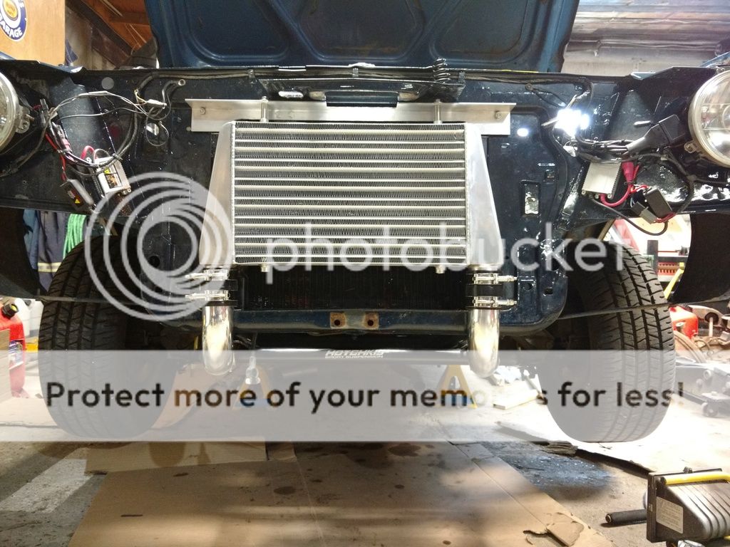

Got few more things done in the past few days.
Got the carb some what mounted, and the adapter plate fit perfectly, I was happy I didn't have to go back to get it milled out more!

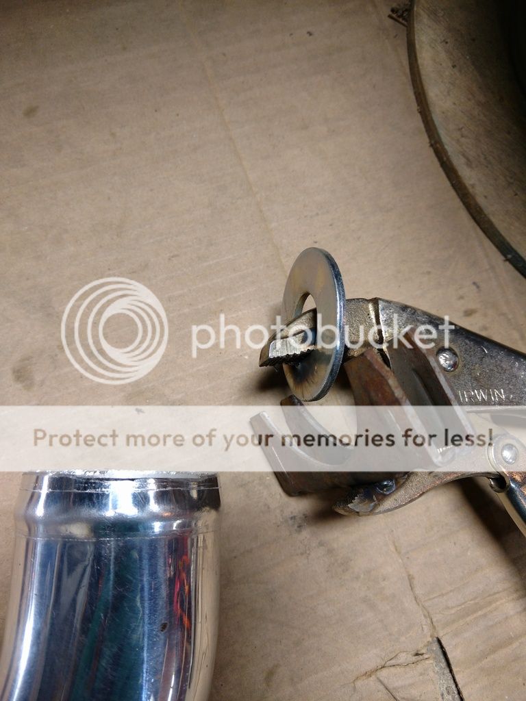

I made my own bead roller lol. Worked better that I thought.
Took a few trials of how much to crimp it. It also went faster than I thought, guess cause the pipe is fairly thin.
Then got the 180* clamped down where I want them.
I got around to heat wrapping the exhaust piping.
Made sure it was pulled tight as I could go, then used some stainless straps to secure it. In the pic I used some tie wraps to temp hold it until I got the straps on. Turned out great, seeing as I've never wrapped anything before, so lets hope it works!
Wanting to get as much done as I can, as were taking off for some vacation time and wont be back till April, then its spring and I should be driving it soon!!
If I can get my oil lines all hooked up, I think I will try and fire it up and see if there are any leaks or anything.

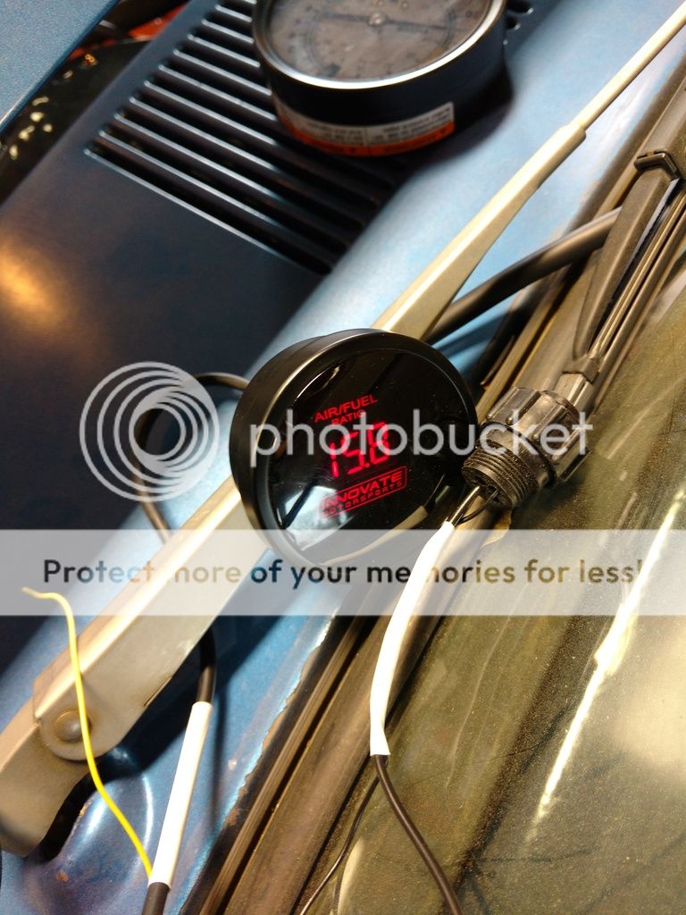

I got my A/F WB setup temp for finding my idle and part throttle.
Once Idle was set, I was pulling about 16-16.5" vac.
I changed out the PV to 6.5, from 3.5. That all I could find laying around.
So I will have to put in a 8? Its half your vac if I remember?
I put #69 jets in, as it seemed to be running lean when I held throttle half open.
Carb came with #60, I changed them right away to #64, and these 69's seem to be good with no boost.
I must have to jump up alot when I add 3-5psi at first...

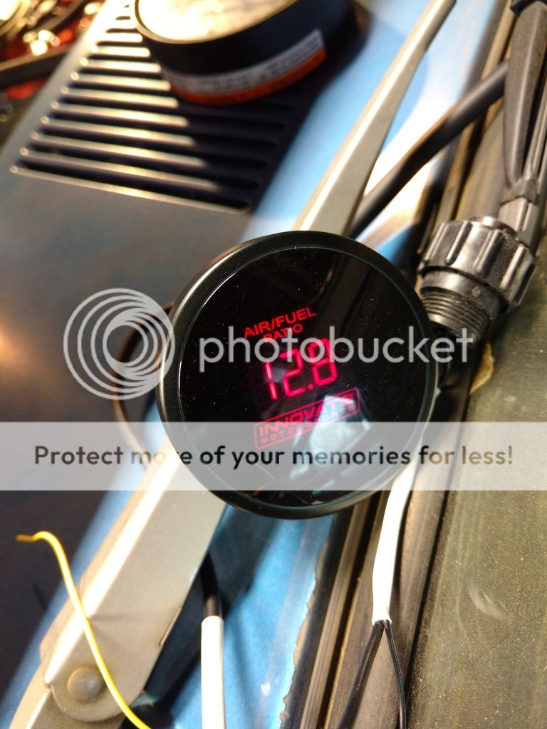

This was before I plugged the holes, its at as low of idle I could get.
Don't have a tach installed just yet but assuming like 1500rpm.
This was after the holes were plugged.
Huge difference, and sounded smooth like it ran before the swap.
The idle screws are 1 full turn out. I started with 1 1/4.
And after I let it idle a little longer, the A/F dropped a bit. Both readings were with warm engine.
