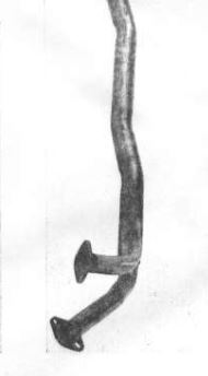

Is that the factory collector pipe ?
No it's not. It's a flowmaster 2 into 1 with 2 inch head pipes. My rear manifold had been cut years ago, so that is why the rear has that shape. Here is the factory head pipe.
