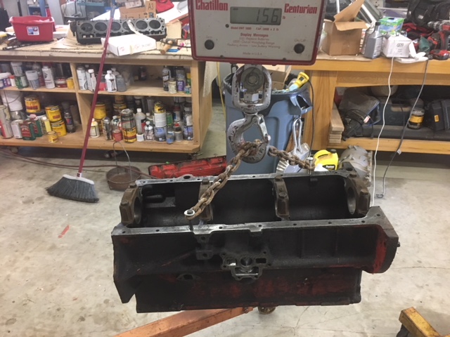

Aluminum weighs about 1/3 as much as cast iron. A cast iron block (225) weighs 156lbs.
Add in some extra lbs. for things like the caps and liners I'd guess the savings at.....75lbs.
