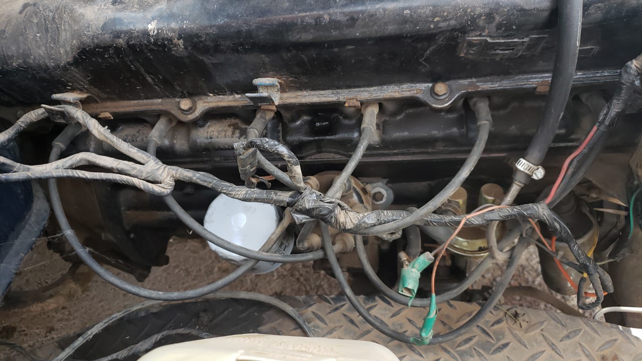

Blue box green arrow chrysler ignition box does not look factory, only mounted with one bolt. Green arrow at carb where does that line go any where?. That looks like line to vacuum advance on distributor. Take a picture of your distributor.

Yes you are right. Someone converted to regular electronic ignition. Sorry I didn't see it myself! :D
No the line doesn't go anywhere. The mecanic I took it to just put a hose on there. Need a better picture?

To answer an earlier question that is a factory ignition box or maybe an aftermarket replacement for one. If it is good (and being as how you can start the engine it is probably good. But I didn't see a vacuum advance pod on the distributor whoever converted it only did 1/2 the job. Where is your timing set? With the lean burn distributor it can't change timing. Maybe there too much or too little for starting? The original ignition (on that truck) would have been either hanging off the air cleaner housing or in the fender behind the battery. Someone has halfway converted it to the much better earlier ignition. I wouldn't go back.
But you need to go the rest of the way. I'd get that done and then look into the insulator that was mentioned.
