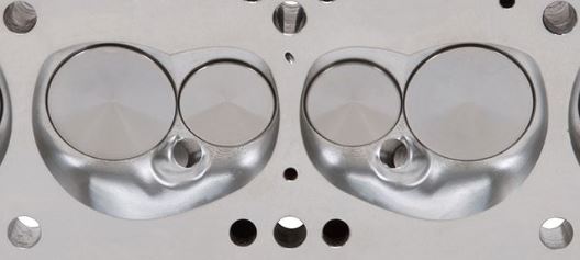

To follow up on my thoughts of a head that most folks could use.
The swirl port seems to be a port shape that starts the mixture flowing in the best direction.
If that best direction is for emissions, fuel economy or performance, I would guess a it's a compromise.
Some swirl port could be designed to direct the flow, but you would need a dyno and a flow bench.
The Heart shaped chamber is what I really meant to include i the design.
This I think could be modeled in your head design.
Here is Edelbrocks Victor shape for a small block LA engine.
