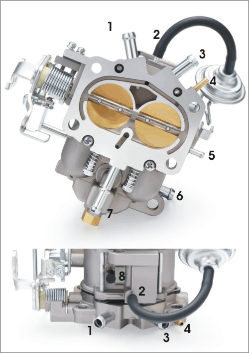

Ok, can I get a reality check on these ports?
This is what I think:
1) to evap cannister source vacuum
2) choke diaphram
3) PCV valve
4) no idea
5) distributor advance
6) to evap cannister
7) no idea
Eight) no idea
Now maybe I'm mixing up 1 and 7, but still one of them is unknown (to me).
8 and 4 - one of those could be for EGR and the other for warm / heated air from air cleaner?
If I have a small port on the underside of the air cleaner housing, should I connected it to either 4 or 8 even if it's not heated air? In other words, should there be air flowing into either 4 or 8 for normal operation (instead of being plugged) ? I assume if one of them is for EGR and I don't have EGR then it should be plugged?
What is best port to run to a vacuum gauge?

7 is for evap canister supply vacuum. That is copy of later bbd, 79 newest have to look at. 7 gets vacuum above curb idle at off idle speed , no vacuum at idle. Does not get full vacuum there is restrictor in carburetor, older units might be in canister. Not all canister the same, but all had flow restrictor some where.
PostPosted: Sat Oct 14, 2023 4:36 pm
Posts: 1603
2 looks right good place for vacuum gauge
PostPosted: Sat Oct 14, 2023 4:39 pm
Posts: 1603
3 looks right, 1and 3 go to same place? 1 might be power brakes
PostPosted: Sat Oct 14, 2023 4:44 pm
Posts: 1603
4 Heated air cleaner, just a guess, does not flow air just vacuum. 5 Dist vacuum advance
