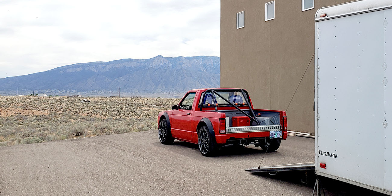

All progress stopped with the long wet winter. However, I won't get back on it for a while. I'm in the middle of moving from Oregon to New Mexico. No more long wet winters for me!
The only update I have is that the last trip was moving the Slant S10 down to NM.
