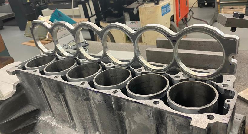

Just an update, Robert Maw on FB who is doing the billet heads has also done a billet deck plate. Not sure how he's mounting it in the block but from the pictures I've seen it sure is purty.
PostPosted: Sun Jan 07, 2024 7:50 am
Posts: 2735
Zilla, If I remember correctly he machined a step in the block top,
machined a thick plate,
pressed it in with some super duper adhesive compound.
Something like that.

That is exactly what I was thinking of doing. I bet it should work very well and allow you to make real power and save the head gasket. Hopefully the guy will actually get something running someday...

Here is one picture:
PostPosted: Sun Jan 07, 2024 2:25 pm
Posts: 17641
Cool, thanks. That is perhaps better or at least more elegant that what I was thinking. Mine would be easier to make. I think you could just mill the outside of the block down about 1/8", then make a flat plate that would slip fit around the cylinders (maybe with a light "trace" around each cyl liner with a CNC mill after locating the center of each bore) and be sandwiched between the head and block. The plate would have head bolt holes and would look just like the bottom of a cyl head but with bores that would fit the OD of the cylinders.

That block was super nice.
He milled the top of each cylinder so it had a step on the inside and on water jacket as well.
