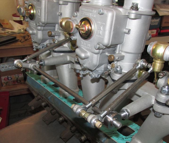

Working on my Webers. I got my jet set and have them all together.
Next working on the linkage and fuel line.

This linkage is a mess!
Going to spend a little time getting it all sorted.
And fuel lines too.
Do you find you have to remove the tops often?
I am thinking about three separate lines if I do take them off.
Float level and anything else I might need to tweek.
PostPosted: Sun Aug 14, 2022 11:58 am
Posts: 9349
No, I set the float levels when I installed them and never touched them until I removed them and changed the venturi to 40mm.
The Red line linkages are a bit nicer with 3 mounting posts.
Ryan is running the Clifford on his. Pretty sure he is running 3 separate carb linkages

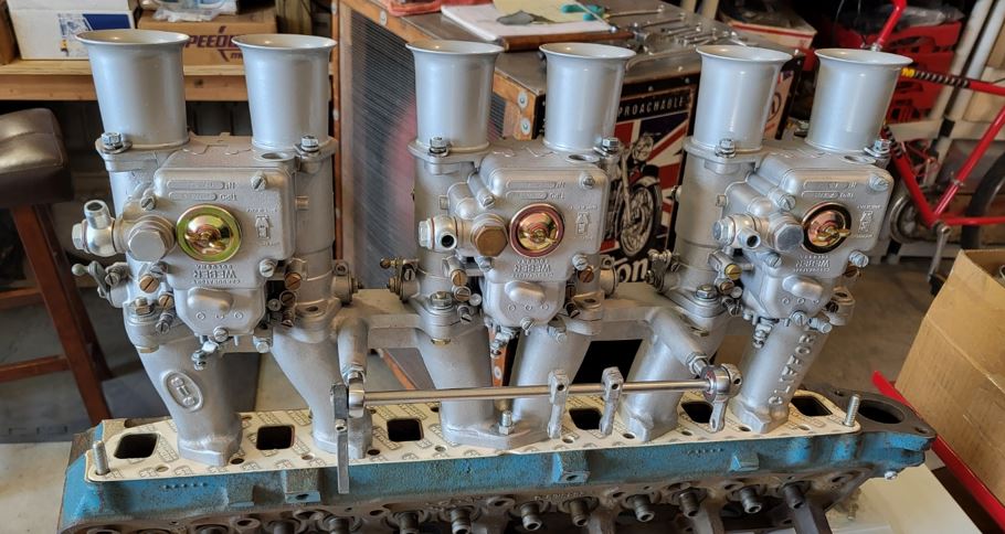

Got my linkage almost done.
I need some 10-32 left handed jam nuts. And the right ones also.
Forgot to order them from McMaster Carr.
Here is what I have now.
Rick, I got those shims, thank you.
