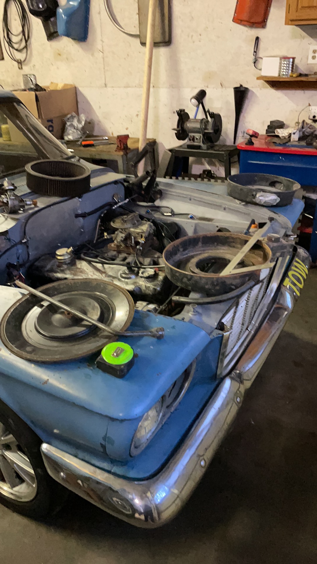

I went over to the garage this evening and wandered around aimlessly for awhile.
I did do a little planning on how to make our cold air induction work.

Thanks, Rob! BTW, do we have an AFR gauge on there? If not, I'd like to get one in there for the upcoming race. I/we can do it the day/eve before too, so no biggie.
Cheers,
PostPosted: Tue Aug 10, 2021 6:26 am
It does not yet have an AFR gauge. That would be an excellent tuning upgrade!
PostPosted: Tue Aug 10, 2021 7:22 am
Posts: 9094
I didn't notice, but is the carb a 350 cfm, or a 500? If a 500 I'll hazard a guess it is rich over 3,000 rpm. Just curious, let me know what you find.
PostPosted: Tue Aug 10, 2021 9:07 am
It’s that little 2 barrel what pretends to be a 4 barrel. 350-500.. 427…396…. I dunno… :? :lol:
PostPosted: Tue Aug 10, 2021 9:09 am
Posts: 17683
500 2bbl. Still need to tune jetting with something more than seat of pants and how much smoke is coming out the tailpipe...
