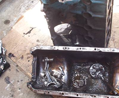

Aftermarket rods. Stock rods will not last at 7500-8000.
Oh, and some new kind of head that will flow enough to support that kind of RPM and make power.
And a block that will keep the main web in at the RPM you speak of.
What happens to the main web?

It breaks.

Alot of stuff breaks when that happens...
To be honest, the biggest problem I have with high RPM Slants is keeping all the bolts tight, every fastener on the thing wants to loosen-up.

Well duh, but I mean why does it break? Is it just not strong enough to handle the higher revs? What exactly happens, is it actually pushing the crank out of the block? Is it harmonics or what?
I know low end is lost to gain higher revs, I'm just interested in knowing the limits of the engine. Curiosity really, is all.

A 6 cylinder crank is neutrally balanced. When you spin one at the balance shop you don't hang bob weights on the crank like you do with a V engine. In my estimation the problem with our cranks is the distribution of the mass. Because the counter weights are distributed unevenly between the throws it causes the crank to flex and tears the block apart. If one were to have a crank made with counter weights on both sides of each rod journal the crank would flex much less and live longer at high RPM.

Ok gotcha, thanks. That's the kind of info I was looking for.
