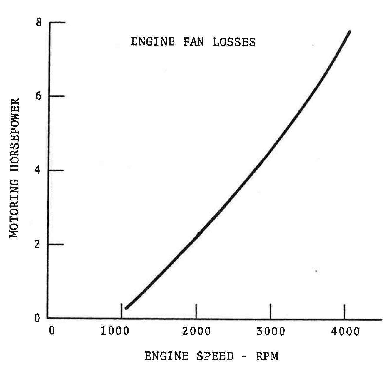

Just in case if anyone's still interested in this topic, here's a relevant plot from the last page of a relevant report, namely:
Friction Tests of a Chrysler 1978, 225CID Engine
Report No. DOT-TSC-NHTSA-80-14
DOT-HS-805 487
U.S. Department of Transportation
Research and Special Programs Administration
Transportation Systems Center
Cambridge MA 02142
Available for free download here.

Wow. That's a significant power loss. Especially for a race car.

Especially if you are turning 4500-6000 RPM for most of the track... Thanks for the post, Dan.

After installing my 3" radiator and electric fan in my race car, I would never hesitate to remove the mechanical fan on any of our engines. The engine is just so much easier to work on and safer on the fingers. Warm up time is shorter, and you only have a fan running when needed. Freeing up horsepower at 6300 rpm is a nice bonus too! :D
…only for a race car. Not for those of us driving on the street.
 Post subject: Re: Cooling fan
PostPosted: Wed Feb 22, 2023 3:36 am
Posts: 17641
For normal street driving, this will have very little effect. Most people never see north of 2500 RPM (maybe 3000) in a stock Slant car.
