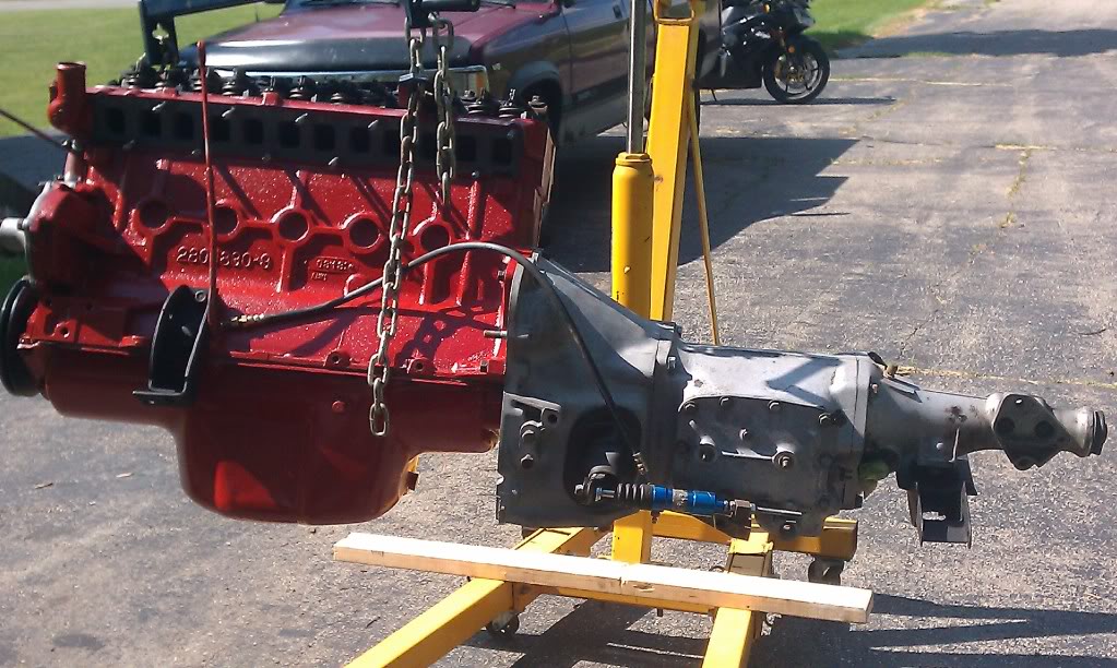

Does anyone know how reliable and well hydraulic release bearings do work?
How about this setup would this work?
Author:  DadTruck [ Sat Jul 14, 2018 1:37 pm ]
Post subject:  Re: 225 Slant in 1st Gen RX7
One advantage to the external slave cylinder is you
use a conventional throw out bearing.
IIRC ‘87 D150’s used a set up like that.
Concerning reliability, I have a ‘96 GMC Sonoma with
+200K miles with a hydraulic clutch and zero
maintenance on the hydraulic clutch system.
So they can be troublefree, there are issues with
the aftermarket installs, probably due to the
custom installation...
Author:  Slant 6 #6 [ Sat Jul 14, 2018 2:37 pm ]
The Tilton hydraulic release bearing has great reviews.
Im fighting for every bit of space in this area for the throw out fork etc.
Like to here from those who have these type of release bearing setups.
As this car is already set up for a hydraulic clutch it makes things a bit less complicated.
