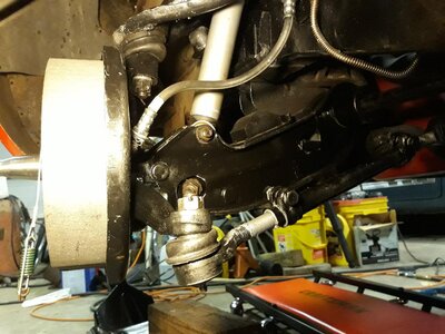

New question: In 1965, the stock tie rod ends, inner and outer, were both bent style. Right now I have two straight ones. The inner tie rod ends look to be squarely seated in their bores on the center drag link. If I change the outer tie rod ends to the older bent style, do I also need to change the inner ones to match? The reason I ask is that the bent style is, for some reason, double the price of the straight ones.
Photo: Looking from the rear of the car, you can see that the outer tie rod end is not square with the arm on the lower ball joint.

Sadly, this project is turning out to be a disaster. Not only am I left to guess about the correct tie rod ends but now I discover that the shop that installed my lower control arm bushing decided to get lazy. Instead of pressing the pin back into the bushing, like it was originally, they decided to grind down the pin with a wheel so it would fit in easier.
Correct me if I am wrong, but isn't that pressed in pin basically holding pretty much the whole front end together? You have to torque it to 180 ft lbs, so I assume it is holding quite a bit. But now, thanks to them grinding the pin, the only thing that is really holding the lower control arm in is the strut, the weight of the car on the torsion bars, and that paper clip looking thing that holds the torsion bar in place.
I discovered this after I assembled the driver side. Now I need to tear that down at least somewhat, so I can inspect to make sure they didn't grind that pin too. If they did, I will have to dismantle pretty much everything you see in that picture, possibly ruining my brand new parts in the process.
Disaster seems too mild a word for this mess.

Ack. Sorry to hear about the strife. That interference fit is not strictly necessary, but they shouldn't have done that. Doug Dutra has drilled the end of the pin on the tbar end for a 5/16" (IIRC) bolt and washer, when using poly UCA bushings, since they let things float fore-aft (unlike the factory rubber, which I always use).
I would not use some kind of non-stock "straight" tie rods as they might put the ball-and-sockets of the tie rods close to their limit of rotation/swivel. However, yours do not necessarily look wrong as they have an offset to them. You have the susp at full droop, so they will look weird in terms of angles. Look in the FSM on setting ride height and adjust your tbars to attain that.

If your year/make/model/Kframe configuration/spindle/lower ball joint configuration calls for the bent ones, that is what should be there....
My year/make/model and Kframe all take the bent variety. The spindle and lower ball joint configuration (`71 Duster) would take the straight type, so that is why I was unsure which type to order. I now believe I should have the bent type, but I am going to wait and see how it behaves when I get the wheels back on it. If I notice anything wonky about the steering, I will replace these straight ends with the bent type.
if they are not n an even plane it can cause bump steer, binding, and other issues... maybe the taper doesn't match between them...
The studs are the same. The difference is in the threaded shaft. On one it is perpendicular to the joint, on the other, it is bent upward at a slight angle.

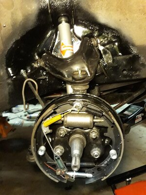

This is something I discovered when I got it together:
The lower ball joints have a nub cast onto the back of them on the arm side that bumps against a raised area on the lower control arm. These have the effect of restricting the turning radius of the front wheels to about two turns of the steering wheel either direction from center. This causes the turning radius of the new front end to be far less than it was with the stock arrangement. (It was three turns either side of center with the old system.)
I am strongly considering grinding these nubs down a little so the wheels can turn a bit more. Before I do though, I would like to know if any of you know why these nubs are present to begin with. Surely a 71 Duster had a wider turning radius than these things will allow.

The nubs are always too big on aftermarket LBJs, and particularly when using 73-76 LBJs. I always grind them down until I can hit the locks on the steering box. Annoying, but easy to fix with an angle grinder. Don't get them too hot or you might decompose the grease in the ball joint...

Thanks for all the advice. I ground them down today. I had to pretty much grind them flat to give them the full range of the steering linkage.
What is the point of those nubs anyway? It takes additional material, so I assume they must have a legitimate purpose in some application?

Later lower control arms don's have the bump. The bump was essentially moved to the ball joint. The problem is you're using late ball joints and early control arms. If you'd swapped in the late control arms you wouldn't have created or noticed a problem.

File comment: The ball joint before I ground the nub down. The nub is hard to see, but is just below dead center of this photo.
File comment: Where's the nub?
File comment: All assembled except for connecting the rubber line to the metal line. A thing of beauty.
