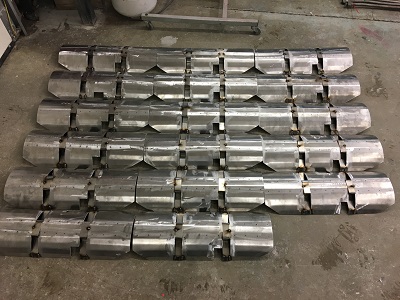

Trays are coming along. 17 have been welded up. 3 more to go. I started final cutting and deburring, so In a week or so I will likely have some ready to send out.

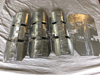

Only changes to Mike's design was a 1/8 wider center strap since there was room. And I added a weld nut on the under side of the tray between the mains. This will be a place for someone to bolt a strap to if they want to run a brace over to the pick up tube. If not it is out of the way and can be left unused. I have seen too many tubes break off at the threads or have the threads badly bent. This may be a help to someone if they want to use it. I'm not going to put another pick up in my own stuff without a strap/brace.
More to come! :D :D
great attention to detail

I think you mean trays. Man, these look great, Rick. Thanks again!
Next time I pull a pan, I'll plop one of these on...

I got the new bolts for the mains back from the machine shop and plan to have some more of the trays finished and ready to go early next week.
Once l get them packaged up and ready to ship out, I'll contact each of you with a final total.

I am getting ready to start sending out some trays and scrapers as I get them final cleaned and deburred. Below is the list of people as I have it. Please correct me if there are any mistakes.
*** Remember these were all drilled, cut, bent, welded, then final cut and deburred by hand. You need to fit these to your engine. They will need tweeked which may include twisting, bending, trimming...etc. I think you get the picture. You need to double check them for any burrs or weld slag that may have gotten by me. I did my best but there is a lot of hand work on these. So look them over to be safe.
