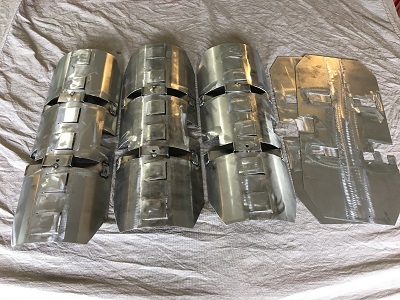

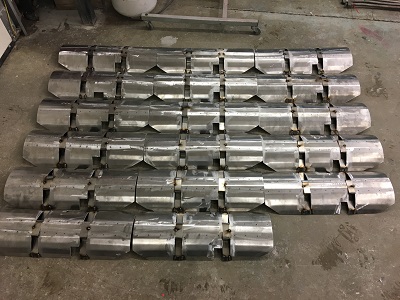

Trays are coming along. 17 have been welded up. 3 more to go. I started final cutting and deburring, so In a week or so I will likely have some ready to send out.
Only changes to Mike's design was a 1/8 wider center strap since there was room. And I added a weld nut on the under side of the tray between the mains. This will be a place for someone to bolt a strap to if they want to run a brace over to the pick up tube. If not it is out of the way and can be left unused. I have seen too many tubes break off at the threads or have the threads badly bent. This may be a help to someone if they want to use it. I'm not going to put another pick up in my own stuff without a strap/brace.

great attention to detail

I think you mean trays. Man, these look great, Rick. Thanks again!
Next time I pull a pan, I'll plop one of these on...

Those look really nice!
