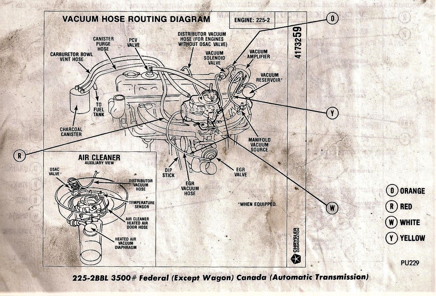

| Author: | rich006 [ Tue Oct 06, 2020 3:05 am ] |
| Post subject: | Re: Replacing Holley 1945 with Carter BBS |
Matv91, could I ask you for the rest of the EGR section from that manual? The donor car didn't appear to have the vacuum amplifier but maybe I just didn't know what to look for. Or maybe it was pulled long ago. |

| Author: | matv91 [ Thu Oct 08, 2020 4:55 pm ] |
1979
