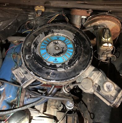

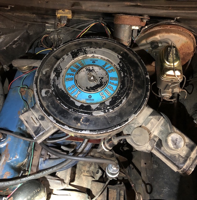

It's alive!
I was finally able to try starting the engine up with the AFB on it. It ran terrible at first. I tracked it down to a wicked vacuum leak caused by an incorrect gasket in the adapter stack I had to use to mount the four barrel on the two barrel intake. Once I replaced the gaket the vacuum leak went away and it ran much better.
The carb is extremely sensitive to adjustments of the idle mix and curb idle screws. A 1/4 turn makes a big difference. Vacuum never got above 16 inches at idle, but the throttle response seems crisp and it idle smooth in gear and out.
Unfortunately, my meager welding skills proved insufficient for me to weld the O2 sensor bung to the exhaust pipe without leaks. So, for now, I don't have an air/fuel gauge to fine tune the carb, but it seems pretty good, and it is definitely better than the old BBD it replaced. I even found a four barrel air cleaner froma mid 80s 360 that fits the AFB and the Super Six air cleaner lid
Thanks for everyone's input, especially matv91 with the excellent info. I think I have this carb installed and working. Once I get the O2 sensor sorted and get the air/fuel gauge working, I might be back for more tuning help.
