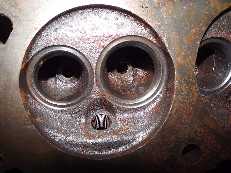

PostPosted: Sat Feb 13, 2021 6:32 pm
Posts: 136
Next, here is a really good chamber closeup. Very evidently an as cast closed chamber.

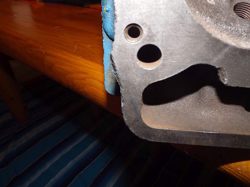

PostPosted: Sat Feb 13, 2021 6:33 pm
Posts: 136
Here, I show the locator hole for the dowel pin. The as cast factory chamfer around the hole. No milling. Not even evidence of a broach or rock cut.

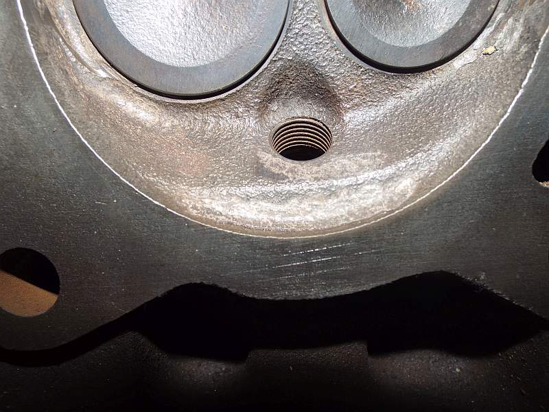

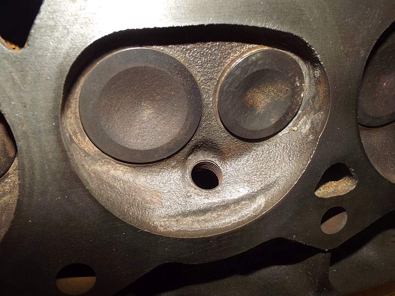

PostPosted: Sat Feb 13, 2021 6:35 pm
Posts: 136
Here is a comparison between the chamber "smiles". I thought at first the closed chamber smile was a little smaller, but looking closer, I believe it's the same. I'll let yall decide.

That's it for now. I think beyond a shadow of a doubt, the head is as cast from the factory. I'll have some chamber numbers tomorrow when it's a little warmer out.
PostPosted: Sat Feb 13, 2021 6:50 pm
I agree the chamber is as cast.

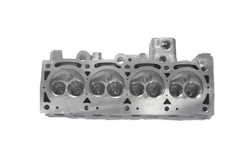

Too bad they didn't continue down this research path, or rather - the engineers probably tested several different shapes. The original 2.2 had "bathtub" chambers, then the chambers changed with the 782 casting with more quench - for emissions reasons - not particularly for high performance. With port fuel injection the fuel distribution can be more equal so that there is less chance for pinging. With the '70s single carbs, quench probably didn't help as much as it could a dozen years later. This is the #782, looks better than what that slant six head has. The last of the TBI 2.2s actually were downrated in hp.

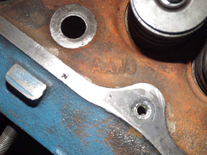

PostPosted: Sun Feb 14, 2021 4:10 pm
Posts: 136
More pictures of different castings and whatnot on the head. Here is the "famed" AAWJ casting. Big whoop. I've seen people slobber all over it, but IMO, it really means nothing.
