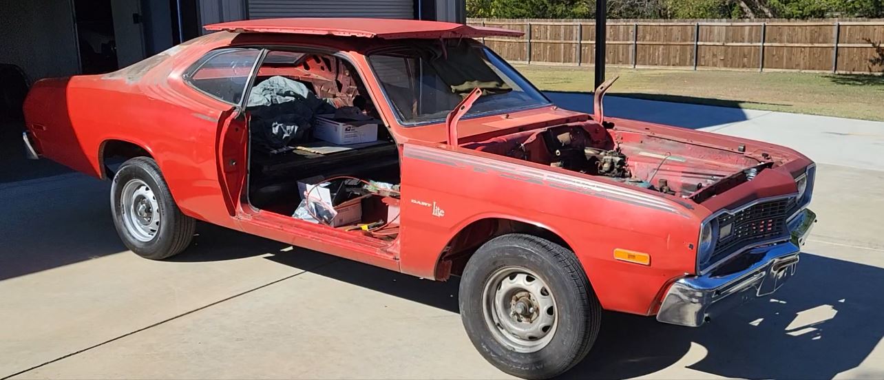

I thought I would post some progress on the Lite.
Since the last posts, I have become a first time Grandfather.
So I am now a 70 year old Granddad.
At least it was before I died!
The drivers side glass was wasted from where the palm tree grew while it sunk into the ground.
You can't find new clear glass.
So I had to buy all new tinted glass.
I got the rear pop out windows changed and the gaskets replaced.
Sound proofing on the roof and rear floor boards.
New ABS headliner.
New door cards.
Front seat recovered.
New dash pad.
New door weatherstrips.
Door hinges rebuilt.
Patched the front floor boards with some small patches.
Steering column rebuilt.
New fuel tank.
Replaced all the rear carpet around the fold down rear seat.
Engine, except head, back from machine shop.
Block decked, .060 bore, polished crank.
Oregon 346 cam back with refaced lifters.
Mopar 2 barrel intake and progressive 2 barrel Holley 350.
Remained 10 inch clutch pressure plate.
Those are the big items, there are a million small details.

Author:  Dart270 [ Fri Apr 24, 2026 6:04 am ]
Post subject:  Re: 1976 Dodge Dart Lite
Sounds like sweet progress, Stan! Keep at it. I'm sure it'll be a beauty and a smooth and strong runner when you're done.

Author:  Greg Ondayko [ Fri Apr 24, 2026 6:29 am ]
Nice Stan.
You have done a lot there.
Will this be a city and neighborhood cruiser when you are done with it?

Author:  hyper_pak [ Wed Oct 21, 2026 8:04 am ]
Not much progress since April.
But I did get my 10 MPH crash bumpers pulled in because all the plastic filler parts were gone due to sun rot.
So now I have no crash protection.
Working on small patches on drivers inner fender where the battery had corroded some metal.
Then I will paint the inner fenders so the slant will look like a diamond in a goats ass when you left the hood.
All the tinted glass looks great, big improvement over sand blasted clear glass.
