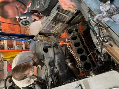

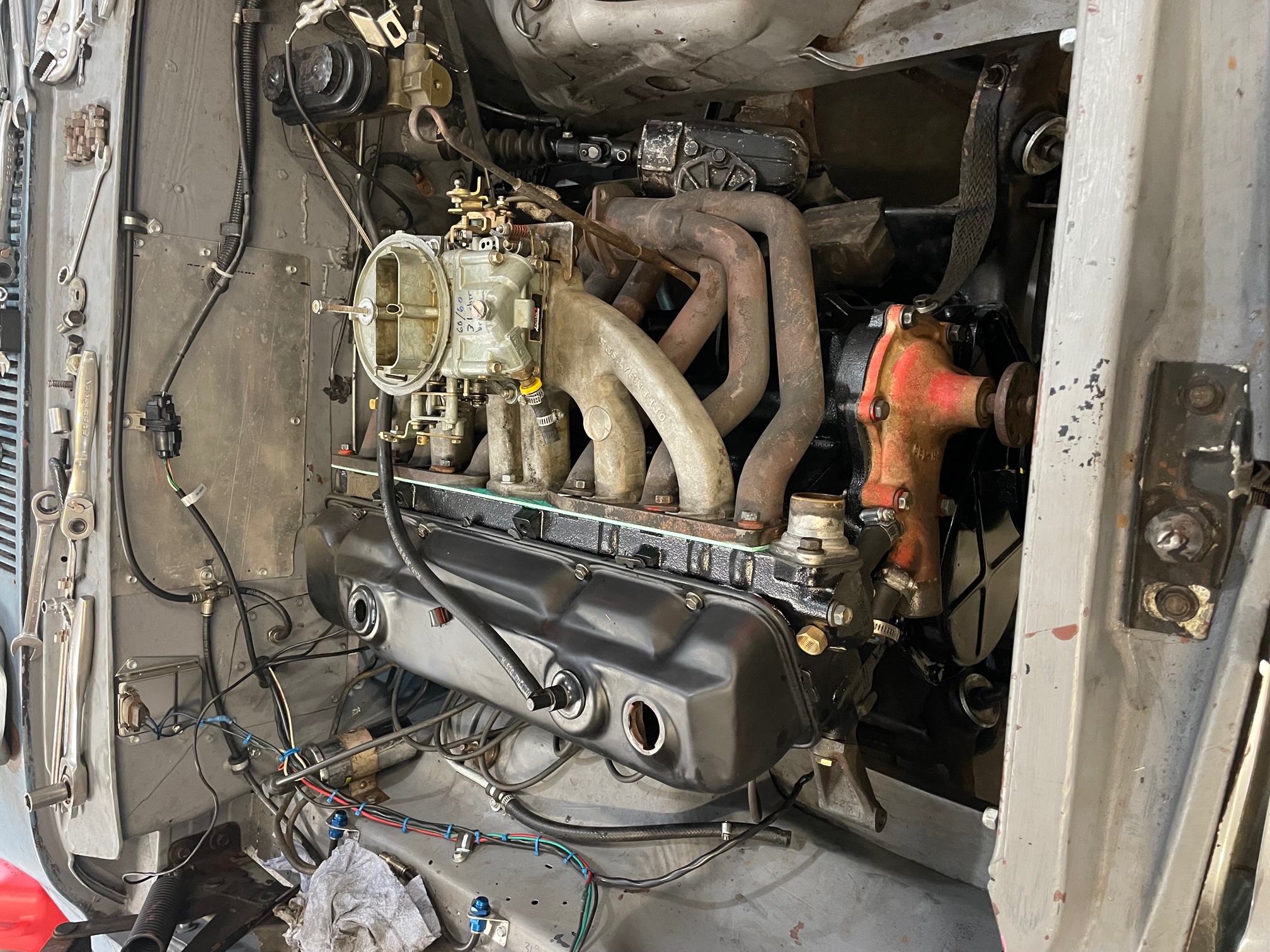

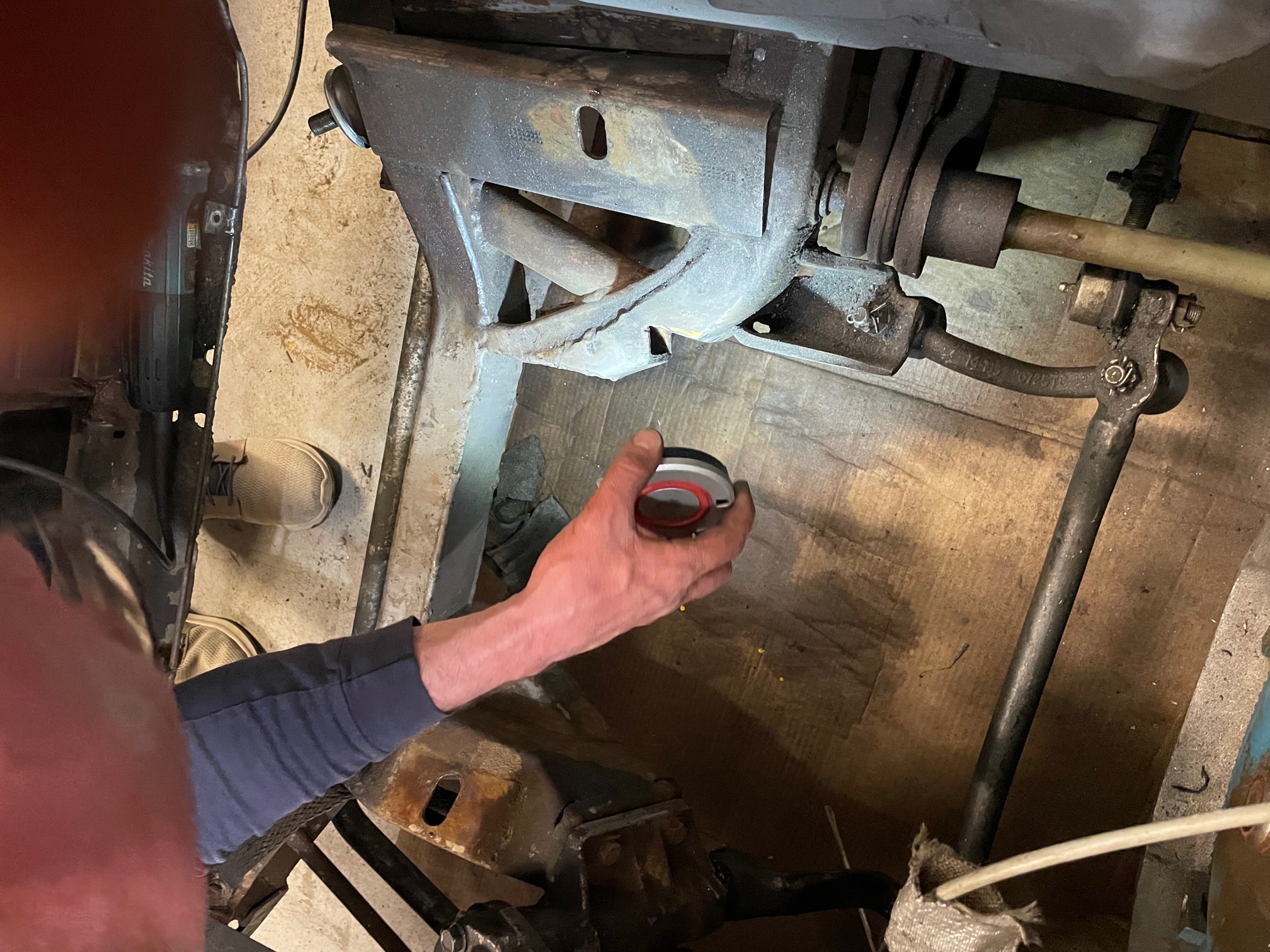

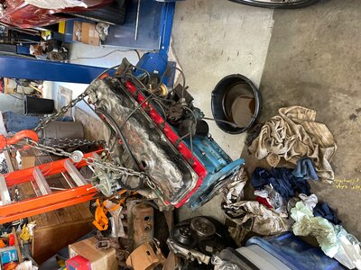

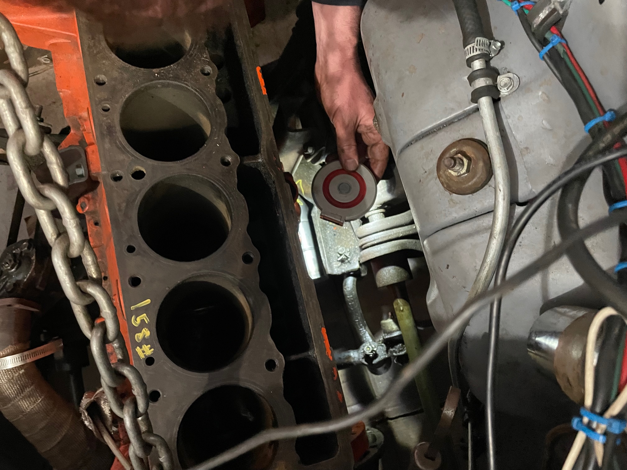

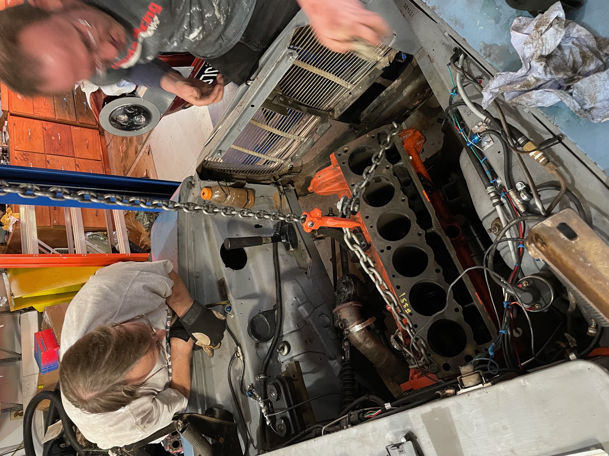

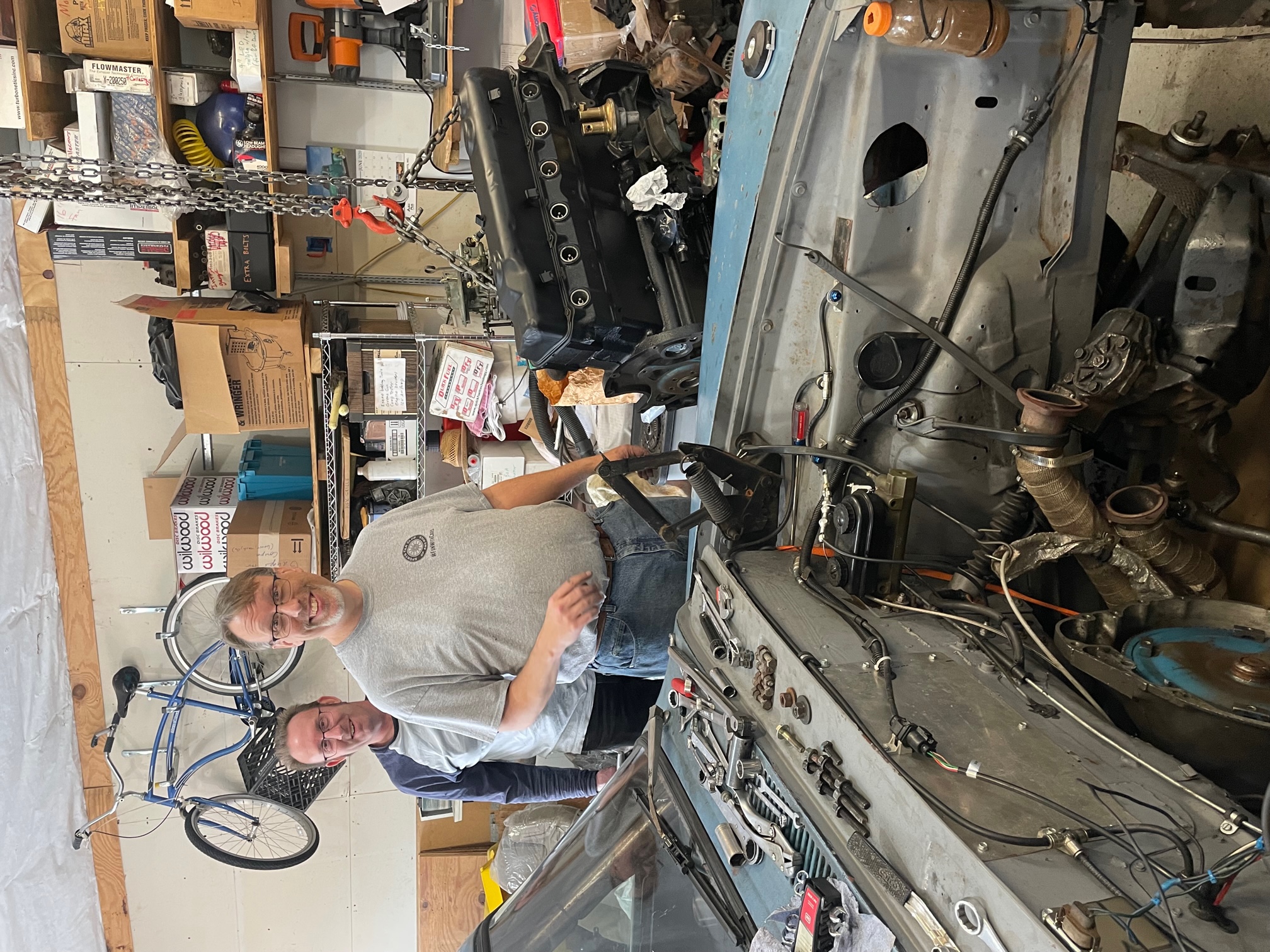

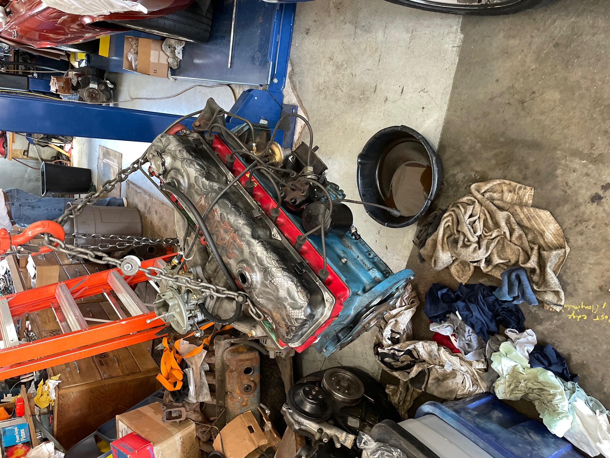

Brian, Lou and I had a fun and productive ToadRacer development weekend at the Madsen Skunkworks!
We removed TR Slant 1.5 (original engine raced at Sebring with a slightly improved head raced at NCM).
And installed TR Slant 2.0 (all new engine with much better head, cam and more compression) with same induction setup for now.
We got it running and backed down the driveway and back into the garage. Tuning with the new power to commence sometime before the race at CMP in late April.

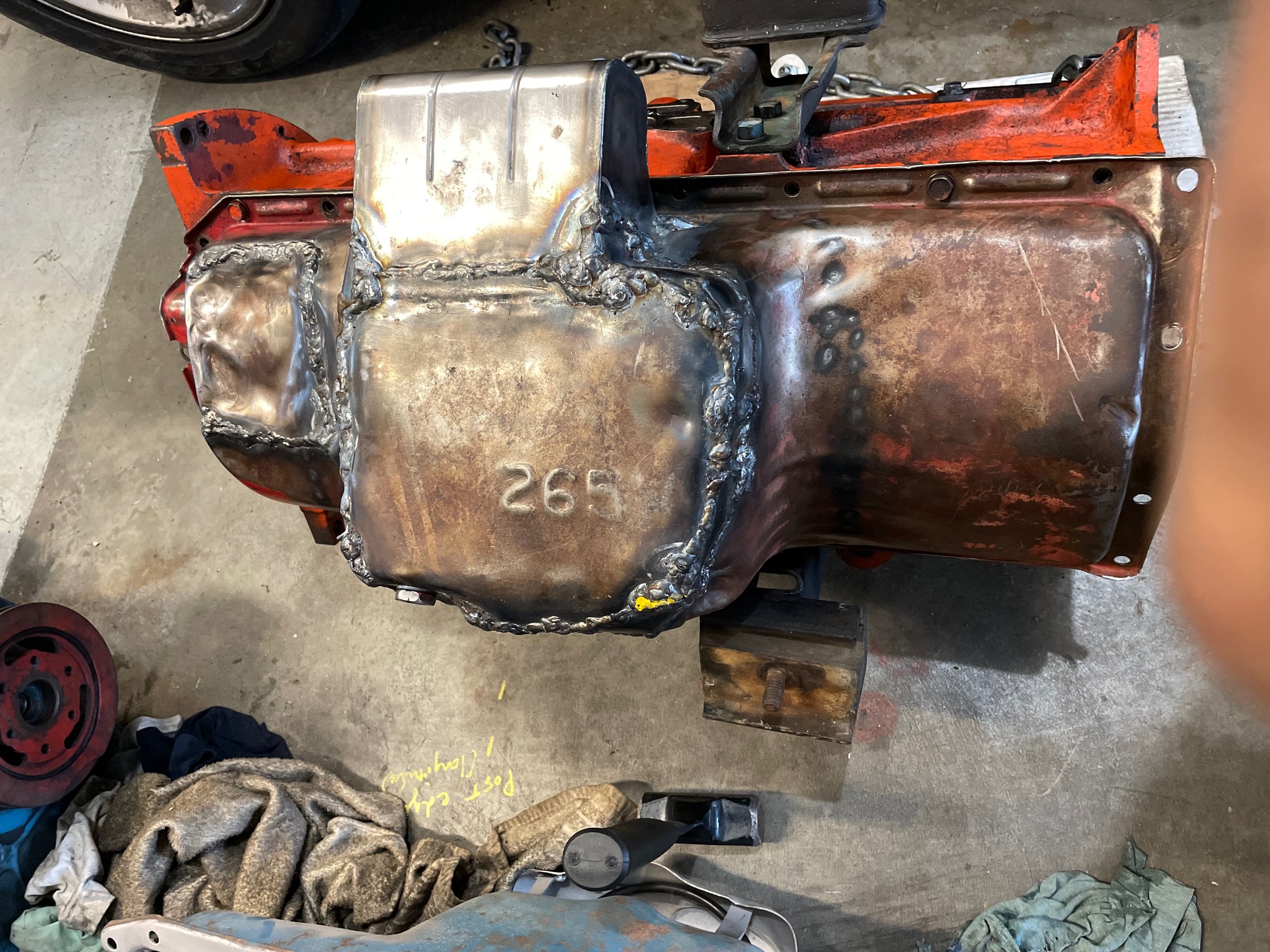

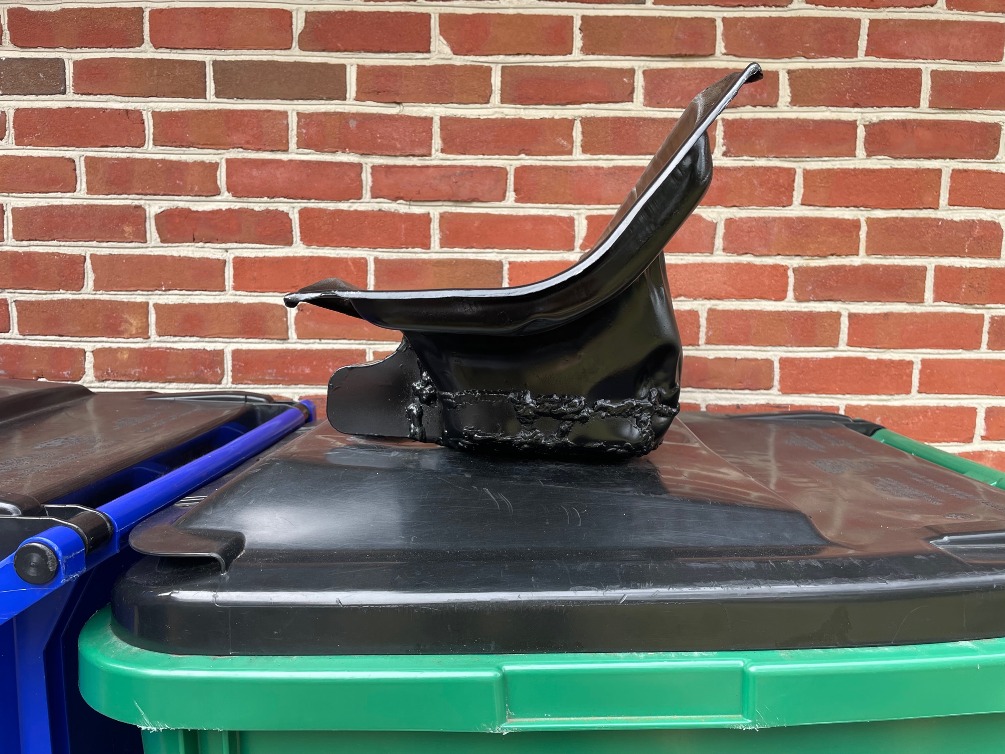

Lou built a new oil pan that is dropped about 3/4" with a Speedway kick out for increased capacity and ledge baffles for better oil control.

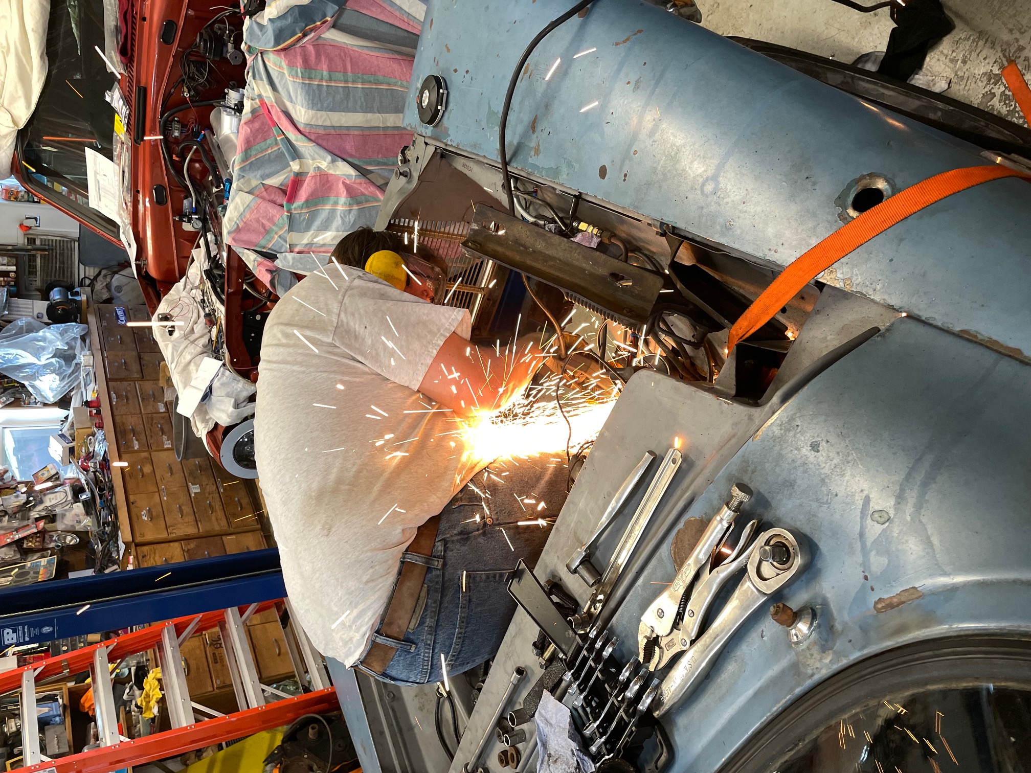

The kick out required us to notch the K frame just a smidge near the idler arm.
Pictures are worth a thousand words, so...
[[ WARNING!!! "Taco Pics" attached. My phone just decides willy nilly which photos to rotate. I ain't fixin' it again... :roll: ]]

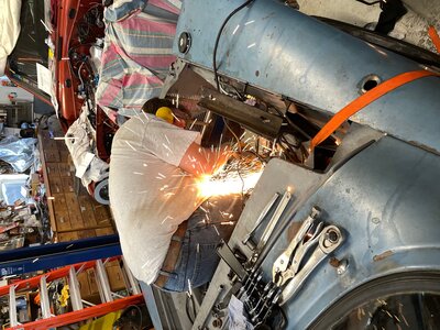

1. No making fun of Lou's welds! He's a Chemistry Perfesser, not a welder! We leak tested the oil pan and called it A OK. :wink:
2. OSHA (and the fire department) were on stand by during Brian's Notch Notchy Surgery... No animals were harmed in the filming of this episode. :wink:
TR Slant 1.5 removed (Now Backup motor)
TR Slant 2.0 installed
Brian "the Butcher" Mimken
:shock: :shock: :shock: :shock:
Fun!! :mrgreen:

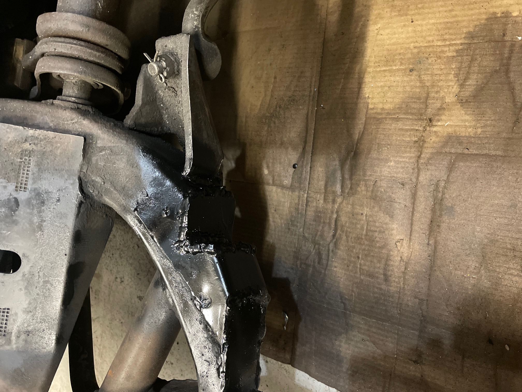

Another sneaky little upgrade that will give us a huge advantage in handling so we can out corner the other cars on track are these super trick lower control arm reinforcements Genius Joe came up with.
You may have seen other products similar to these that use thick metal plates that require welding and add a huge amount of sprung weight to your front suspension.
These ingenius (told ya Joe was a genius) inventions are not only lighter and do not require welding, they do not decrease your ground clearance like other products. It is believed that the chemical composition of the Vernors Ginger Ale reacts with the aluminum in such a way as to add great structural integrity to the aluminum alloy.
This is just another of the Off-Kilter Racing team great ideas that will help us to DOMINATE at CMP at the end of April.
