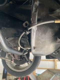

Hello Folks,
I'm sorry for the delayed report but here's the Toadracer progress in a nutshell:
Transmission:
B&M shift kit including bands adjusted
New shift cable (routed under the bellhousing this time)
Kickdown clevis flipped for floor clearance
Trans temp sensor installed in line pressure tap
Needs: finish fill and test, cable final adjustment, install and wire gauge, shift cable heat shield
Front end:
New upper and lower ball joints, tie rods, and sleeves
Installed washers on LCA pivots
Idler removed for rebuild
needs: rebuild and reinstall idler, sector support bracket welded (designed to bolt to later K-frames but this one is boxed in that area), alignment
Rear axle:
Tubes shortened, welded
All new bearings and seals installed
e-brake deleted
needs: finalize backlash, weld spring seats (set pinion angle), longer studs, modify shock mounts/spring plates, install and plumb, measure for driveshaft length
I removed the exhaust for work access so it just needs to be bolted up.
I'll try to upload a couple pictures for proof :wink:

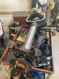

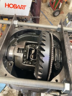

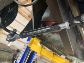

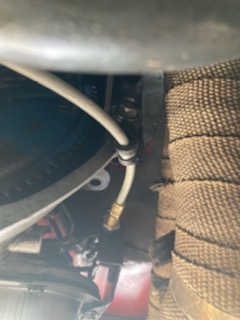

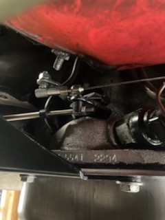

PostPosted: Mon Aug 29, 2022 8:04 pm
Posts: 831
Location: Tompkinsville, KY
