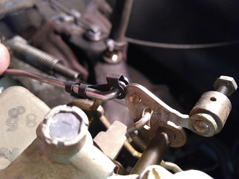

Here is the best photo showing the 2 affixment points on the choke plate...one for the pull off and one for the fast idle cam and none for the 1234 electric choke. The choke rod is just laying there in the photo. Between Reed and I, we will get it hooked up soon and thank you for the assist.

Ah. You have the choke thermostat rod in the hole for the fast idle cam lnkage and someone has straightened out the eyelet bend for the choke thermostat and affixed a manual choke clamp to it. You can try bending the eyelet back over so it looks like the one I posted.
Well, this is reported to be a NOS carb, never been mounted or messed with which leaves me doubtful the manual choke affixment was added. It looks and feels completely factory, along with the mounting point for the manual choke cable. I am using a manual choke right now and wish to maintain capability of such for future reference (back up).

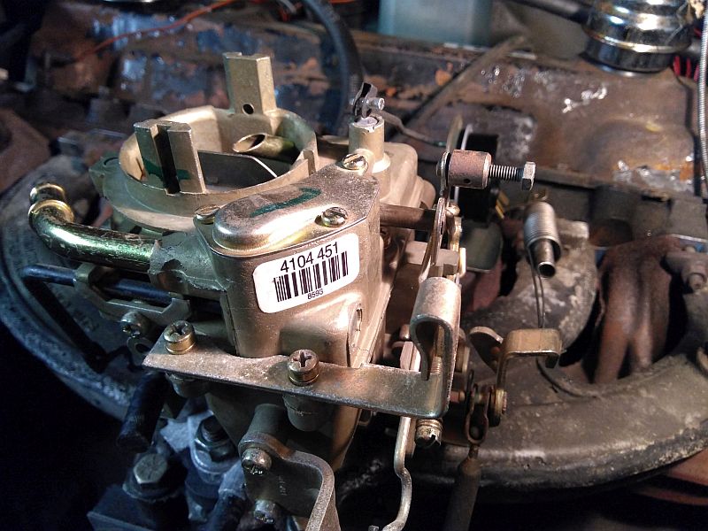

Here is another view, showing the manual choke cable mounting bracket and a wider view.
I see what you mean about the choke plate looking like it was bent, however.

The report of it being a NOS carb is wrong. That is, at best, a remanufactured carb. That sticker was not put on that carb by Holley. Someone has definitely messed with that carb because the eyelet for the choke thermostat has been bent 180 degrees out of alignment. You can clearly see the waves in the flange for the fast idle linkage where the 90 degree bends used to be. Someone added the manual choke cable clamp, and mangled the carb doing it. You will not be able to run a manual choke and an automatic choke at the same time, and the automatic choke will not work with that bent eyelet.

I don't want to use both manual choke and electric choke at once, but I would like to maintain the capability to revert to manual choke if needed in the future.
Hence, the reason I think the choke plate you offered is a great solution to get the 1234 up and running without rebending (and possibly breaking) the *mangled* plate, which hadn't occurred to me before this minute.
