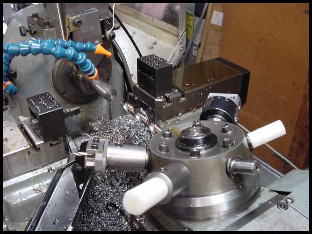

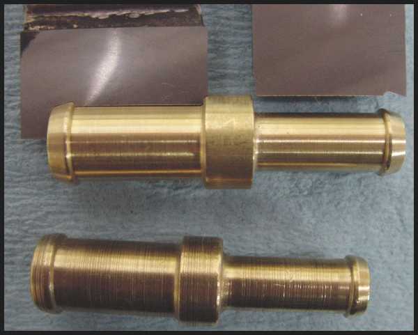

I thought I'd take this first effort at starting this thread again to show what I've been up to that drew me away from the project. Since some of you seem to show some interest in my business ventures I will waste this post discussing that just a little...for those bored by anything other than the suspension I will post about that in a few minutes and you can ignore this part.

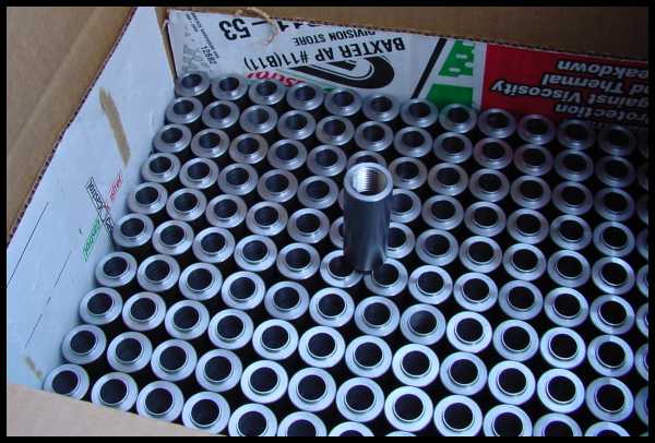

Things didn't turn out well in my efforts to help my buddy out of his predicament. I was able to ship a couple thousand parts, but my machine just couldn't do what was needed. My turret lathe is called a super precision machine for a reason. Even though it can work on bar stock up to 1" diameter, it wasn't designed with the power of a true screw machine. So parts that take 23 seconds each on a screw machine, can take 1-2 minutes each on my machine, because I just can't push the big drills very fast, even if my hyd seals weren't leaking. No, the machine is designed to make precision small parts with tolerances in the tenths of thousanths. Usually at a pace of under 30 seconds each.
So I just couldn't make them even as fast as they use them...
The worst part, was that I took the job making the steel parts knowing I probably wouldn't make much, but the third part that needed making was brass and would be a recurring contract for so many per month, that would bring in some real cash.
Soon after getting the brass job of 12000 units, with 5000 every two months thereafter, they called to say that Frieghtliner had redesigned the assembly, and would only need 5000 and then they would never need them again...this after I took on the steel work.
The company that hired me is a family business, although a large one, it is still mostly family running the show day to day. In the middle of my trying to make parts, the father of the owner died and the family closed up shop and left town to deal with the funeral. In the mean time, F-liner was getting upset that they ran out of brass parts...which I didn't know as I was trying to make steel parts.
Long story short...I get a call saying "Karl...we need brass parts now!!!" So I stop and stay up 24 hrs to set up the brass parts...the next morning I just get 2000 pounds of brass delivered, 10 minutes later the first good part rolls off the machine, and then the phone rings...F-liner told them to go to hell only using worse language, and would not take delivery...so I got screwed.
They are covering my tooling costs and some material restocking fees, but I basically lost about 2 grand over a deal I should've made $5k on. Some of that 2k is tools I bought that can be used later or are nice to have anyway, but I wouldn't have spent the money if I'd known. Some is just lost forever as a business deal gone bad. I also have 60, 12ft lengths of steel in my garage at about $22 per stick I need to find a buyer for...
And of course, I lost mega hours of labor I could've spent actually making money instead of losing it. So I started in bad financial shape and now it's worse...not to mention the hospital just billed me another $191 on top of the $250 already paid for 5 minutes in the ER....Hence my outburst that led to me breaking my toe!!!
So that is why I haven't been working on the suspension, and for the last two weeks have been chasing every kind of work I can...been building decks, doing graphic design, working a booth at a railroad historical society gathering, tuning hot rods...etc. Even had to work on a Chevy...yuck...although it was a beauty...12 second 64 Chevelle that I set the pinion angle for him with his new adjustable rear links.
So here is a picture of the setup for some of the steel parts I made...
Here is a box with finished parts being loaded to the brim to ship...
This box with 300 parts weighed 60 pounds, exactly how much I lost last year riding my bicycle like a maniac everywhere. Sure was a good reminder to keep the weight off, I can't believe I used to lug that with me everywhere...
Last is a picture of the $450 worth of custom carbide form tools I had made so I could make the brass parts. Just a simple hose adaptor. The nice one is my work, the lower one is the crap produced by a large company whose only concern is they not be rejected and are profitable.
I couldn't bare to send ugly parts like that to anybody. it is a surprisingly complicated proccess to form those parts do to the large surface area that needs cutting in one shot. The tool on the left is the first to cut. I feed the material out just enough so the tool is right next to the face of the collet holding the stock...so that the stock won't bend instead of cut. This tool has the extra meet at the left side so that it also faces the stock so it can be drilled on center, else the face might not be in good shape from the parting tool that separates a finish part from the stock at the end of all operations. Does that make sense? In other words, you must clean up the surface at the front before you drill it.
Then I feed the stock the rest of the way out, so that the second form tool comes in from the back side also close to the collet. Then I drill the center hole all the way thru, then the parting slide comes down and the part separates onto the parts shoot and falls into a can...about 38 seconds each...K-ching...usually...
Its not all bad...I enjoy this work so it was sorta fun other than the financial crud...second, my machine is repaired now and working fine...ready for future profitable work. Three...we wouldn't have found the deal on the injection molding machine had we not been involved in this venture.
The Dutra disks portion of my assembly can be easily made on my machine, further reducing the cost of a kit should I decide to make said kit.

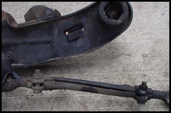

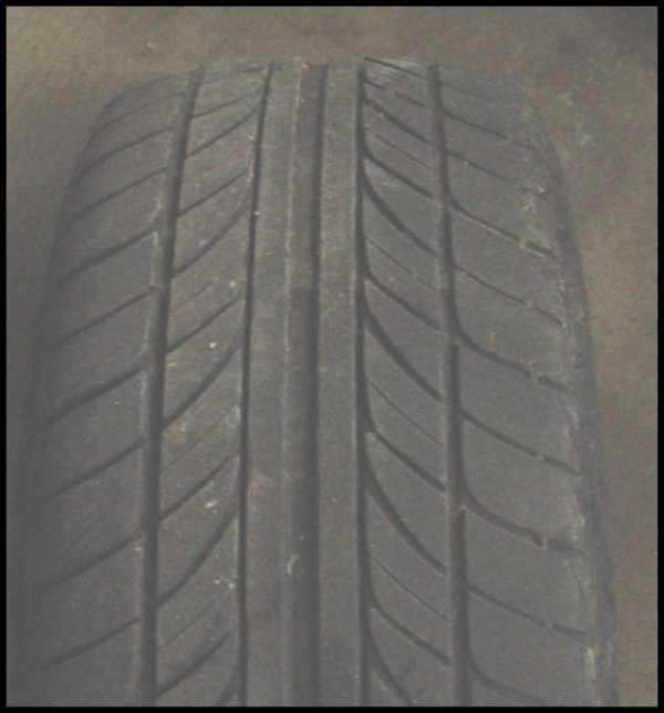

The other reason I tore into it is I parked in such a way the other day that I could tell my tires were wearing badly...and they are almost new!!!
On the inside edge you can almost read the bars already. I guess the excessive neg camber, bent tie rod, and worn out bushings really are bad for tires afterall...who'd a thunk it!!!!

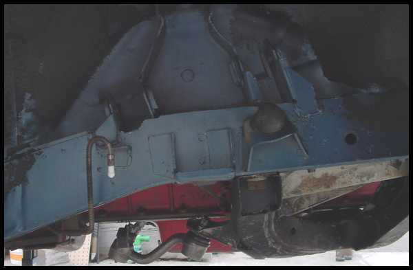

I got out the pressure washer and spent two gas tanks cleaning everything I could, front to back.
The front wheel well area cleaned up pretty well aside from the undercoating.
No signs of stress or cracks anywhere. Oil pan has hit things a few times though.

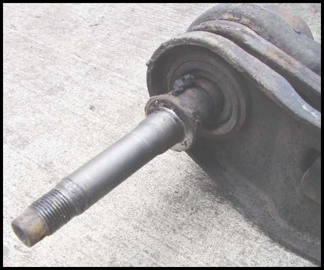

The two main things I found of interest were the driver side tie rod and the lower control arm bushings and pins on both sides.
First the tie rod...
I'm completely embarrassed that I didn't notice this before and fix it with heavy duty units as some recent threads discuss. Here I've been driving mountain roads to and from SF how many times this year...I wonder how much fuel economy and drag times are affected by a front end plowing the way mine has been. I can't believe I have been so negligent.
Second was the horrible shape of the LCA bushings...now this I could just assume and had...and I was not surprised by what I found. Although it was worse than I've seen on any of the Mopars I've worked on.
I can't believe that people actually comment on how well my car handled...talk about negative caster...geeze. I didn't know the LCA had been secretly relocating itself rearward while I've been developing ways to move it forward.

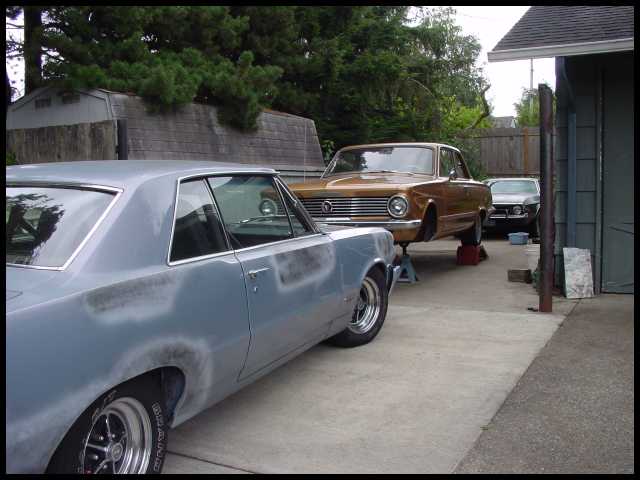

PostPosted: Wed Aug 31, 2005 9:41 pm
Joined: Tue May 17, 2005 8:05 am
Posts: 176
Location: Portland OR
Car Model: 1964 Valiant 2dr post
Well guys, the bad news is it looks like my car will be sitting in the driveway as shown in picture above for at least eight weeks.
The good news is things have gone really well here in North Carolina...Even though I have never been near machines as big and powerful as these, within a few minutes of showing up I had already stuck my head inside, found what was wrong on one of the machines, ground a new tool, and put it back in production...and it wasn't even what I was brought here for...the machine operators don't know how to grind tools correctly and they wear out or break quickly, and the clutch mechanisms for the tapping operations are tricky to adjust.
By the second day, I had installed the new machine they bought (rolling it into the shop on round bar stock like the Egyption Pyramid builders), and repaired the one they were going to junk cause they thought it was history, so now instead of two 18000 pound 6 spindle screw machines, they have three. And just in time for a large increase in orders.
I am making mucho bucks, being treated awesome by everyone, had most everything paid for, given a rental car (a chebby HHR)...taken out almost every night...and now they want me to stay for a month or two and completely rework the machine shop for efficient production. They are even flying me to SF to visit my Mom then bringing me back, so I won't even be home till mid October or later.
After the shop is running smooth they want me to machine parts for the Funny Car. When I get back from SF they are putting me up in a house of my own just down the street from the factory and loaning me a car...geeze, how life can switch gears...they have even given me orders for plastic parts to mold on my new injection machine when I get home...
Perhaps I can build my slant as well with the newfound cash going into my account.
Its not all rosy though...its hard work, and messy, and humid as heck. And today the machines were acting up with all new problems so I had to chase fires to keep parts going to the welding shop...but I'm enjoying myself and the attention that being the hero brings. These machines are pretty scary to be near when they are pumping finished parts out the door. And I only brought clothes for a four day stay...
Anyway, I won't be able to finish this for awhile, so you'll just have to bare with me till I get home.
