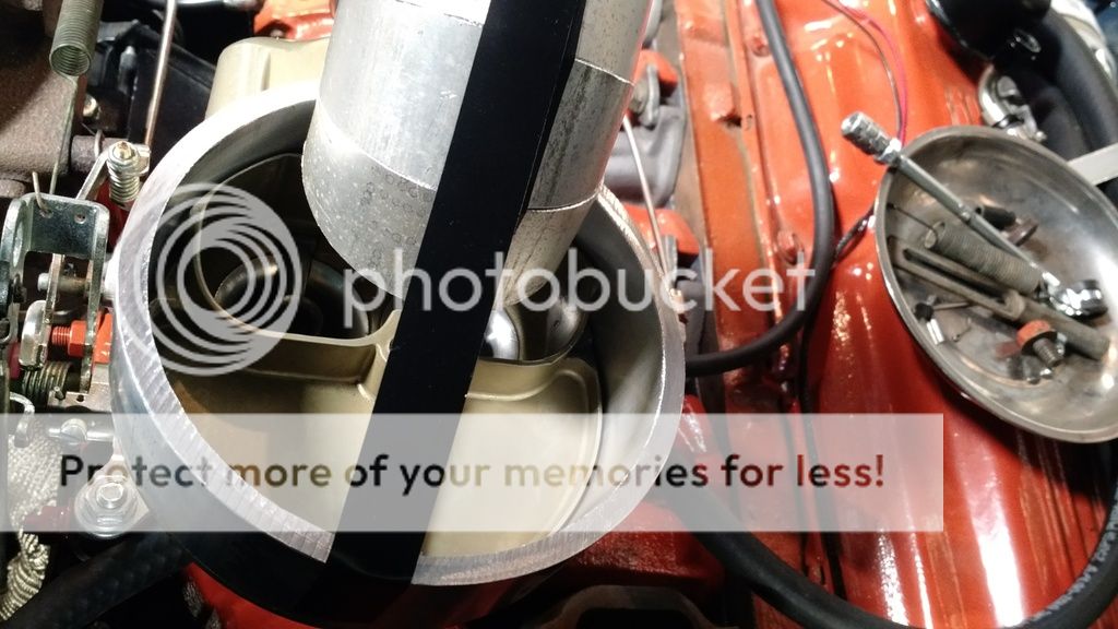

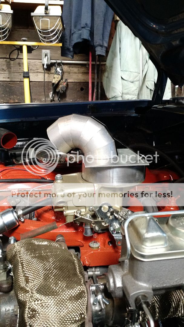

So back to the carb hat.
I was able to find some aluminum pipe that was the perfect size to fit around the carb.
Now for the inlet, I thought plumbing it on the side as shown would look better as well as swirl the air towards the front of the 2bbl carb.
Anyone see a downside to this design?

I would just buy a carb hat the aero would be much better in a formed hat specially a serious hat like extreme velocity. Love mine!
If your making one to save money or just to show enginuity then go for it! I don't see a problem with your swirl idea I would think it would work fine.
Kevin
PostPosted: Wed Apr 20, 2016 8:43 am
I would Not swirl the air if you want the carburetor to function properly. The air needs to slow down and turn. If the air is swirling around the boosters they will not work correctly. I would expand the pipe to an oval and bring that into the large pipe opposite the carburetor venturis to slow the air and give it room to turn.
I hear what your saying.
So with what I have so far, I could do as you suggest;
make the opening of the hat towards the back of the motor, and have the piping come around the hat as almost a 90* towards the front again. So its pushing the air towards the front of the carb/venturis. That makes sense to me, just more fab work.
OR another idea I was thinking...
Keep what I have, and add a flat plate in the hat, to block the air from coming around again where the air enters the hat. If that makes sense... does in my head.
I like the look of this better, but doesn't mean its the best option.

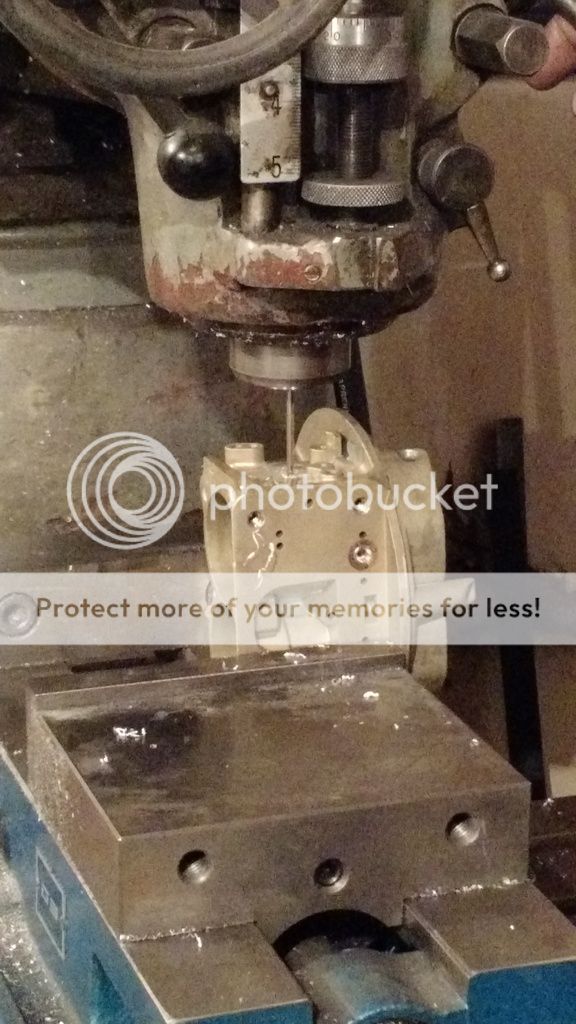

I was able to get some work done on the Carb tonight.
Wanted to get the hole drilled for the BRPV.
But when looking at the ones other have done, and all Holley carbs from what I can tell, Its an easy task.
This Demon carb has a shoulder, that then slopes down on an angle, where I'm supposed to drill... Not likely!!
So I was lucky enough to meet a guy not that long ago, who is close by and has a mill!!
There is no way I could have confidently done this myself with a drill or even a drill press.
We used a 1/8" bit to go all the way through. Counter sunk the hole with a 3/16" and found some oil copper 1/8" oil line that fit perfectly!
Worked awesome, and just needs some JB Weld to finish up that portion.
Next would be making the cap for the PV, to reverse the spring, and buying a mill!
Think I would mill everything.

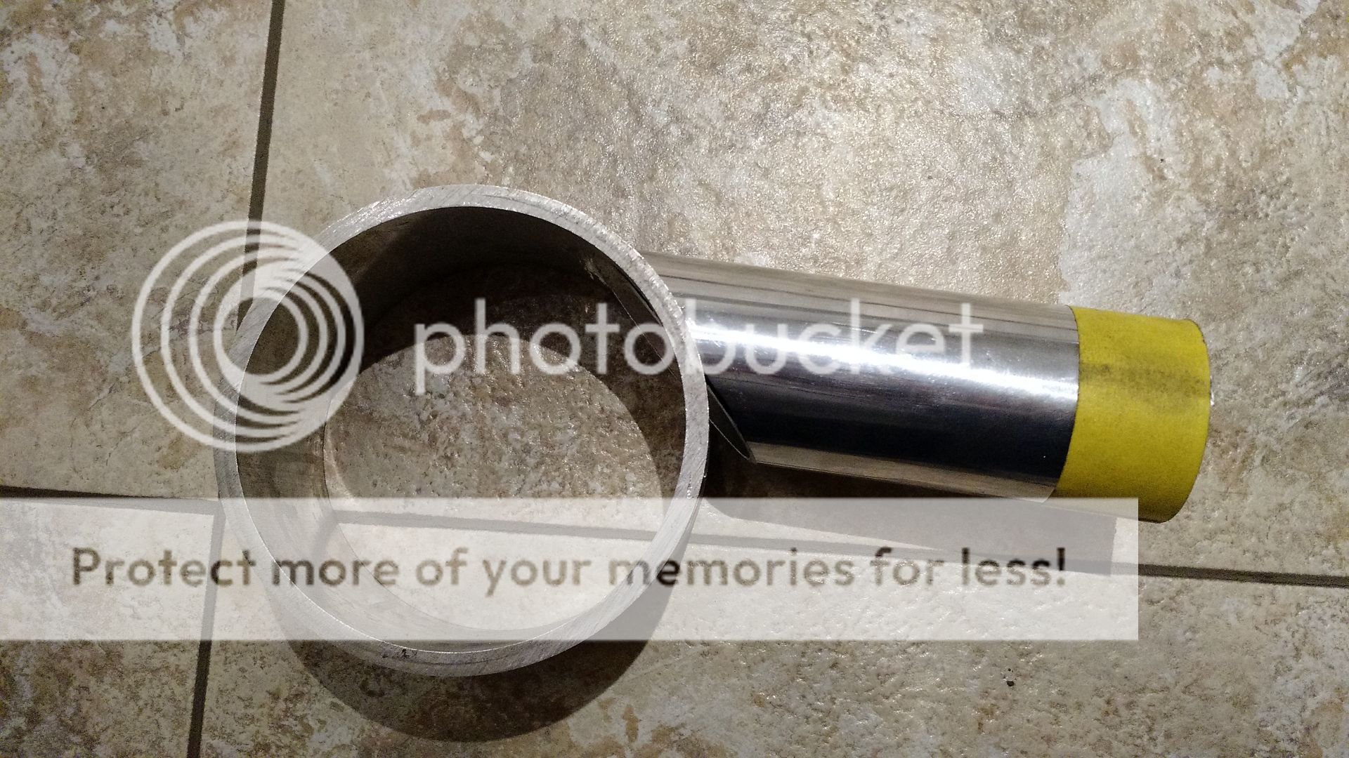

So after lots of thinking and searching the web for other carb hat ideas.
I think I'll try and go the route Joshie225 had suggested, forcing the air straight into the Venturi's
So I did some mocking up for the carb hat, for an Idea I thought might work.
Took a piece of 5" pipe, cut down to 1.75" high.
And cut some 2.5" pipe into wedges at 11.25*.
From the photo, this is what I was thinking of doing...
(As of writing this, I think photobucket is having some issues with their site, photos don't seem to be loading. Here is the link to the Library for the interm, that does seem to work: http://s1039.photobucket.com/user/mopar ... t=3&page=1)
And looking down from the top, the air would come down, straight into the venturi's.
The only problem I ran into with this design, is the hood would not close.
BUT, If I made the 5" ring shorter to 1" high and kept the 2.5" pipe the same, it would clear.
Since I'm running a 2bbl, I only need to worry about the air coming in the front section of the hat. I would prob even add in a flat plate just behind the choke horn so all the air is completely directed to the front.
My only worry is, that the 2.5" pipe that's over top the Venturi's, is literally only 1.75" above them, and only catching half of each.
Not sure if this will cause any issues...
