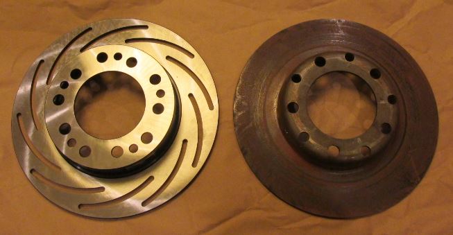

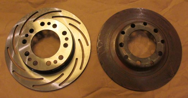

I have been working on the front spindle issue for quite a while now.
Last week I sent all the ball joints and Mustang II spindles back to Speedway and Jegs.
I just could not make any of it work with my old parts.
At first when I spoke with Strange they said they had no parts for my old stuff.
After talking with one of their tech guys I did find a rotor I can use.
So I ordered them and it looks like I am in business.
They sell a rotor caliper for these rotors and I would need to build mounts to my spindles.
I can use my spindles and front end parts. I just need pads for these AIRHEART calipers.
The worn out rotors were the problem that started this whole process.
Here is the old rotor next to the new rotor.

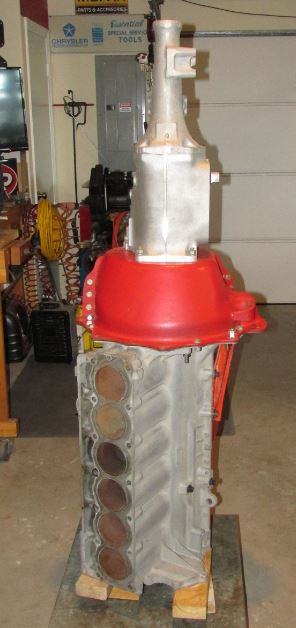

This week I almost finished the mating of the Lakewood Bell Housing to the block.
I have gotten the Flywheel, thanks Will, surfaced and mounted for fit.
Using a McLeod disk and a DC Green cover PP.
I will be using a Hyd throw out bearing.
Just need to fit the starter and it will be done.
Here is the complete mock-up.
Next to roll all this under the frame rails and trim the mid-plate and start constructing the front motor mounts.

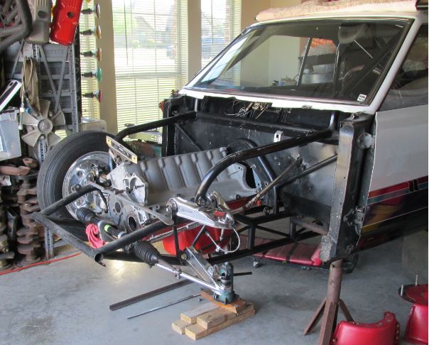

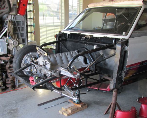

Working on engine and bellhousing placement.
Took the front end off for the first time, that is sweet to work on stuff.
Mid plate is proving to be a challenge.
Found 92 pounds of lead under the fuel cell.
So there is a 10th, right?
Little bits at a time.
