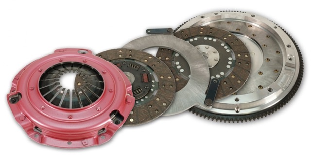

Here is what we are hoping for.

Just saw this thread....as a couple comments:
1) The stock bell is pretty small so the clutch better be, also.
2) A QT bell is much larger than a stock bell. I was able to fit a 10.5" clutch and 130 tooth flywheel in the QT, and the stock bell was 'no way'.

Thanks for that info. Width is likely not the issue though that is good to know. The taper from the motor flange back is where the question is. The smallest possible bell is the 3 speed one. RAM has it for development on site now. I did let them know that if this doesn’t work, we can send out a 4 speed bell for fitment.

The QT bell looks to be substantially larger than an OEM 3 spd housing, at least from eyeballing it.
Seal em up with plexiglas and grease / Silicone and then measure the amount of water they take on...like cc'ing a head.
That will give you an idea of volume at least!
Spray it with cooking spray, seal it up and fill it with expanding foam insulation.
Actually, this may be a good option if they need the cast bell... :shock:

I have nothing to reference a QT against a 3 speed bell, so my concern mentioned earlier maybe for naught as the consensus is from what many state here a QT is larger, and therefore its case closed, as to any fitment issues. My offer still stands if reasons arise that it needs to be considered for fitment. Additionally, if as mentioned its out of production, its a lame duck solution and shouldn't control Ram's solution IMO, but I do hope the QT can be a usable part regardless in this project, in that I kinda like my feet. :D

I'll state this another way...I can't think of any reason the QT would not work. There could be a reason that is eluding me, though. But I think not.
I haven't read this whole thread lately but I think it said the Ram package would include a new flywheel? The QT, as we've discussed in other threads, comes with the starter location for the 122 tooth flywheel, so that would not be an issue.

Took my 4sp od transmission and aluminum bell housing to ram clutch today so they could make some measurements looks like things are getting closer.

I wasn’t aware an aluminum bell was available with a 4 speed. Greg O has already sent them an aluminum bell and a flywheel, but having a 4 speed there will help them. I will contact them Monday

Flywheels are being made now. The dual clutch small center hole ones will be first off the mill. I may be getting one shipped the end of this week hopefully. I will be sure to let everyone know when they become available.
No preorder required for this one? This is planned to be added to the general catalog?

At this point, we are trying out the prototype. That will hopefully be delivered and installed by mid December. If all goes well, I am guessing January we will have, at least, the dual clutch flywheel that will use the Force 9.5 setup.
Once we get closer I am hoping to get a preorder list and a group buy price, but no guarantee. I know that I am paying the original quoted price of $950. :shock: But that is ok.
This will likely be part of the catalog as well as the 273 clutch.
