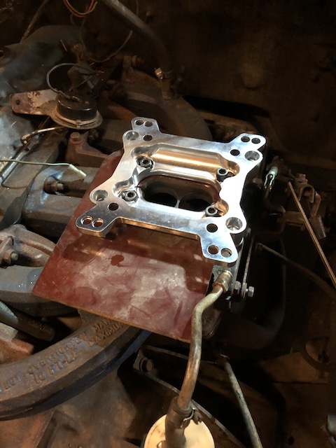

My adapter and gasket stack goes, from bottom to top,
1- intake
2- thick BBD gasket
3- phenolic heat shield specific to the BBD bolt pattern
4- gasket with the elongated bolt holes for the small and large 2bbl bolt patterns, but WITHOUT the holes for the small four barrel mounting pattern
5- two to four-barrel carb adapter with the two-barrel side down
6- four barrel squarebore carb gasket

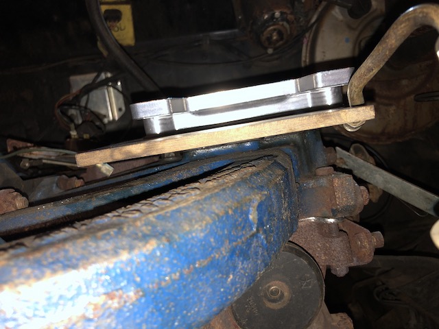

PostPosted: Tue Jan 12, 2021 2:49 pm
Posts: 13431
Complete stack
