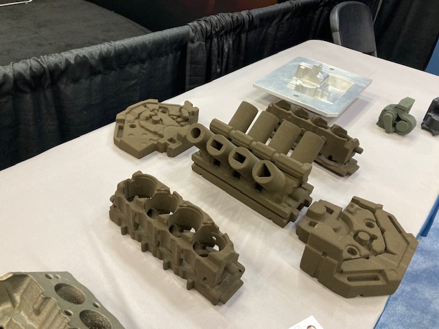

The other photo is the core set needed to cast a V8 cylinder block: front and rear cores, left and right water jacket cores, the body core. There would also be an upper core to make the lifter chamber and a lower core to make the oil pan rail.
For those not familiar with foundry casting processes, the cores are solid shapes that the molten metal flows around. The cores then break down and become the hollow areas inside a casting and the detailed surfaces that make up the outside of a casting.

Correct, the bulk of developmental costs goes to the creating of the 3D models with software like Solidworks or Inventor. My Soludworks package back in about 2005 cost over $20K. But its capabilities allow you to create full working models with unlimited parts and components as well as doing flow simulations to create the absolute best flowing ports, for instance and chamber shapes all in conjunction the first time around. So you don't have to do costly redesign time a second time. 3D printing has more disadvantages than advantages compared to CNC milling, I've had a large format 3D printer myself. Bottom line is its expensive regardless of the method you use to get the end result.
