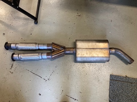

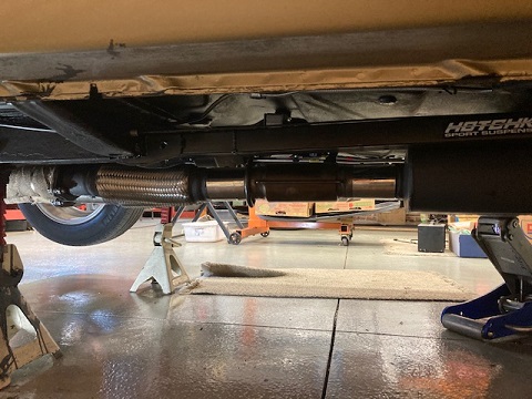

Getting the slant motor that I call the HiNA going, it starts and runs but the AF meter shows full lean and the sparkplugs show rich.
I was thinking that I had an exhaust leak that was fooling the AF sensor-meter and as I had the sensor in one of the Hooker Long Tube collectors, it was only seeing three of the six cylinders, figured this was the time to build a good exhaust system that addressed all the issues.
See photos.
I added woven flex pipes to allow the motor and the exhaust to move independently. This will allow maintaining the sealing of the headers to the cylinder head and add to the working life of all the exhaust seals.
Also moved the AF sensor down stream to the Y collector to allow the sensor to see both exhaust streams.
Brought the exhaust exit out just in front of the driver side rear tire, a tribute to what my Dad did on his vehicles and the AAR Cuda's

Yep, that is classic exhaust leak behavior for the AFR sensor. Hope that new exhaust works for you.

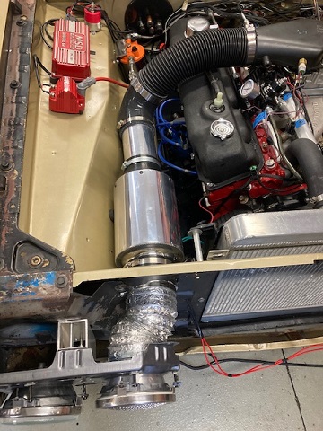

Today finished the cold air intake.
I have gone through several cold and hot starts on the new engine and have started doing the MS3 tuning process. Its all still good.
The motor fires good, no leaks. The AF - VE responses to setting changes are predictable.

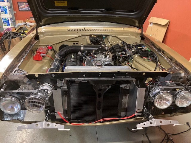

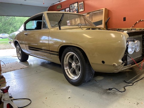

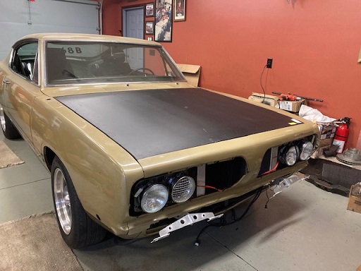

Mounted the GlasTek hood. Used a set of low tension springs from a FABO seller. The springs are a perfect fit to the weight of the hood. I am pleased with how well this has gone. I have a hood pin set and will install those after the final panel alignment.
https://www.forabodiesonly.com/mopar/th ... 1973177598

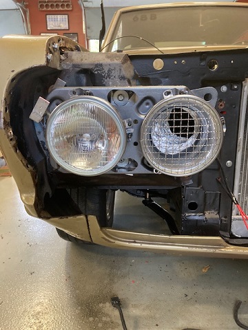

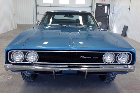

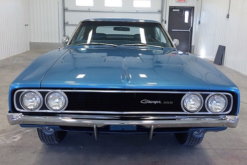

I have also fine tuned the revised front end look and functional alignment. I am going after the 69 Charger 500 flush head light appearance. I will retain the split grill of the 2nd generation Barracuda, with one of my goals being that the changes allow the OE grills to be re installed

I see the look that you're going for, with the split grill it looks like maybe a 3/4 scale version of my kid's 72 fury with the hideaway headlite doors open
Now if y could engineer in the hideaways that would be something......... Just an idea.
Oh yeah the 68/9 chargers (other than the "500"s) had em too
