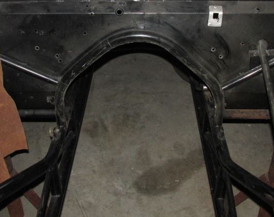

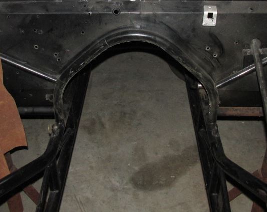

Author:  hyper_pak [ Thu Apr 30, 2020 6:39 pm ]
Got the steel mid plate cut out today.
Tomorrow I start notching the tube to move the engine back.
Not sure why Greg has so much weight hiding all around his car.

Author:  hyper_pak [ Fri May 01, 2020 6:16 pm ]
After I cut the chebbie mid plate out, notched the mid plate tube, it went together.
I still have a ton to do, but good clearance on the dampner, mid plate goes between the frame rails and engine sits good.
It was a good day.

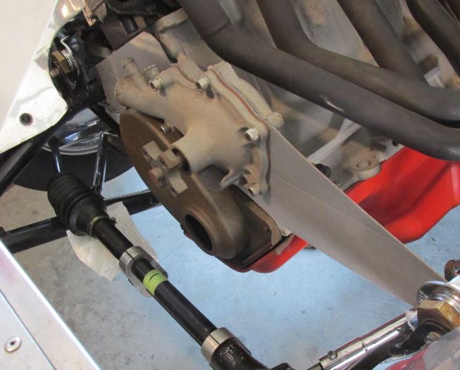

Author:  hyper_pak [ Fri May 08, 2020 7:58 pm ]
Making the engine mount plate. Found a source for 6061 aluminum. Started making the template for the waterpump, timing cover and frame tabs.

Author:  hyper_pak [ Thu May 14, 2020 10:51 am ]
Template 3, I think this will work. I will see about some lightning holes after it's going together and everything is mounted.
