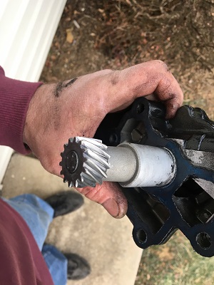

I am sorry I don't have good news on the oil pump gear. As I mentioned over in my truck thread in the Virtual Dragstrip section, I had a whine that I was attributing to the chain guide I installed in the timing cover. However after getting the oil pump out and looking at the gear, I believe the noise I hear is the oil pump gear. Or at least that is a possability. Here are the pictures of the oil pump gear after @ 1 hr 40 min run time. Gear pattern is wide across the gear face but it has already started cutting into the gear and I would suspect the cam as well. I will try and get Ryan's snake camera and see if we can look at the cam gear a little better.
I hope Doug sees this and chimes in on what he thinks, and what I should do next. I would guess reassemble evertything and run it for a while and pull it again. Maybe 500 miles or so? I did cut open the oil filter and found nothing inside to indicate my chain guide was a culprit.

Hmmm. I still haven't got mine installed yet, due to life and other things, but I still am hoping to get it installed soon. Did you do any kind of lapping or use assembly lube when you installed it?
Can you post a more high-resolution and larger photo? It looks like the pump drive gear is quickly wearing away.
Author:  Rick Covalt [ Sat Dec 26, 2020 3:46 pm ]
Post subject:  Re: 14 Tooth Oil Pump Gear Testing
No lapping but I coated both gears with assembly lube. Yes the gear is wearing
Click this photo. That is as large as it will allow me to upload.

That's alot of wear...

Ooof. I would not put that back. Fingers crossed the new cam is okay.

Yes, I am leaning that way, although I am guessing the cam doesn't look to good either. I hope to hear from Doc. I may be able to get the scope to look at the cam tomorrow. Rick

A lot of wear for the short amount of run time... :(
Do not run that gear any longer, it's going to eventually fail.
The good news is that the contact pattern seems well centered.
The pressure readings are lower then I like to see but this is the smallest impeller pump. (5/8)
I am wondering about the whine sound... I did not hear that with the one I tested. :?
We need to re-look at the gear tooth geometry.

Are you able to swap a gear if I send you a 13T factory one?
Re-running the test with a factory 13T gear on the same pump will give us some good info. on the pressure difference that 1 tooth makes.

How much variance is there in the alignment of the gears between camshafts , blocks , and oil pumps?
Just wondering if tolerances went against you this time...................
