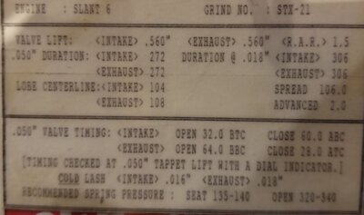

Does anyone have the specs of the STX-21 cam?

272° @ 0.050" is some pretty serious stuff with over 1/2" lift. Effectively Larger than my Ruster cam.
Cool Stuff.
I am guessing it's a flat tappett, not a roller Lobe/ Lifter, correct?

I've got a couple Mike cams that are over .600" net.
Author:  Greg Ondayko [ Fri Feb 09, 2024 4:28 pm ]
I am not certain that the lift is the biggest player.
It of course helps but I think the lobe profile/rate and lobe timing to the position of the piston in the cylinder have a large impact on things too.
Author:  Rick Covalt [ Fri Feb 09, 2024 4:42 pm ]
Mine in the car now is 270 degree @ .050 and .570 lift. Most lift above .500 is just a "valve spring test" :D :D
Author:  slantzilla [ Fri Feb 09, 2024 9:39 pm ]
Anything under .550" is a lawn mower cam

THERE IS MY ZILLA!!!!!!!!!
