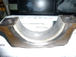

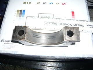

its 4 sure the trust bering check it out:

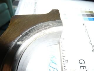

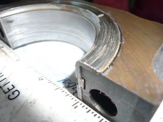

That bearing doesn't look eaten up enough to cause 1/4" of crank end-play. I'd bet the thrust faces of the crank have been eaten up.

you would think the bearing would be sacraficed before the crank,or the two together. was there any signs of someone has replaced the bearing before?
PostPosted: Wed Aug 13, 2008 1:56 pm
I've only taken apart a couple of engines with thrust bearing failure, but both had eaten into the crank. We have enough spares floating around here we can get Midi fixed up pretty easily.

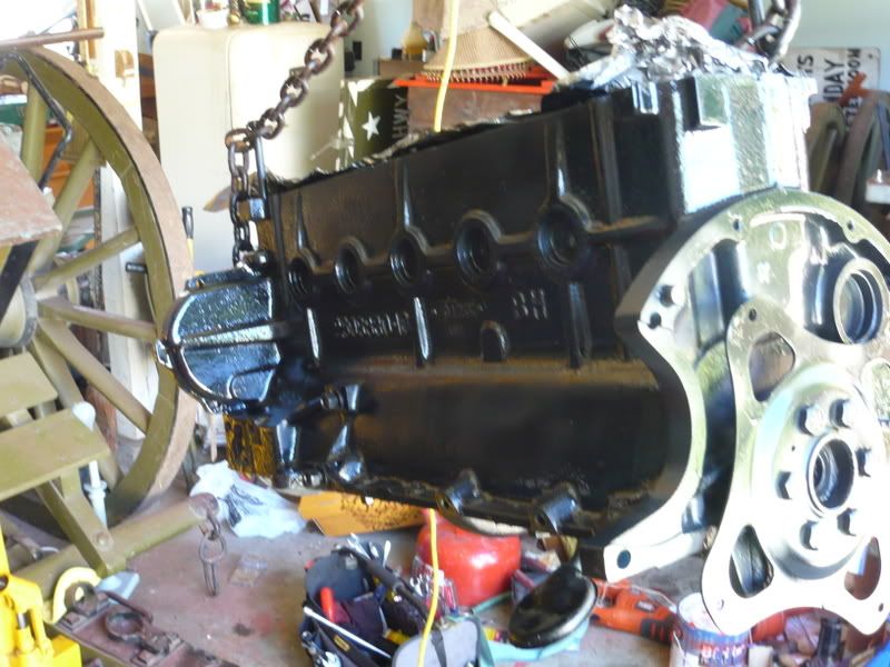

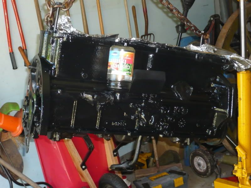

wait till th0r posts on this he was just here, and he can explain what we are doing but it shoudl be running in a week or less! the crank looks fine!
so i busted out the paint. when its in and running i'll bust out the champane!
back n black!

black block and head, black k-member,tortion bars,steering shaft,lca,uca & sway bar. black vht exhaust manifold
orange water pump,valve cover,timing chain cover,pullys,oil pan,2bbl intake.
chrome parts: air cleaner, breather ect., including valve cover when i can afford it.
since my car is a chick (geli) she is now the black widow!
with my halloween engine! a true one of a kind.

The pieces of metal that MiDi found floating in his oil pan, were from the thrust bearing. I mentioned to Cj that there was close to 1/4" of play, but it was only an estimation. Upon further inspection, and an easier view of the internals, its not 1/4", but without a dial indicator I can't say for exactly. The bearing itself is torn up pretty good.
Seems like that happens mostly when there is lack of oil, and extreme heat. According to MiDi, his car hasn't over heated too many times, but all it takes is once. I think if we just measure everything, and throw some bearings at it, we should be in business. The rest of the engine looks good.
