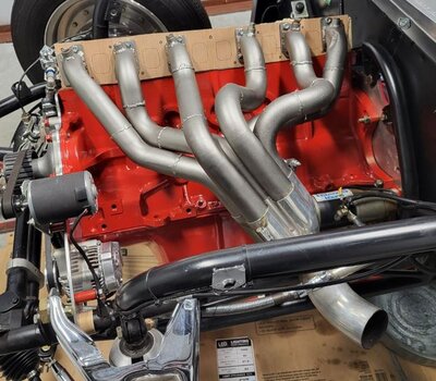

Author:  hyper_pak [ Tue Apr 02, 2024 5:36 pm ]
Waiting on the head I threw these in to see if they might fit.
Close.
Author:  Greg Ondayko [ Wed Apr 03, 2024 6:26 am ]
Those look like some skookum as frig big headers. Did you just build them or did they come from another project?
Author:  hyper_pak [ Wed Apr 03, 2024 7:15 am ]
They are from another project.
They would need quite a few modifications to work in my Colt.
