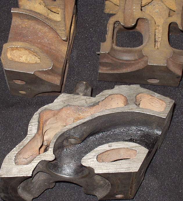

Opening-up the "port pocket" area just under the valve seat is the place where you will get the most gain for the least amount of work. There is a sharp edge where the valve seat machining stops and the "as cast" port walls start, this sharp edge needs to be removed.
If you plan to use oversize valves, "rough-in" the new valve seat location first and then grind-out any extra metal to the inside of the new seat. Grind straight down from the inner seat edge, do not cut metal underneath the seat, that metal will be needed for later valve seat grinding and helps heat transfer.

Feel around on the short side for casting bumps and spikes. Seems like there is plenty of material to allow for blending there. It's a little tough to see and get at with the grinder, but a common spot to find casting imperfections on the heads I've seen. Removing the valve boss, or as much as possible has been suggested, but it's in the hardest place to reach.
It's a pretty labor intensive job porting a head with just hand tools. I can see why a milling machine would work a good bit faster.

Thanks for the pix. To Doc: I've been wandering tthru your images section on your website. I found lots of answers w/o asking (that's cool :D ) but I may need to bother you with this 2 (or 3) q's
